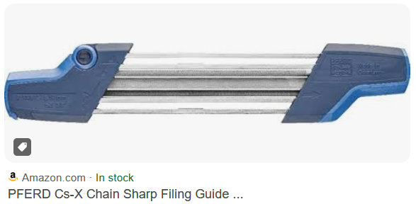

May I ask what you use for a file guide? Years ago I was at a hardwood log bucking seminar and heard several logging contractors talking about sharpening. This is what they recommended... IMG_20250217_181855413.jpg
I use it every few sharpenings, but in the woods have the old clip on file guide.

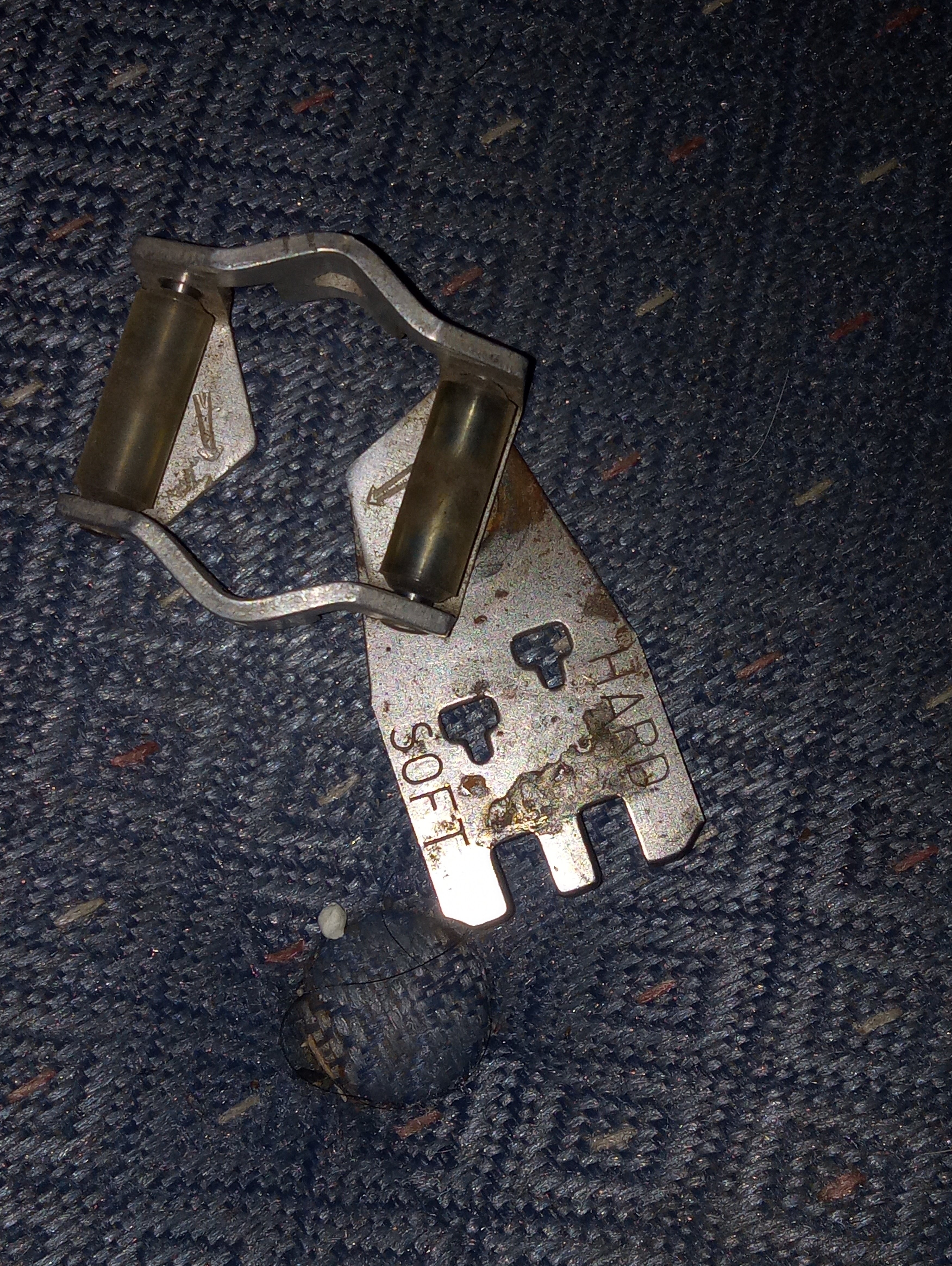

The roller one used to be my favorite file guide.

May I ask what you use for a file guide? Years ago I was at a hardwood log bucking seminar and heard several logging contractors talking about sharpening. This is what they recommended...View attachment 2707787
I started out using the clip on guide. It worked well enough, particularly when used in conjunction with a progressive depth gauge tool. I still keep it around nd use it occasionally.

Some years ago, I switched to the roller guide like what you pictured. Works well, and I can see what is going on as I sharpen. It's handy that it has a progressive depth gauge built in.
