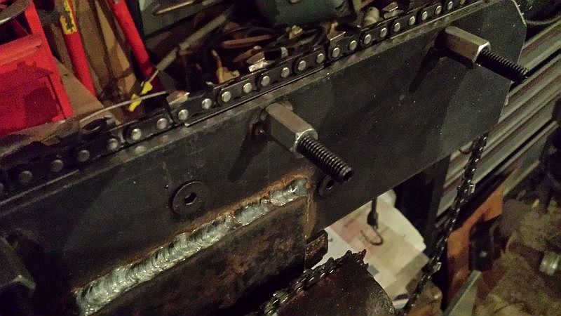

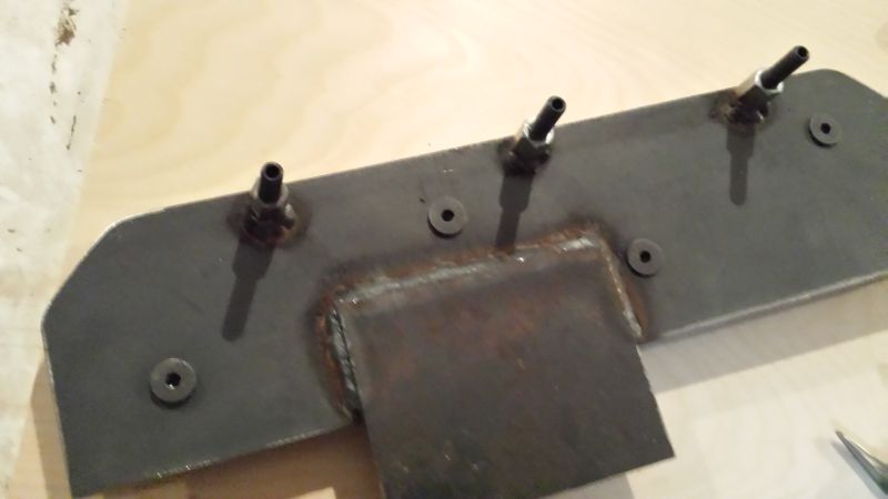

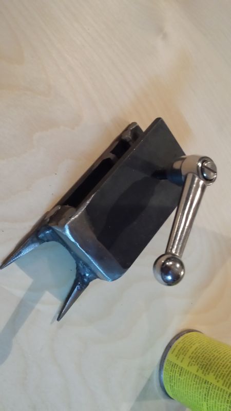

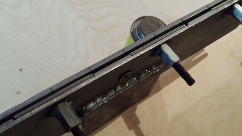

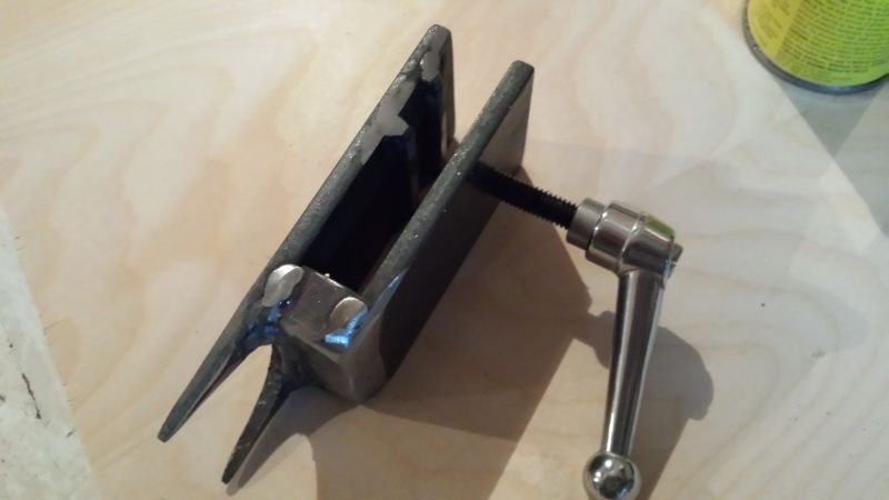

I made these two jigs for sharpening the saw chain.
the first 3 pics is a clamp to hold the spare chain. the chain itself gets clamped in the jig. the jig itself gets mounted into the bench vice.
the last 2 pics are for a stump vice that I made, for touching up the chain mounted on the saw. (parked on a convenient stump or log)
I didn't want the hassle of having to mount the spare chain into the saw for filing, this jig does work nicely. there are 3 moveable insets which clamp onto the drive tangs of the saw. loosen them up and slide the chain forward, and tighten them up.
I am surprised that I could not find a store bought jig for this purpose anywhere. for the loose spare chain that is.

I don't quite understand how a c clamp will anchor a loose-spare chain. the jig I was primarily interested in was to prevent having to swap chains on the saw just to sharpen it. this way I can touch up the one on the saw but also do any loose spares that need it.

Nice jig! Suggestion: replace the bolts with 'toggle clamps' Much faster than loosening/tightening bolts.
MSI 12130 Vertical Quick-Release Toggle Clamps - Amazon.com
I have thought of (but never built) similar jigs and those toggles are the greatest. I used lots of them when I ran the drill presses in a fertilizer equipment manufacturing shop. They come in all types of configurations nd I could always find one where the handle moved in the right way for a jig.

thanks for that tip. so far these 3 clamp locations need the allen wrench to work. actually a 1/4 turn is sufficient, so I had thought about welding an allen wrench to the screws.
I can see where toggle bolts would be nicer, if I can locate the perfect configuration.
