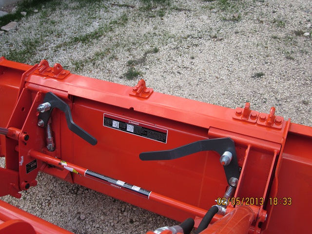

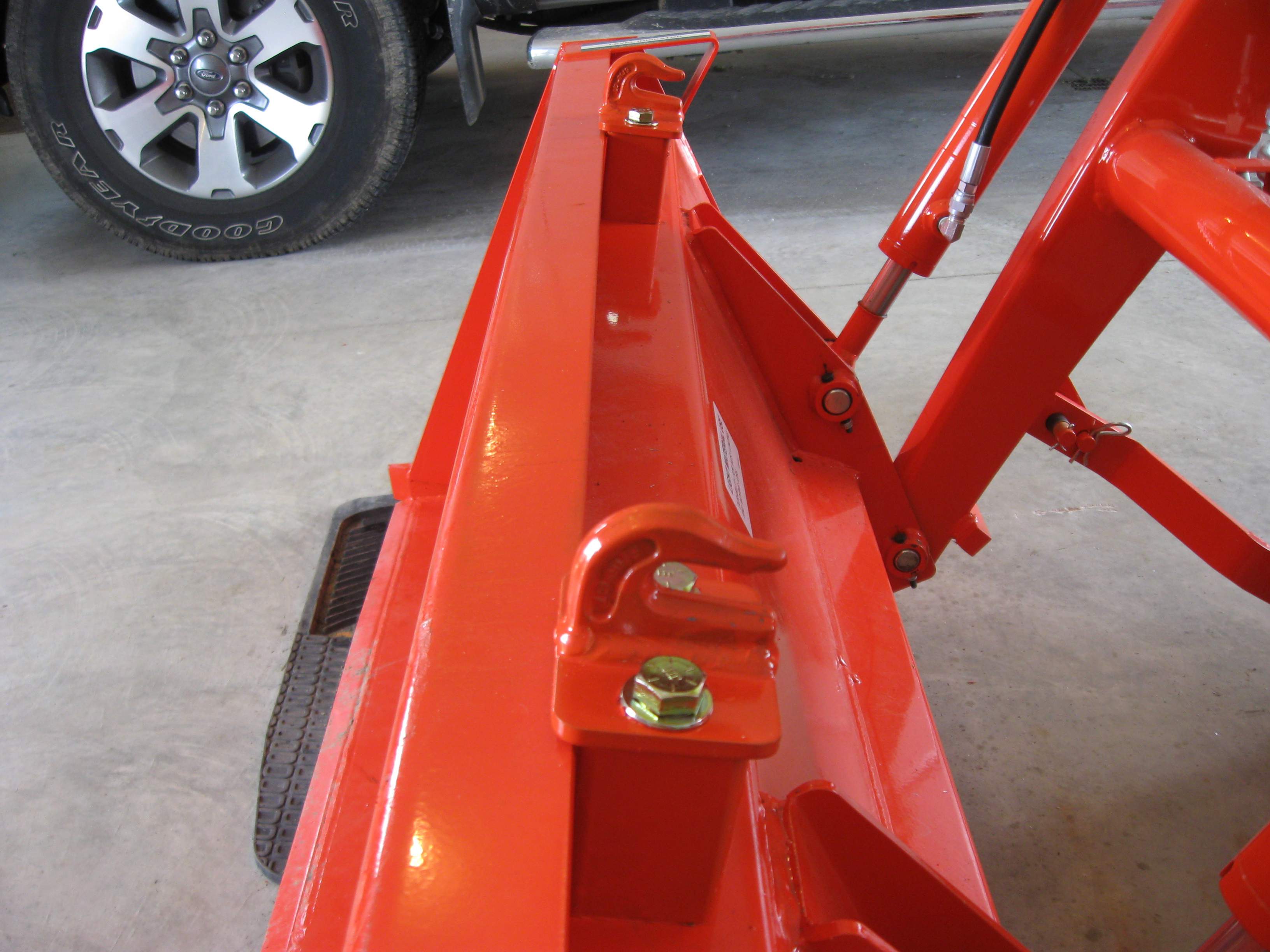

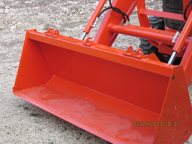

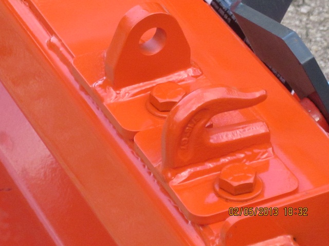

Here's what I did I'm very happy with it. Feel free to use the idea Ken.
/ Chain hooks on loader #23
I have Ken's 5/16" Bolt On Grab Hooks on the bucket and cross-drawbar of my Kubota B3300SU. They have not moved even 1/10,000's in four years.
Buy new drills, per Ken's instructions, and installation is simple.

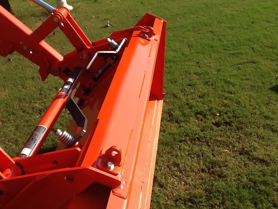

I was looking at my quick attach bucket on the la525 and the plate that is welded across the top is not even with the front of bucket. It appears that the bolt on hook will not sit flush at front of bucket. It would have to be moved back a bit. Then the under side looks like it would be drilled right through the weld seam?? Anyone else tackle this issue on this loader?
/ Chain hooks on loader #33
This has not been an issue for MANY customers.

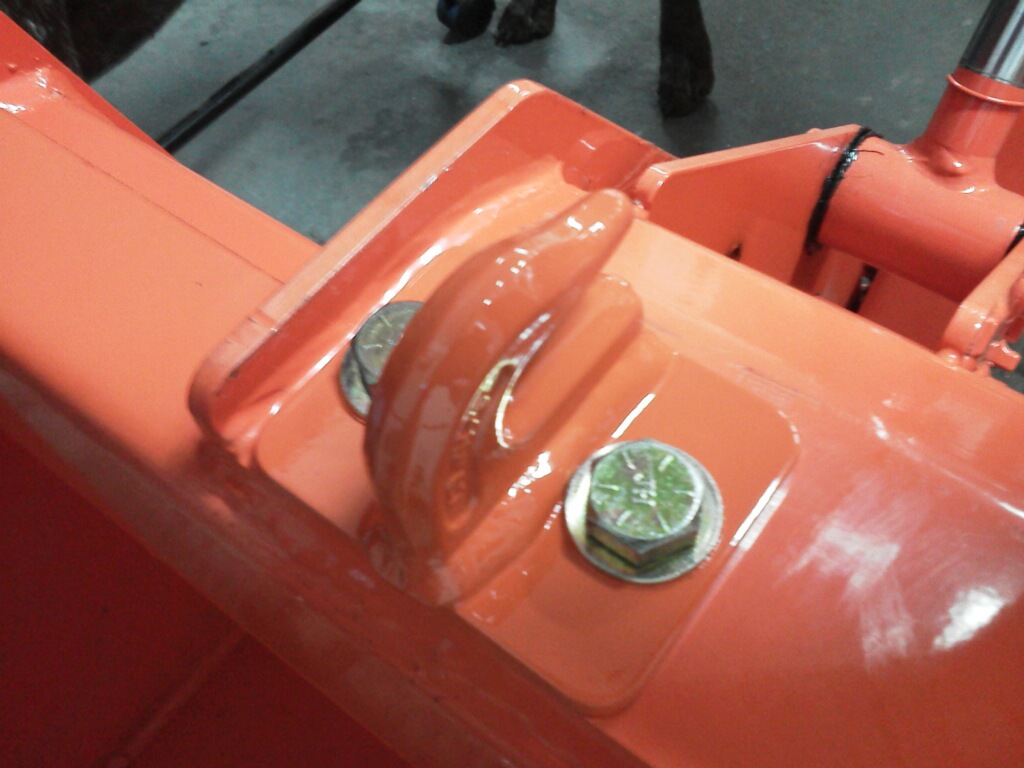

/ Chain hooks on loader #39
I have the same loader as you. The bolt ons from Kenny worked perfectly. ImageUploadedByTapatalk1452371521.294810.jpg
I also added a Clevis inside the bucket center for a 1/2 inch shackle but am planning on adding another one on the rear outside of the bucket sandwiching the bucket body.
Here's a tip. When you try to get the nut and washers inside the SSQA mount, stack them all up on an Allen wrench with a couple of fingers holding it up through the bolt hole. Then push the bolt down through the washers and start it in the nut which you are holding up with your fingertips. Switch to a wrench to hold it and tighten down.
