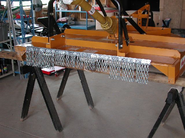

The finished product..
Just finished the guards off. Ended up loctiting everything, including the already finished rear. :) Also decided to double up the nuts on the bolts that hold the angle iron to the deck in addition. So here's 4 pictures in case anyone is curious.. The front came out even better, I think.
This picture is the front, overall.

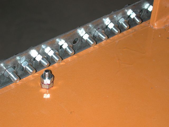

Here's a close up shot of the back side of the guards..

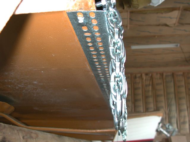

..and finally, a shot from below. I used 1.25x2.25" angle iron so I'd have more room to mount it to the deck.
Now all I need to do is wait a couple weeks so I can brush hog our new land. :)

I have the feeling I'm about to ask a dumb question but I can't figure it out, so.... Why are the middle group of chains shorter on the front guard?
   / Chain Guards #50
Re: The finished product..
<font color=blue>about to ask a dumb question</font color=blue>
Not too dumb./w3tcompact/icons/laugh.gif The first time I made a chain guard, I made'em all the same length, and as they drug over grass and weeds that pushed them back under the deck, the blades shortened'em for me./w3tcompact/icons/shocked.gif/w3tcompact/icons/laugh.gif
