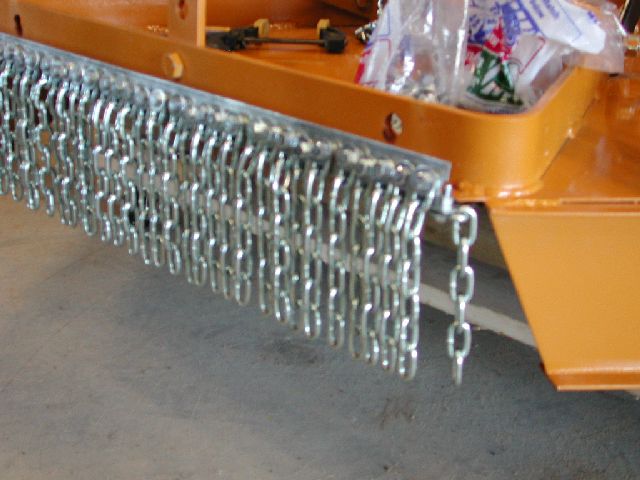

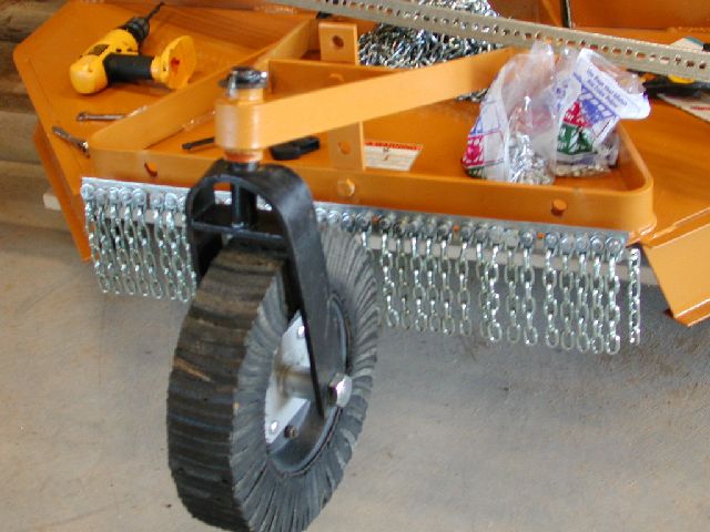

I bought a used KK rotary mower, and have used it only one time so far. Just had to test drive it. I have been following this thread, trying to come up with a quick, cheap and easy way to get a set of chains. One thought I had (see attached file) was to slip short sections of chain onto a piece of 3/8" allthread using nuts or some short pieces of small diameter pipe to keep them spaced. Short sections of pipe have the advantage of slipping them on and not turning nuts forever. Every so often, you could slip an eye bolt on to attach the assembly to the mower deck. This would be fairly easy installation, and would space them away from the blades a bit so they don't "trimmed" if brush pushes them back. Any thoughts?................chim
/ Chain Guards #66
Chim,
Thats exactly what I did and it works fine. My setup involves bolting two pieces of 1/4" x 3" x 8" long flat stock to the sides of my cutter. The flat stock extends about 4" out from the front of the mower. I drilled a 1 3/8" hole in each end and slid a piece of galvanized pipe through to act as a hanger. From this, using exactly as shown in your post, I hung (with 5 eyebolts) a piece of 3/8" threaded rod with chains and spacers. Picked the chains up at the dump, pipe and flat stock I had lying around, spacers (3/8" rubber grommets) I picked up at a local surplus yard for $3 and the eyebolts cost around $4. Total cost $7 plus about 2 hours labor. This was for the front only. Next weekend I hope to attack the backend.
Russ
/ Chain Guards
#67
<font color=blue> slip short sections of chain onto a piece of 3/8" allthread</font color=blue>
Believe it or not that's exactly what I'm working on at this very moment! The only difference is that I plan to weld small brackets on the bush hog to hold the allthread. I will post a photo when it is done.
