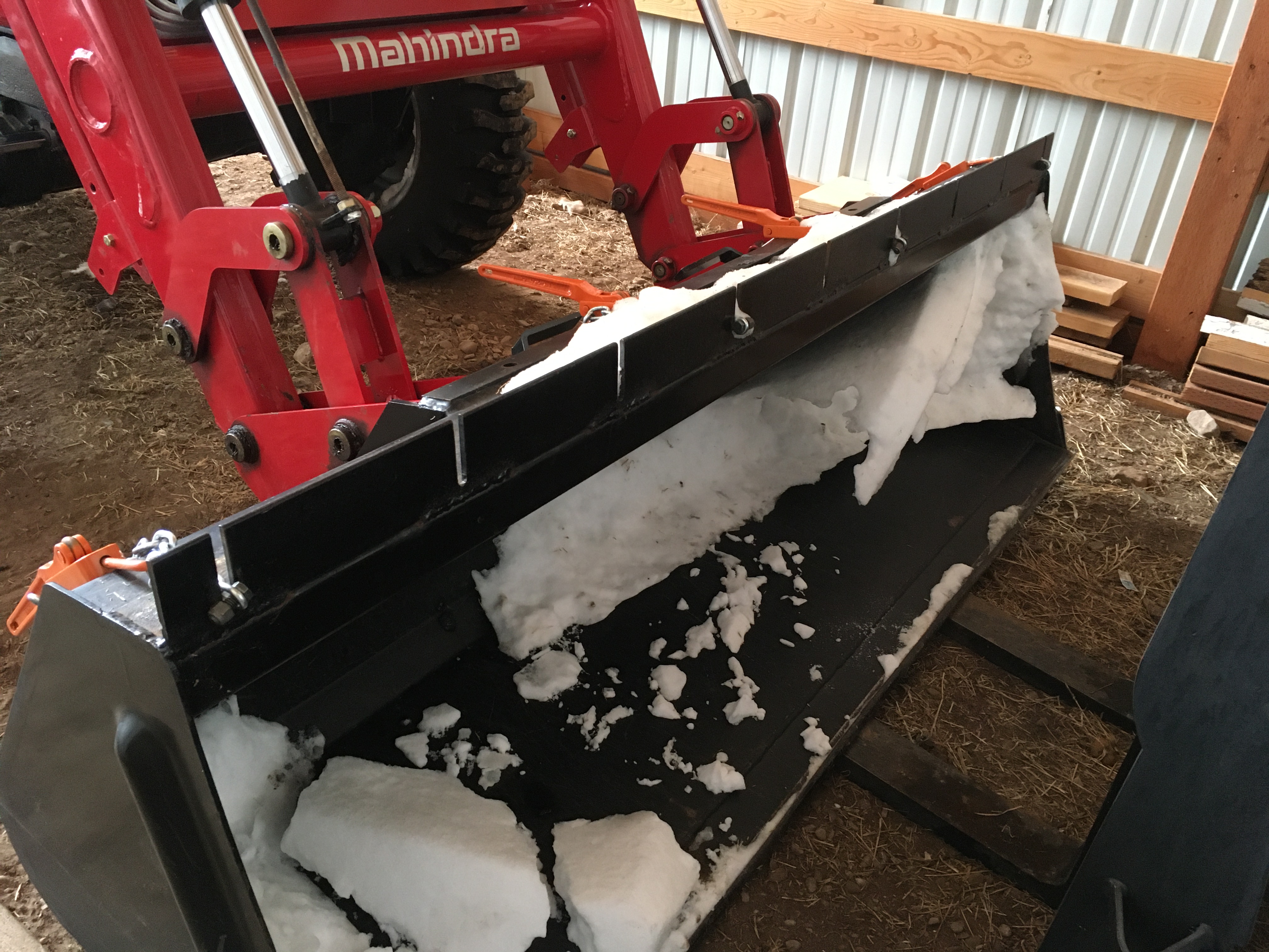

I don't seem to share the enthusiasm some have for hooks, bolt on or weld on. I prefer the slotted angle iron so chains will hook into it from the front or back of the bucket and it adds strength to the top of the bucket. Mine is welded on but I suppose a person could bolt it on also.

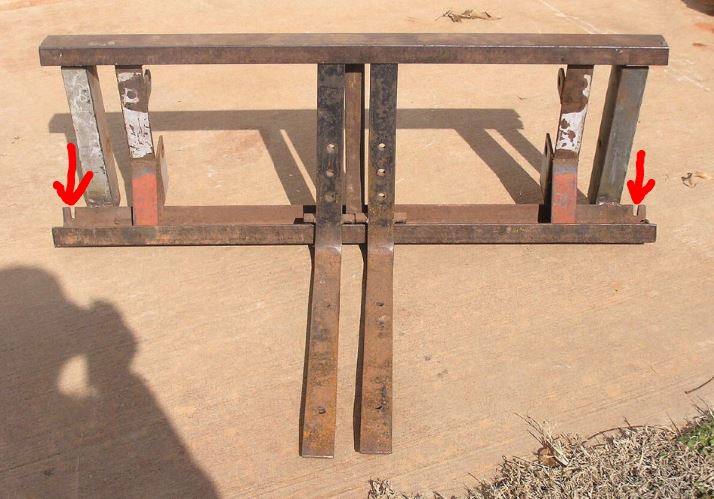

And another vote for chain slots blue TU.gif.
Chain slots on the fork frame:

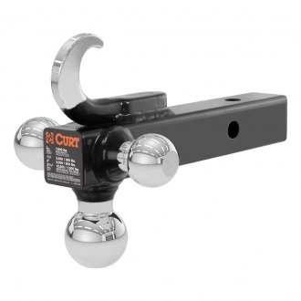

Some hooks are better for straps, rope or cable. Lots of hitch attachments.

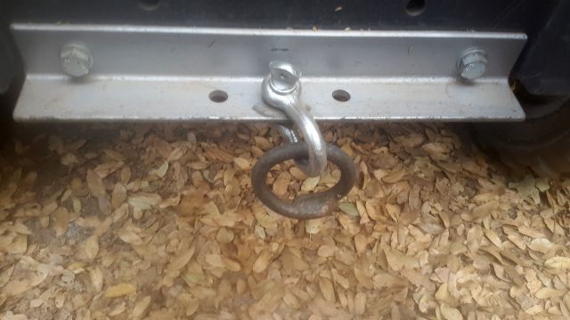

One could always make a simple ring with a "T" bracket on it to drop in slot if you needed a loop....
I was frustrated that I wanted to have a couple of rings for running chain through and most of the hardware store loops/links just did no fit the bill.... So I made them, 1/2 stock wrapped around 3 inch O.D. pipe, overlapped and welded... Angle iron in picture is bolted to front crossmember of tractor frame .... Also have same shackle and ring arrangement on rear chassis draw bar... Both were put in place so I don't have to pull on FEL or 3PH for some serious yanking...
Had thought of putting receiver hitch on angle instead of shackle because there is all sorts of "tools" that plug in to receivers today...
You adapted to fit your needs not just always by what you can buy....

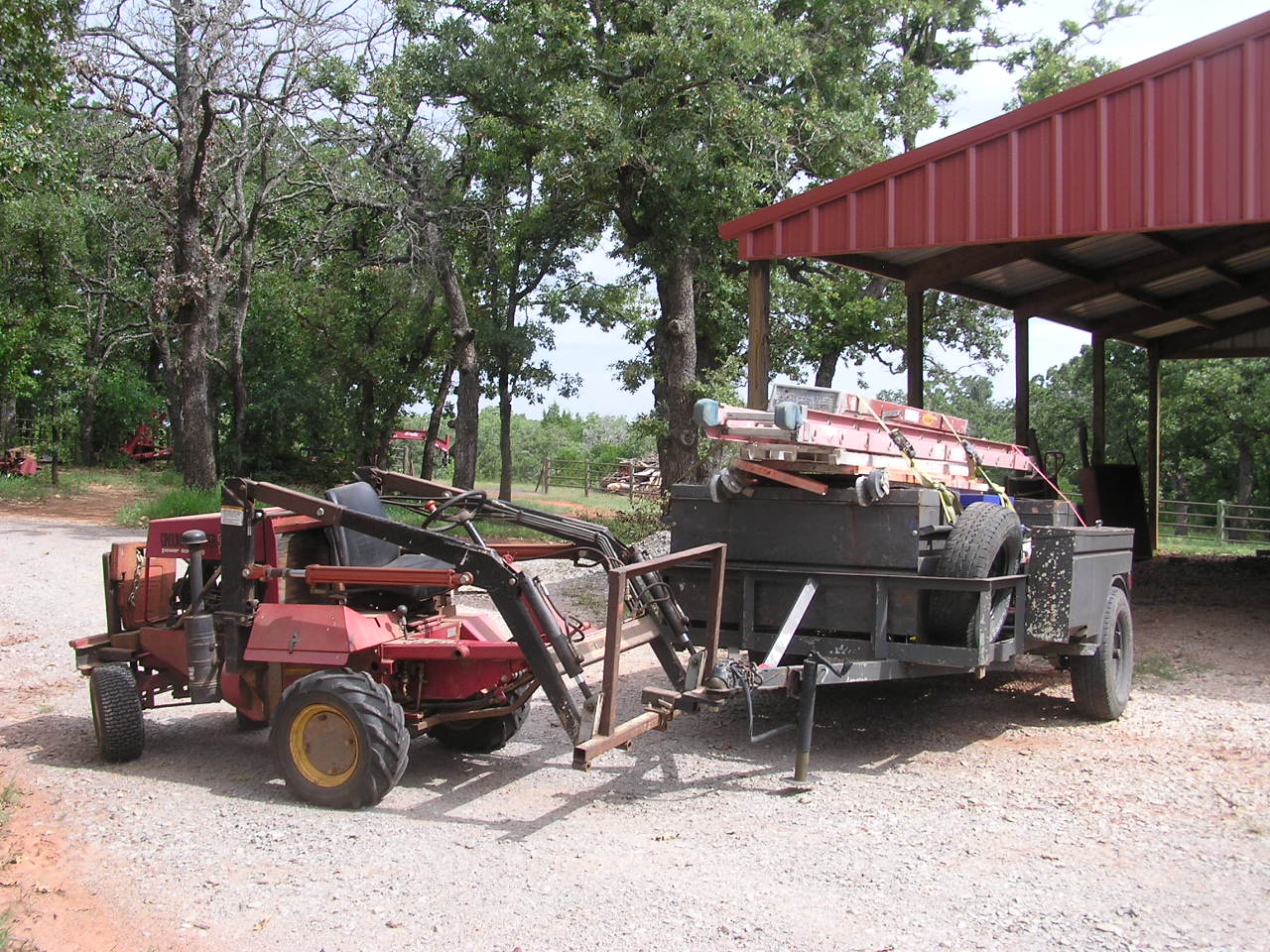

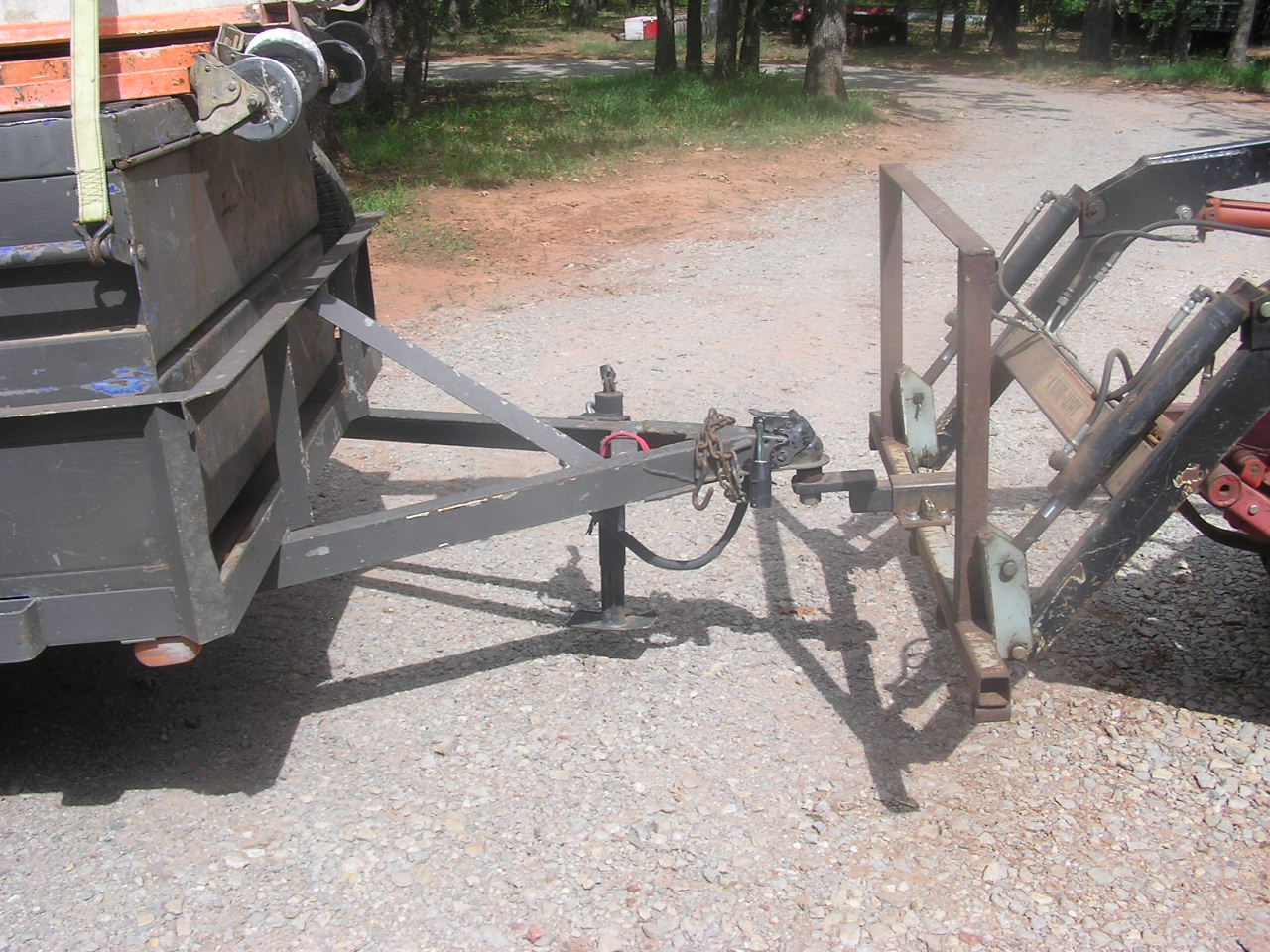

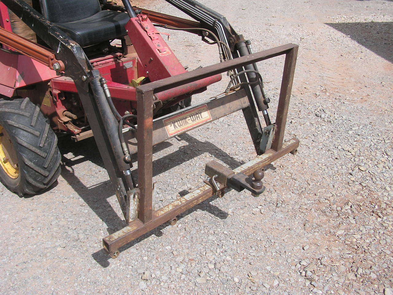

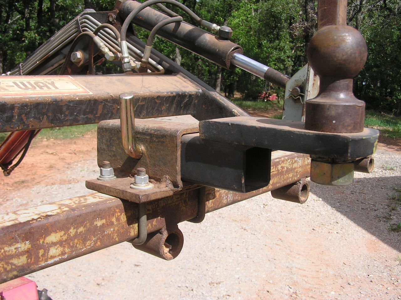

Yep, I put a receiver hitch on the brush fork frame:
