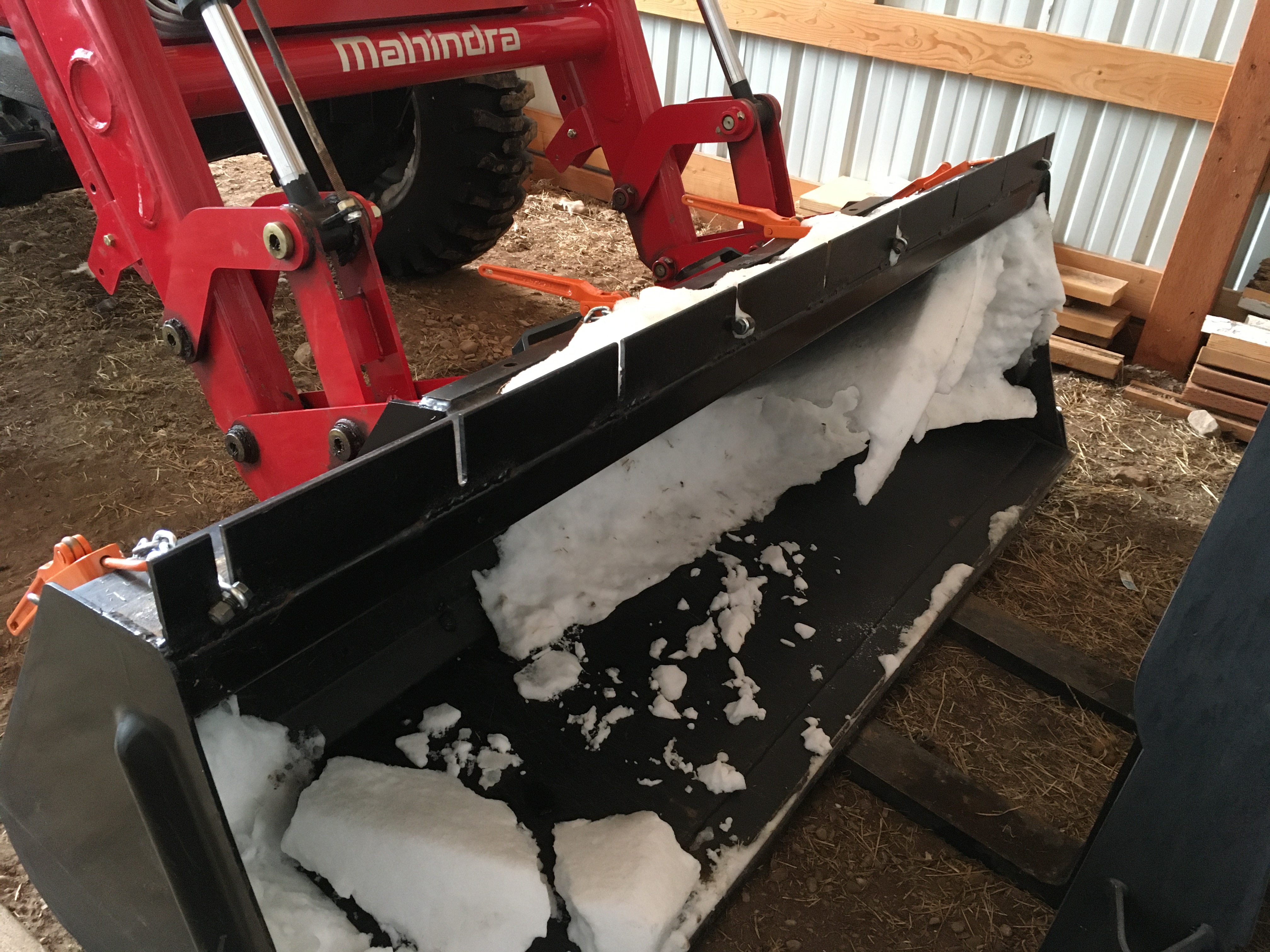

I don't seem to share the enthusiasm some have for hooks, bolt on or weld on. I prefer the slotted angle iron so chains will hook into it from the front or back of the bucket and it adds strength to the top of the bucket. Mine is welded on but I suppose a person could bolt it on also.

Another positive for slots...

And another vote for chain slots blue TU.gif.

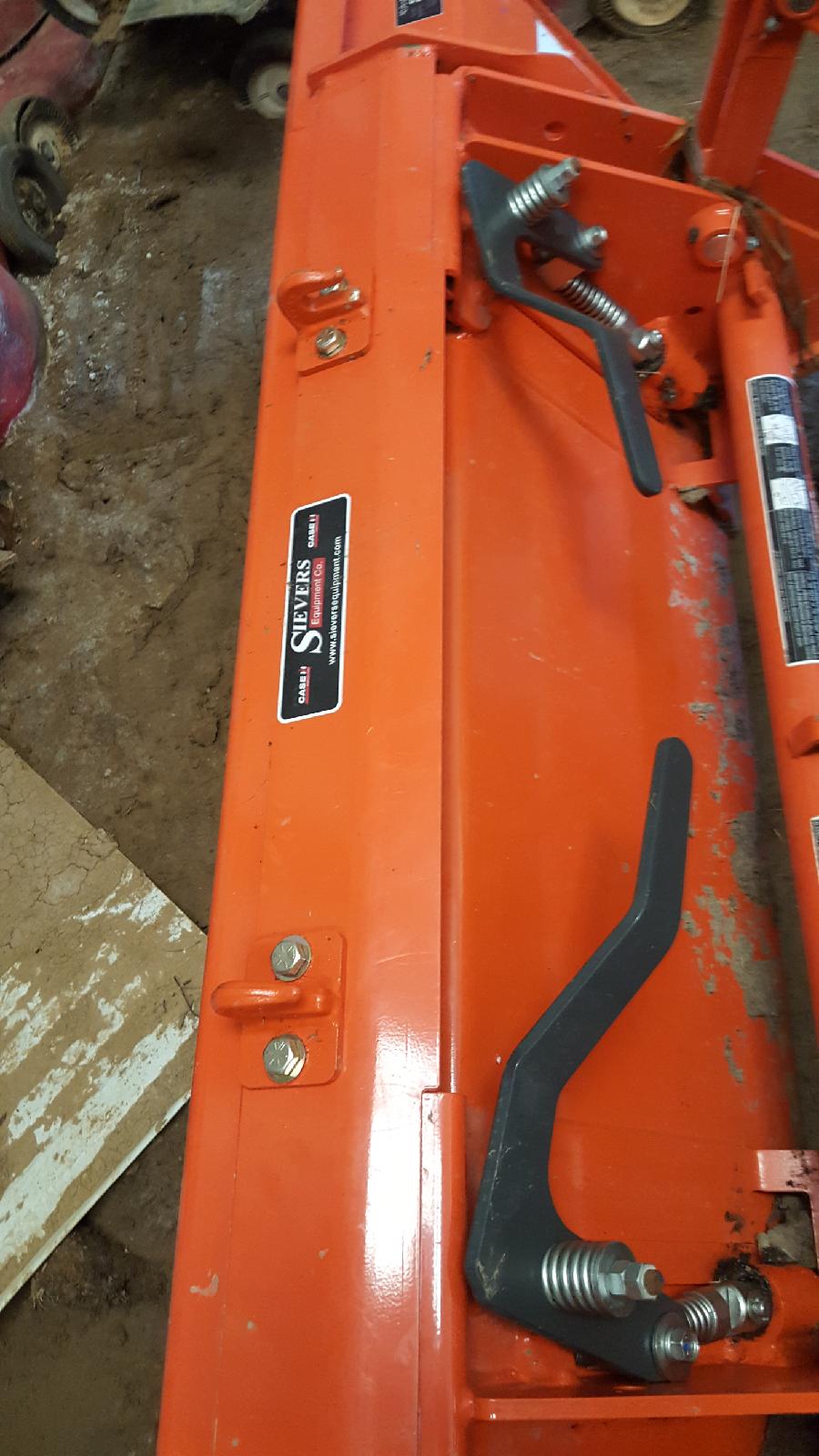

I got Ken's hook/clevis combo with the backing plate. Ropes, chains, straps all work fine.
