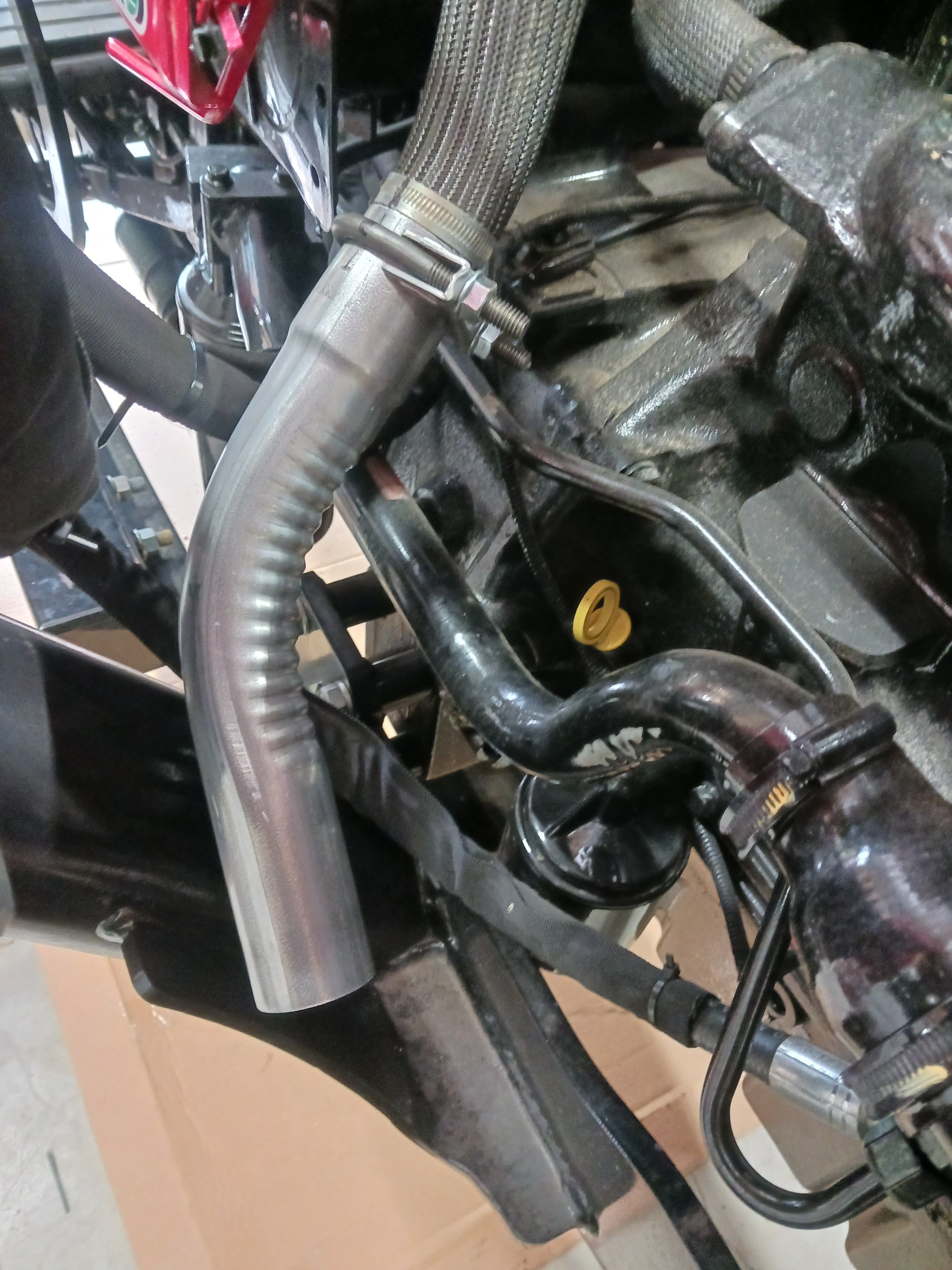

Rerouted the exhaust with a 17/8 45 degree elbow, moved the light switch to where I didn't turn on the signal lights every time I got on or off the tractor, added a rubber handle grip to the parking brake handle. The only thing I lack is drilling an extra 1 3/16 hole in the draw bar to give another option on the length. I forgot to mention add chain hooks to the bucket.

I like the chain hook installation. Not familiar with the 4540 so can't figure out where the exhaust is exiting.....

The chain hooks install consist of a 1/4 inch plate on the top and the bottom of the bucket lip. The lip seems to be 2 plates 3/16 with an 1 1/2 space between them. The eye bolt is a 1/2 inch with a 2200lb rating. I have a similar set on another tractor and only have broke 1 eye bolt in 15 years. The exhaust originally exited from the right rear of the hood aimed directly at the loader hoses. I routed it forward and down in front of the right rear loader mount. I still get a little bit of fumes at higher RPMs so I may have to fashion something to turn it down towards the ground more.

Thanks for the reply. I have the perspective now to understand the exhaust photo.....
