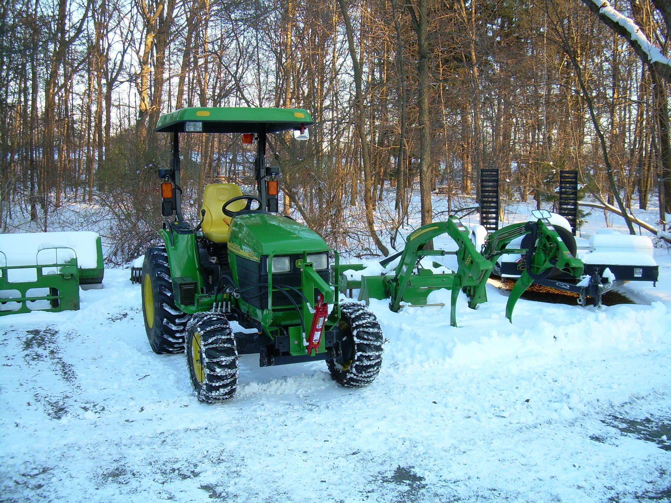

Have chains for all around but have only been running on front for a couple years now, works great, hope I'm not hurting anything.
Pic taken today.
Pic taken today.
It's a crapshoot. Most manufacturers discourage front only chains with good reason. Whether your manufacturer does or not, the potential for catastrophic front drive failure exists, and can happen in a split second of inattention or just plain bad luck.

I bought a good quality set of chains for the front of my 3710 for snow plowing duty about 7 years ago. After using them for about 5 years I had to replace a front wheel bearing...... the bearings wore and the cage was all tore up.
It was a cheap fix because I caught it in time and was able to remove the hub myself. I have now convinced myself that the strain of loading all the tractor weight plus the "work" on the front drive train is not something I will do to my machine any more. I went to rear chains and am much happier with both the result and the wear and tear on my tractor.
And I have to admit that a few years ago some folks told me I would come to that conclusion and I did not believe them....
I believe them now.

Looks like you still have them on the front in one of the other threads or are they just old picture.Didnt see any on the back maybe i have the wrong tractor.
Old picture. I didn't use them last year and do not intend to put them on the tractor this year....... The big tractor has front wheels the same size as the rear wheels on the Kubota. So one set of chains serves both tractors, for now.
The drive I plow is 1/2 mile, paved with a 300 foot incline over the distance. I agree that infrequent use of the chains, especially in deep snow should not cause a problem. The stress comes when the only thing pulling the tractor up the hill is the front wheels and then only when a chain bites in. I have to believe that causes some stress.
Anyway, I am just expressing my experience and opinion...... I am no engineer.
