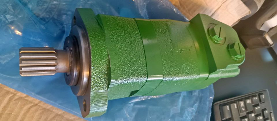

Any ideas? I had the thought of removing the existing pump and putting in a new unit. Just a regular direct drive pump and plumbing it to another spool. Use a spool for chain direction. Any thoughts?
   / Case DH4B Trencher/Backhoe Won't Spin Trenching Chain
#89
Something like this.
   / Case DH4B Trencher/Backhoe Won't Spin Trenching Chain #90
R8
Picture in post 89 looks like a low speed high torque geroler or gerotor style motor. Is this what is on the trencher?
