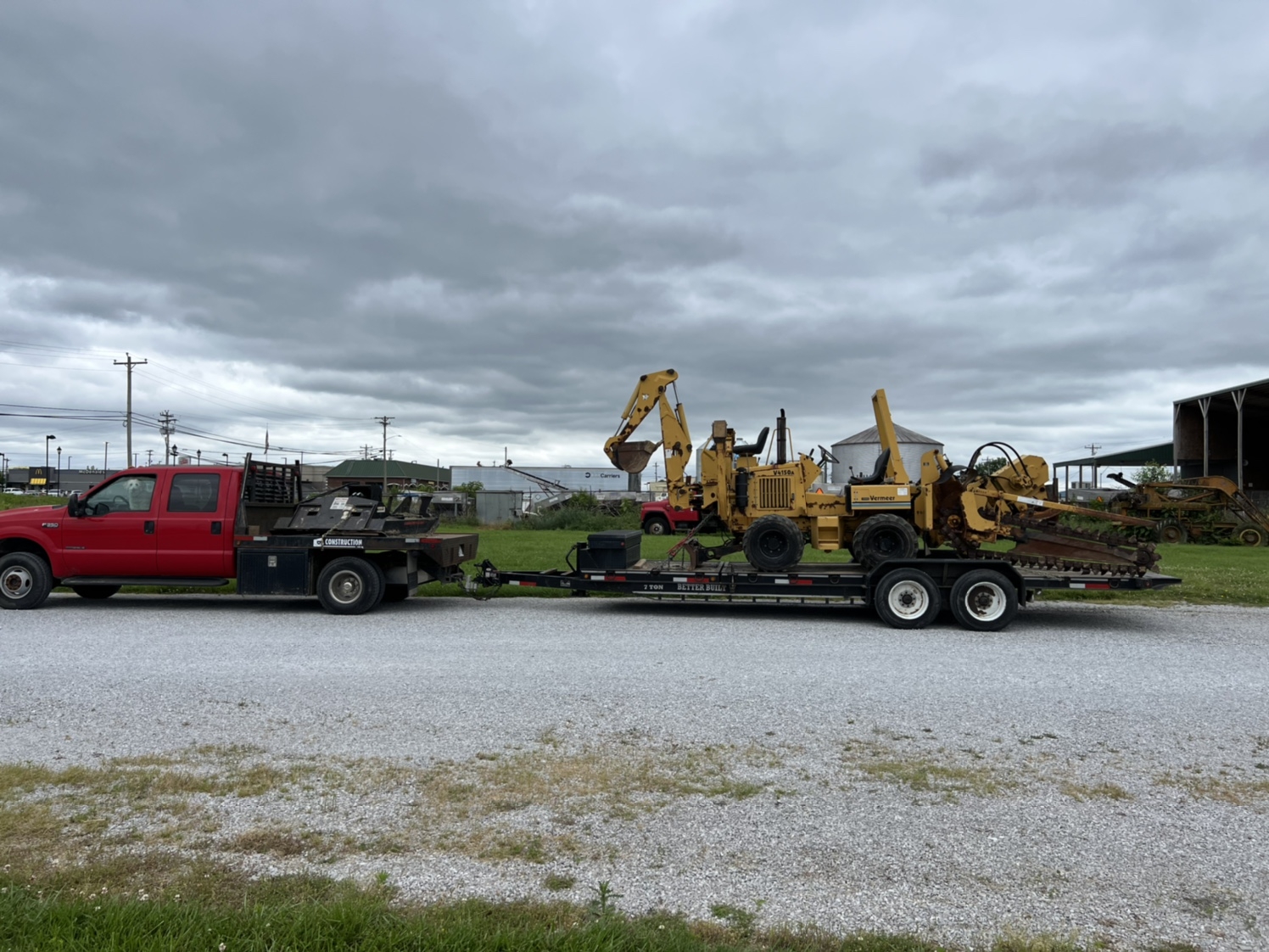

I haven’t read the whole thread but my Vermeer has a diverter valve to switch flow from the digging chain and the plow vibrator. Only one of the 2 can be used. If it was set to the plow vibratory the digging chain can’t move. It also has a diverter valve on the blade. It’s a 6way blade but only has dedicated 4 way function. The other 2 functions share a diverter with something else.
   / Case DH4B Trencher/Backhoe Won't Spin Trenching Chain #124
What vermeer to you have? I have a rt650 plow/trencher.
   / Case DH4B Trencher/Backhoe Won't Spin Trenching Chain #125
V4150.
