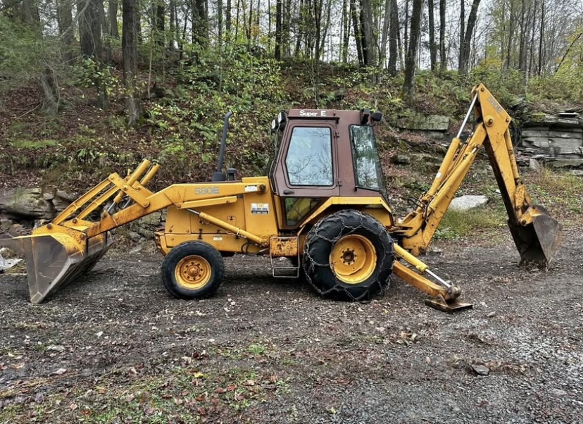

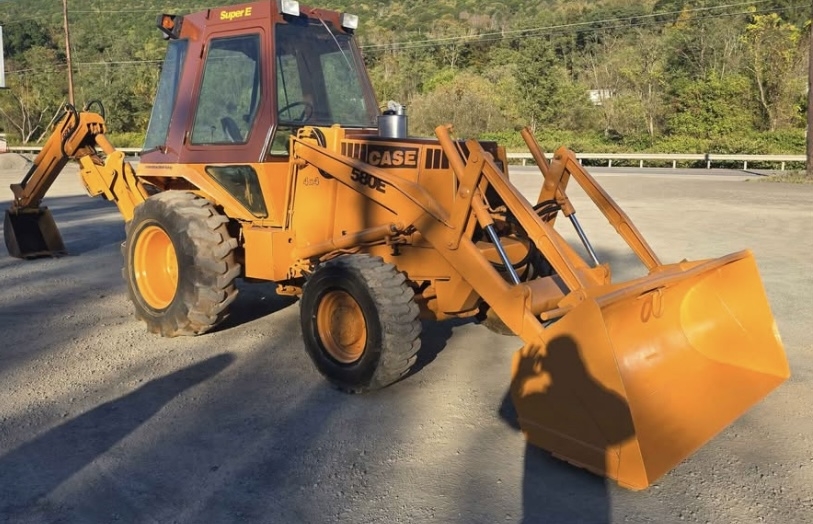

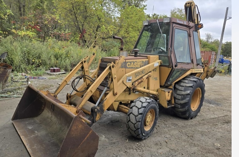

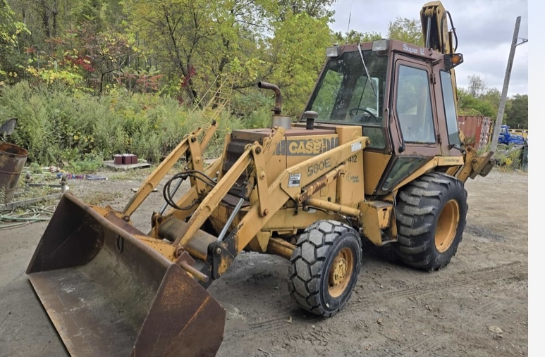

Thanks for the replies I am a mechanic and would be doing any repairs myself.
Do the prices seem reasonable?
Attached is the 2wd and 4WD before and after paint
/ Case 580e options #7
Reasonable anymore is what you are willing to pay. IMO, that’s reasonable for a full size tlb. I would probably do a compression check to see how fresh that motor may be. I’d look very closely at the condition of all the hoses too (for counter offer leverage) I’d also check for slop in the shuttle shifter linkage. Throttle down before using the shuttle. The front end likes to hop a little
