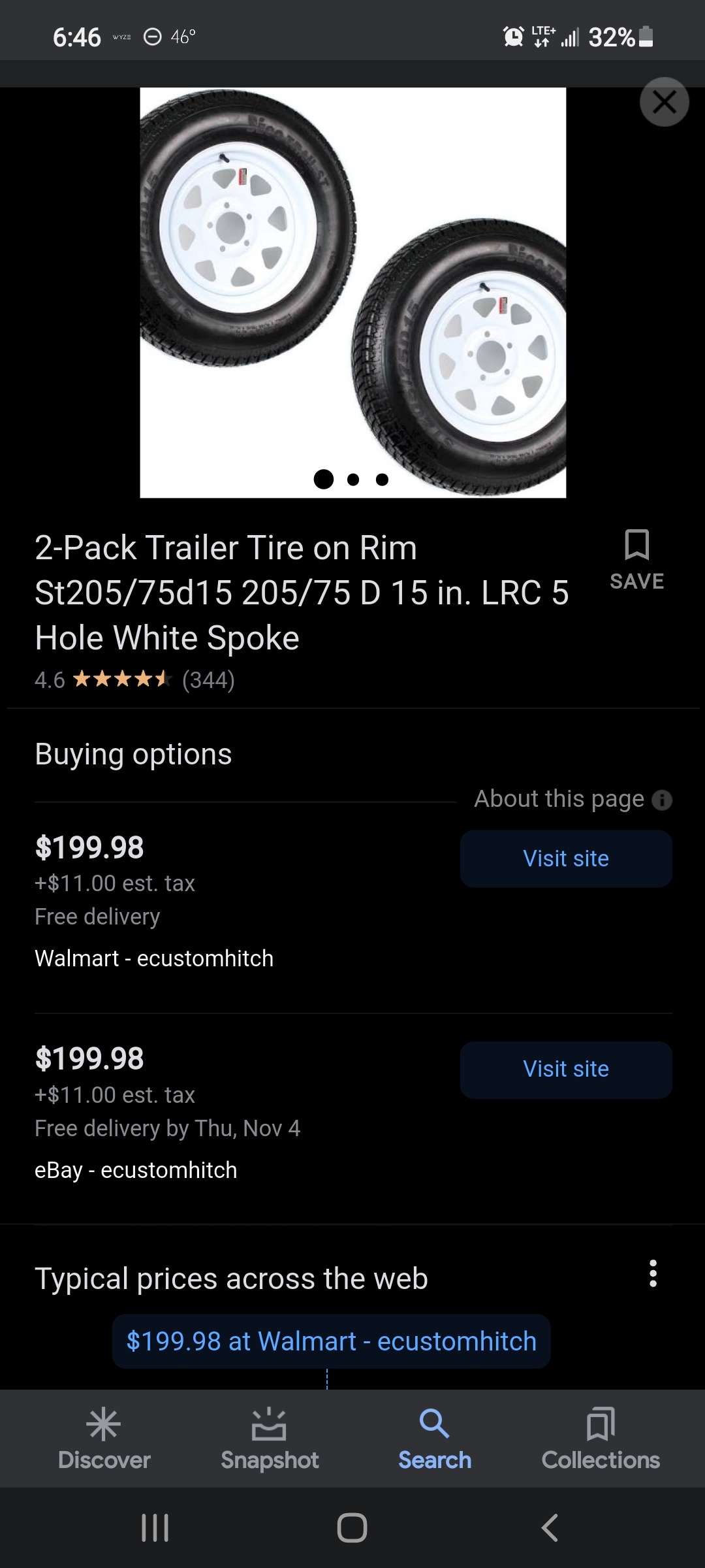

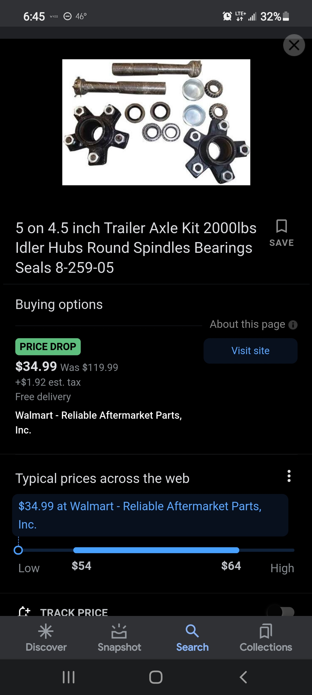

Gladly.
What I did was email "etrailer.com" and this is the response they gave me.
/ Carry On trailer wheels #6
If you have 1" spindles buy this combo. If you have 1-1/16 spindles search 1-1/6 2000lb hubs set
