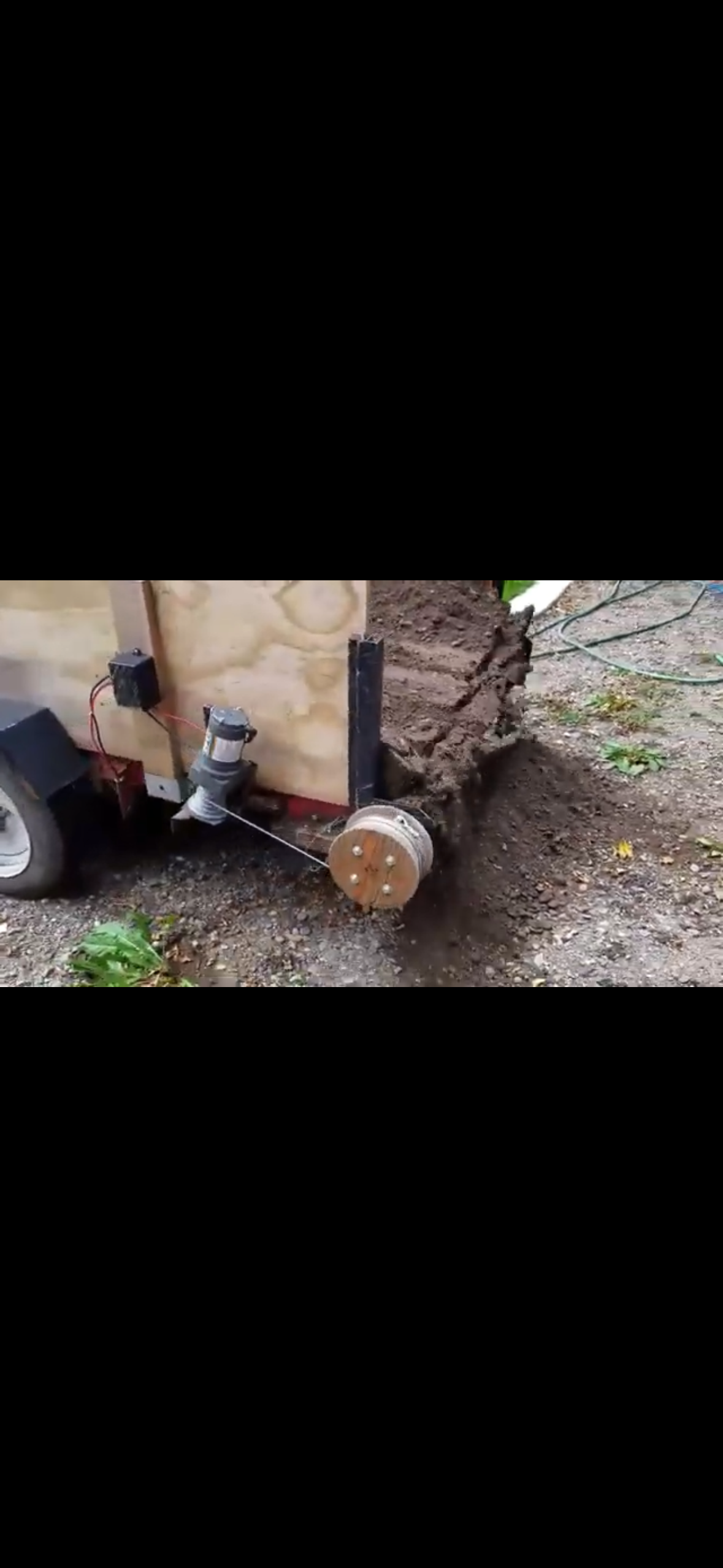

I have an 8’x5’ utility trailer I would like to use for unloading mulch, wood chips and dirt. The tarp I have is from an old cargo unloader that I use to use for unloading wood from my truck. I see you can buy them from harbor freight so you have a picture of what I have. Instead of cranking it by hand I would like to use an electric winch that I have. I’ve seen it done on a video. The problem I have is my keyed hub is 1-1/4” (1.250) and the pipe it needs to go on is (1.275). It doesn’t seem like much but it is. I would like to drill out the hub so it can fit over the shaft but I don’t know what will happen when the flute of the drill bit comes in contact with the keyway. Do you think it will damage the hub? If anyone is familiar with making a bored hub with 1/4” keyway larger?

If the link doesn’t work, I’ve attached a picture from the video.

The guy in the video appears to have welded some kind of hub to a rim that is connected to some kind of pipe being used as a roller. It doesn't look like he is actually using the HF roller that I can see.

Suggest you look on youtube for a video by Luke Fugate. He welded a large nut onto the roller pipe and then welded a corresponding socket onto the output shaft of an electric winch. That is how he connected his winch to turn the roller pipe without having to use the cable or a rim.
