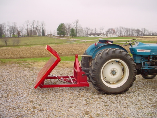

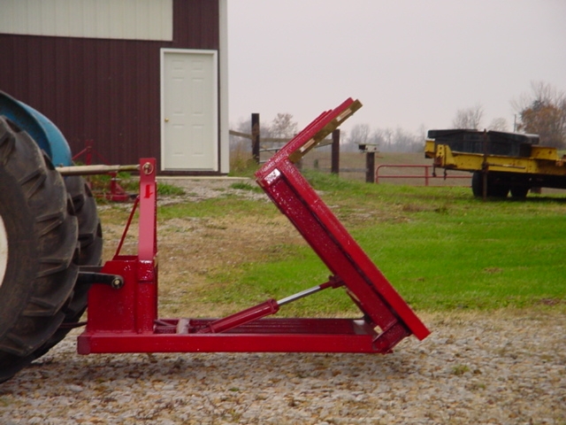

Add a hydraulic top link and lower the pins on the carryall to make it a dump carryall.
Great idea. I need to get a hydraulic top link on my tractor.

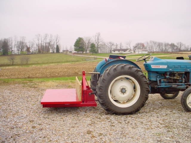

/ Carry All #25
Being you're limited to weight, this probably won't work for you, but maybe others can get some ideas, if they want to build their own. It has a multitude of uses, from easily hauling 8 bales of hay, to cleaning horse stalls, and dumping on a pile, picking rocks up out of a field, and dumping in a wash, with out leaving the tractor. Hauls a good bit of firewood, and I can stock a good sized pile making several rounds, dumping in a pile, to be stacked later. I even used it for weight on the back of the old Massey 180, using it as a roller to roll the fill for the horse barn, and shop. I just backed my dump truck up to it, and dumped a load of fill material on it. What stayed on was my weight. When I was finished, I simply hit the hydraulic remote to dump it.
It's definitely earned it's keep around here, and sure has saved a lot of work, and time.

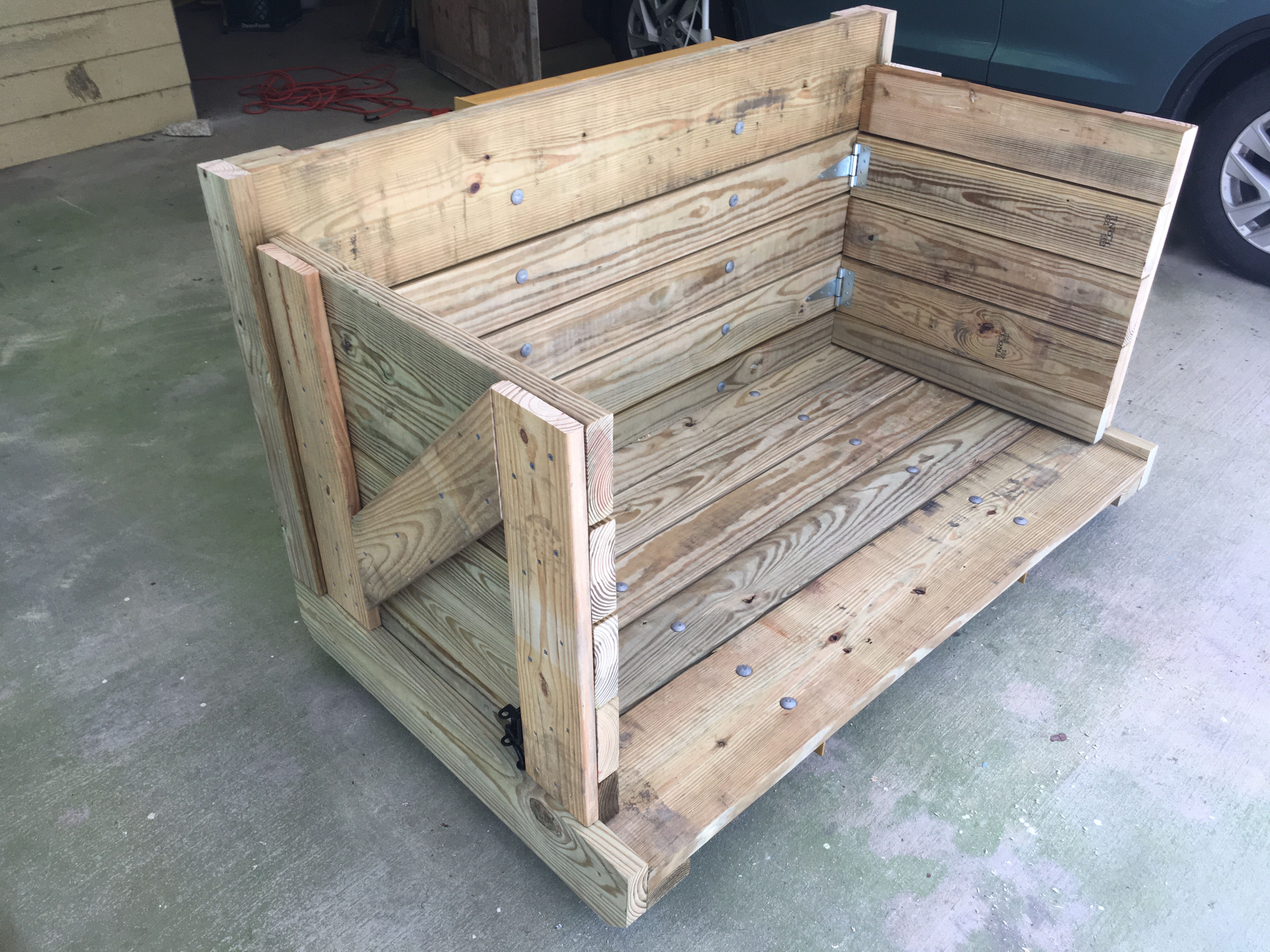

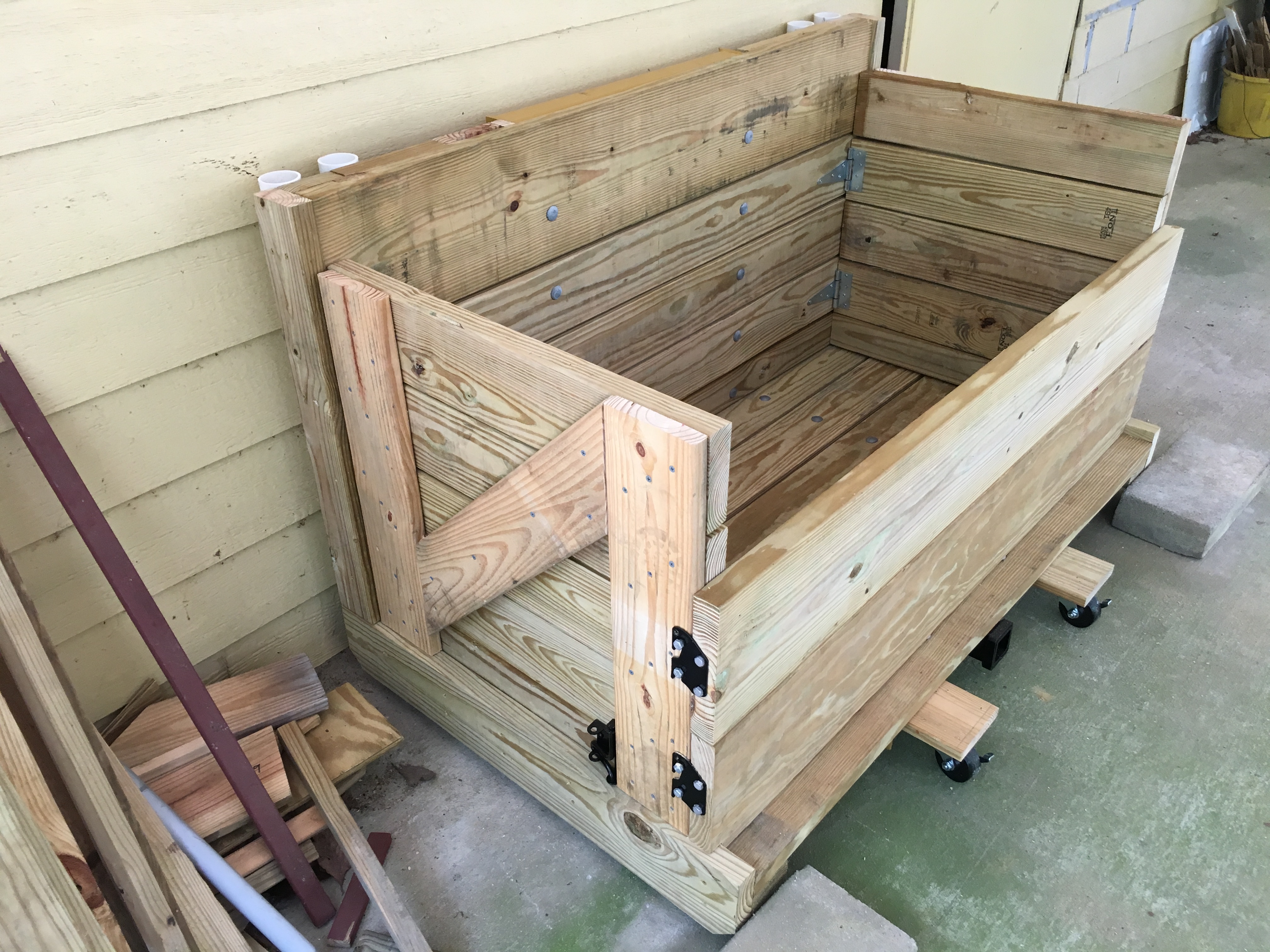

I used the TSC CountyLine carry all frame. You might get some useful ideas from the one I built. Here are a few pics:

/ Carry All #28
Welcome to TBN mpsmith60. Very nice job on that carry-all. Well thought out !

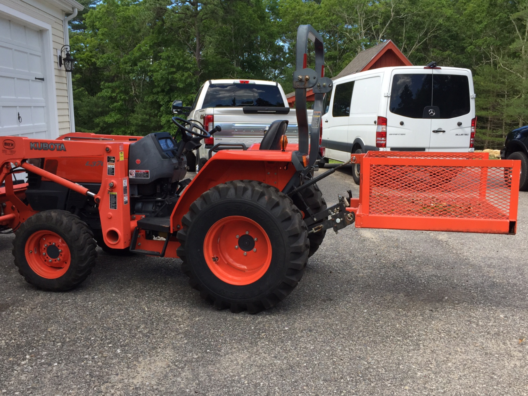

/ Carry All #30
My carry all.
/ Carry All #31
mpsmith60- nice concept, nice work.
Tomtint, Looks good. If you have a receiver hitch on that Sprinter, and a 2" stub off the back of your carryall, it would be a good way to carry dirty/stinky stuff on the highway!
/ Carry All #33
View attachment 586632View attachment 586633View attachment 586634View attachment 586635
I made one very similar (how different can boxes be?) only using plywood. I made a 3 piece drop in tailgate with handholds cut it. On mine I made a hold-in bar to keep the sides from spreading and letting my tail gate out. I mainly haul firewood and it can put quite a bit of out pressure on the sides. I may have to add tool holders to mine now. Thanks for the idea and pictures.

This combines the info about my carry all build based on the TSC frame into one post. Here are a few pics:
Also here are the links to the YouTube videos showing what the carry can do and how to build it:
Versatile Tractor Carry All for My Kubota Tractor - Part 1 - YouTube
Versatile Tractor Carry All for My Kubota Tractor - Part 2 - YouTube
Let me know if you find any of the ideas useful.
