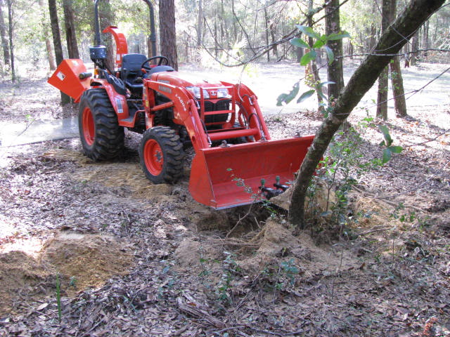

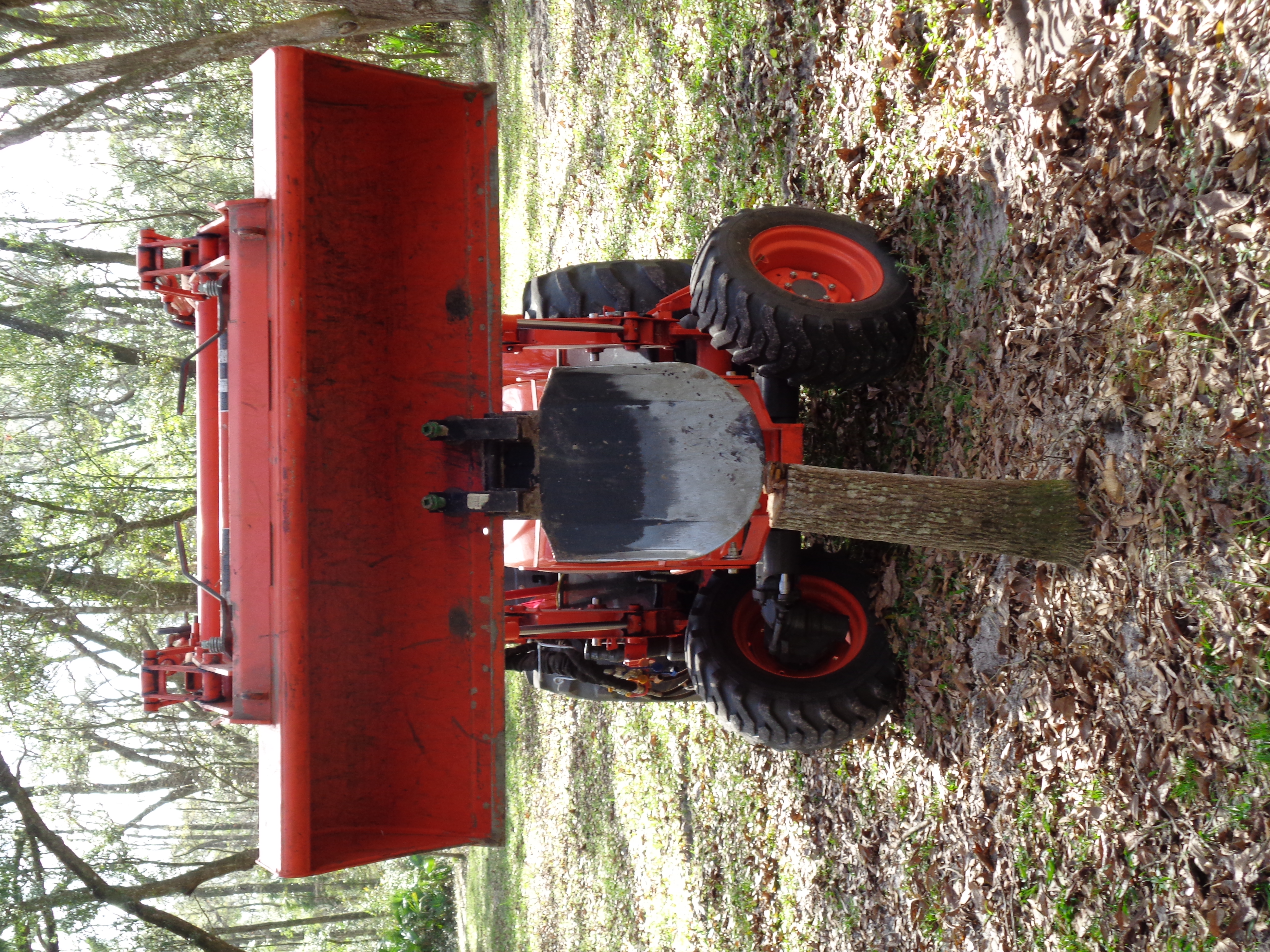

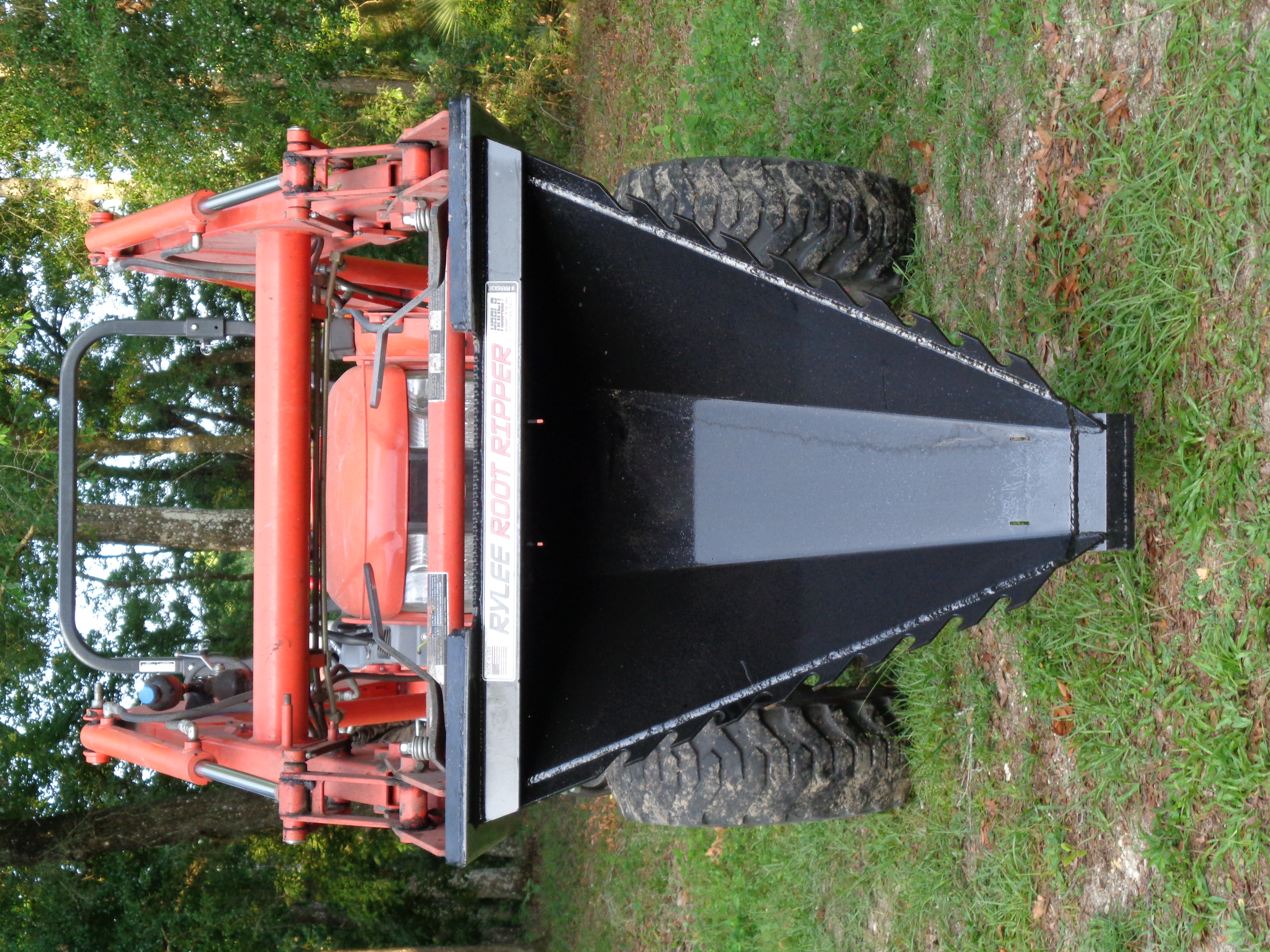

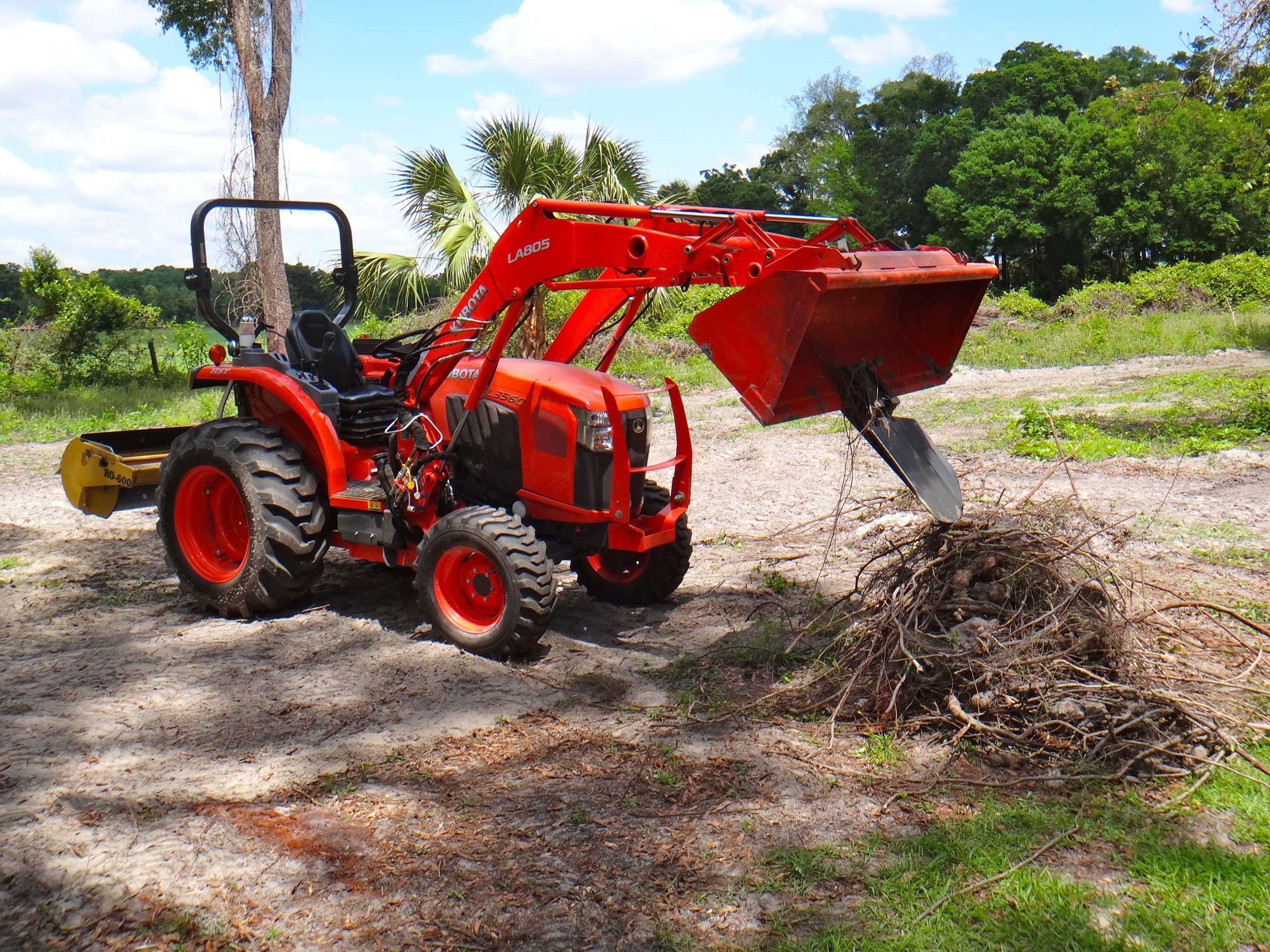

I recently purchased a 36" Stump Bucket for my Kubota L3560.
The tractor hydraulics lacked enough power to withdraw the SB from the ground unless exactly via the insertion path. ( 1,775 pounds FEL lift spec. at the pins.)
I feel confident saying your JD 3032e will not be able to handle a Stump Bucket.
Here is what I bought, then soon sold to a Skid Steer owner:
Skid Steer Rylee ROOT RIPPER Stump Bucket Tree Spade - RRR6X36 - MADE IN THE USA | eBay
https://www.tractorbynet.com/forums...ylee-root-ripper-stump-bucket.html?highlight=
I have had a lot of experience with the Ratchet Rake bucket attachment and a Bucket Solutions' Bucket Spade which led me to believe the SB would work on my Grand L Kubota, but I was sadly mistaken.
Note: we are both working Florida soil.

Based on my experience I recommend the Bucket Spade.

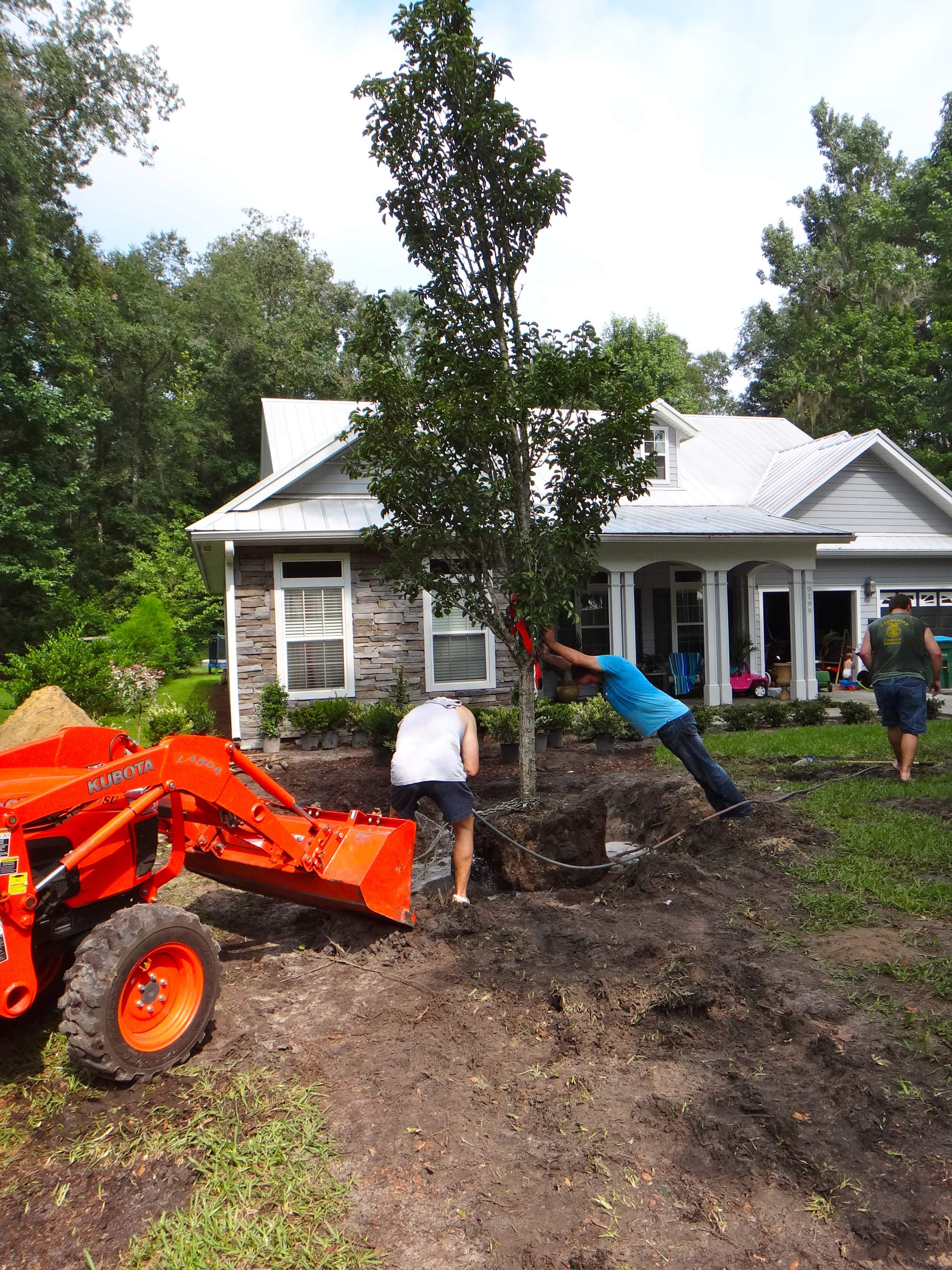

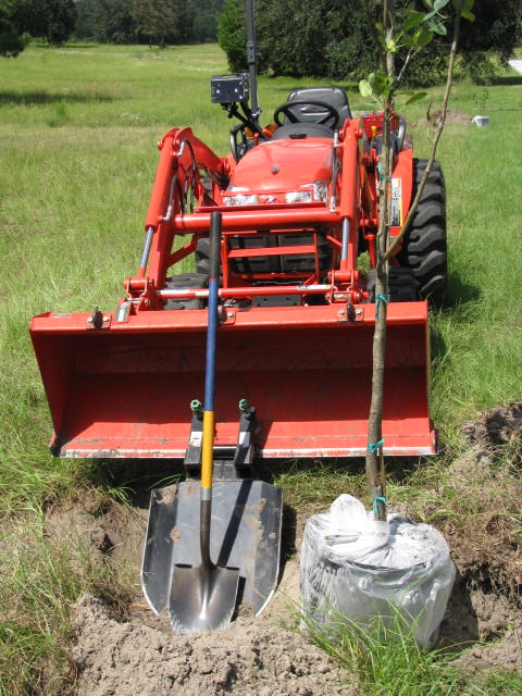

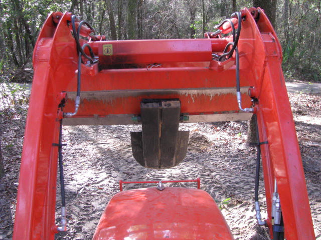

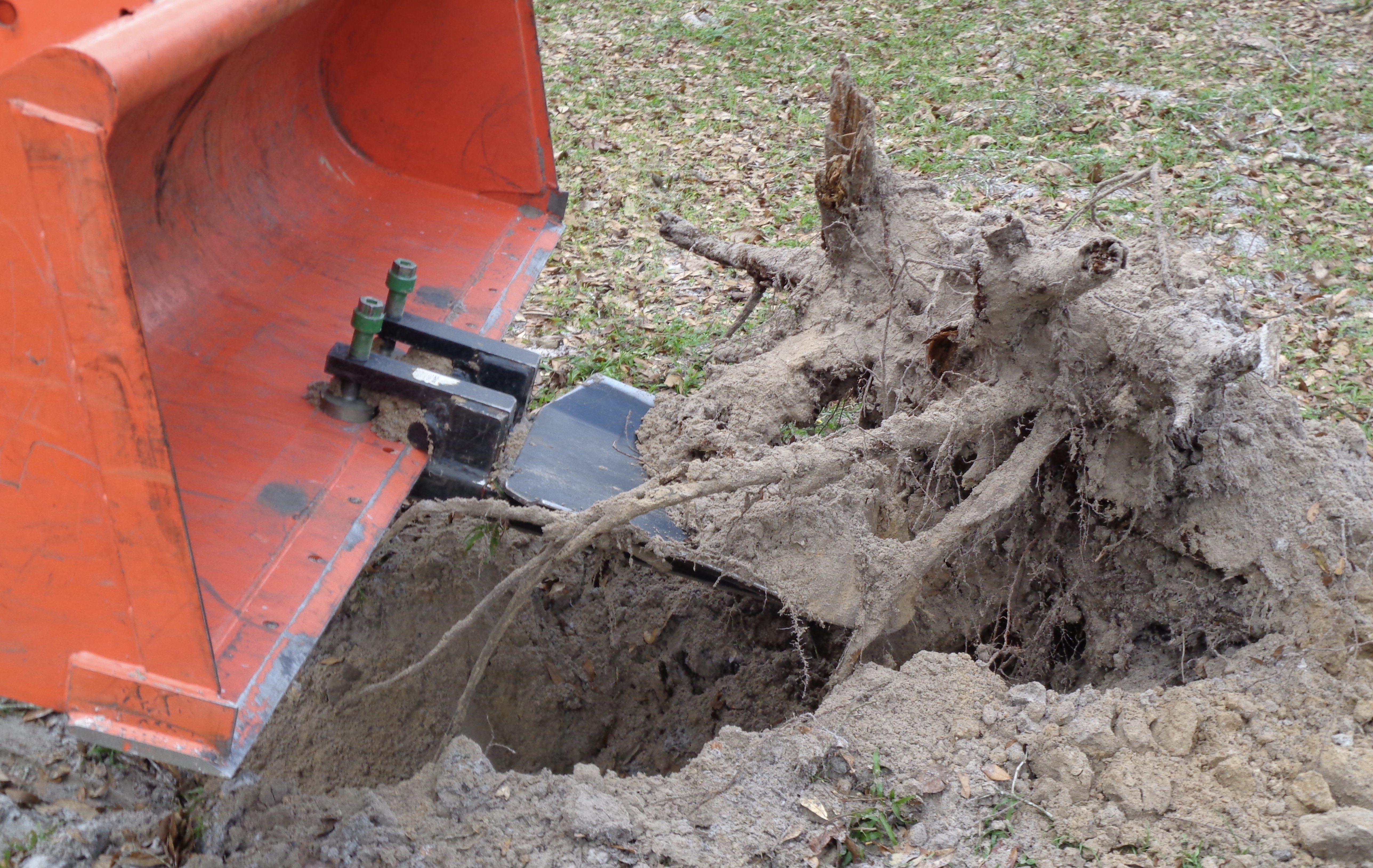

The three volume Bucket Spades are from Titan, Paumco and Bucket Solutions.
The BS/BS is forged and the heaviest of the three.
The Titan and Paumco are pressed steel and/or welded. Unquestionably, the BS/BS is the heaviest and highest quality with very secure attachment to the FEL bucket. BS/BS will tax your Deere PLENTY.
MORE: https://www.tractorbynet.com/forums/attachments/328798-bucket-spade-today-fel-bucket.html?highlight=

Keep in mind you will need at least 650 pounds of Three Point Hitch counterbalance in order to excavate with a BS.

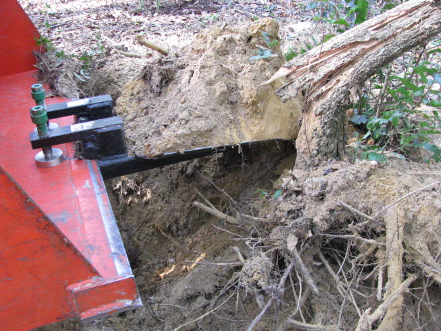

I believe I have more experience with a Bucket Spade than any other current T-B-N contributor.
1) Most Bucket Spades will excavate a hole 3' diameter x 3' deep directly mounted on the FEL bucket.
With Bucket Solutions (brand) Bucket Spade it is not difficult to dig 4' deep but hole diameter may be the width of your bucket.
2) No Bucket Spade on a tractor is going to move tree with an 8" trunk nor grape vines.
(I spent my working years in the California wine business, working for wineries which owned substantial vineyards.)
To move >3" trees an SSQA Tree Spade mounted on a Skid Steer or 6,000 pound bare weight tractor with an FEL is necessary. You cannot transplant established grape vines, they will die.
3) A Bucket Spade mounted on Pallet Forks over 30" has too much leverage, proportional to fork length, working against limited compact tractor hydraulic power, especially relative to spade support strength of a light FEL bucket.
Most, not all, Bucket Spades are designed for direct FEL bucket mounting on tractors and potential Pallet Fork mounting ON SKID STEERS.
PHOTO: BS/BS Pallet Fork sockets.
