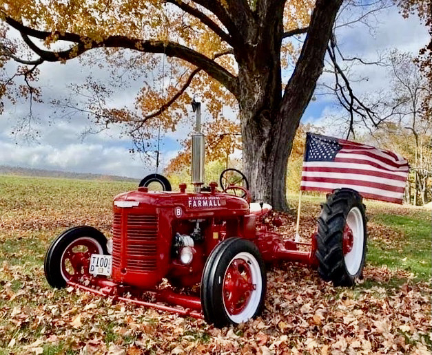

I thought about buying an older tractor like an 8N, but then I started reading about them flipping over. I'm sure you can use common sense be pretty safe, but I got to thinking that maybe all tractors could flip? Was looking for advice on safety. I was thinking I probably need a sub compact now because they look safer, but I could be fooling myself.
I started driving one of the 8N’s we have when I was 11. Probably the most dangerous incident that has occurred in the 39 years since then was ~ 20 years ago mowing dow an old trail where someone had left a stump short enough vegetation could grow over it to make it not visible but not low enough it could be mowed over.
Rear tire climbed stump tilting the tractor then it hit them it stopped instantly as the long came between the tire and bush hog. The steering wheel became a “seat belt“ at that instant with a little bruising. I cut that stump off flush as well as any others since or leave them closer to 4 ft + high so they are not low enough to become camouflaged.
Neither of the two we have have been rolled, that said none of the other tractors we have have been rolled either. Including the tricycle Farmall Super MTA, that is really intended more for row crops than what we use it for. Much higher center of gravity and being a tricycle like the killer ATC’s that were banned in the US back in 86-87.
I am not sure one could ensure they never roll a tractor because I have seen some folks that could break an anvil with a rubber mallet but being scared of being hurt or killed goes a long way towards making the right decisions. Many “accidents“ happen to people that really know better and just take risks that are needless. If any activity is recorded, you can bet someone didn’t think was safe.
