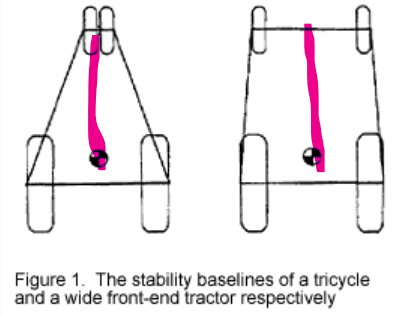

No convincing because your drawings don't align with reality. I have not clue how many agree, but that doesn't matter; what matters is the physics of the situation, some drawing.
Here's what it really acts like:
What are you talking about?No convincing because your drawings don't align with reality. I have not clue how many agree, but that doesn't matter; what matters is the physics of the situation, some drawing.
And that the tractor’s CG moves as it yaws, rolls, or pitches, especially when it is in motion due to centrifugal force.Your drawing is right to some degree but you’re ignoring the fact that the front axel has stops.
Again, while experience makes an enormous difference, the physics of a 3 wheeled tractor and a 4 wheel tractor make the 3 wheeled tractor less stabile on slopes. Always!Depends on land your using for and how much seat time under your belt.
Hit a bump or a hole and all bets are off.And that the tractor’s CG moves as it yaws, rolls, or pitches, especially when it is in motion due to centrifugal force.

Also comes to mind how the old 3 wheel ATVs all went away in favor of Quads. Those old three wheelers would flip in a heart beat. Basically the same tread width, same wheelbase.
And they were all wide fronts, so must be more dangerousFond this nugget when searching…
That would be true if both axles were rigidly connected. But every wide-front tractor I've ever used has the front axle jointed so that on uneven ground it isn't constanly trying to twist the machine.![]()
