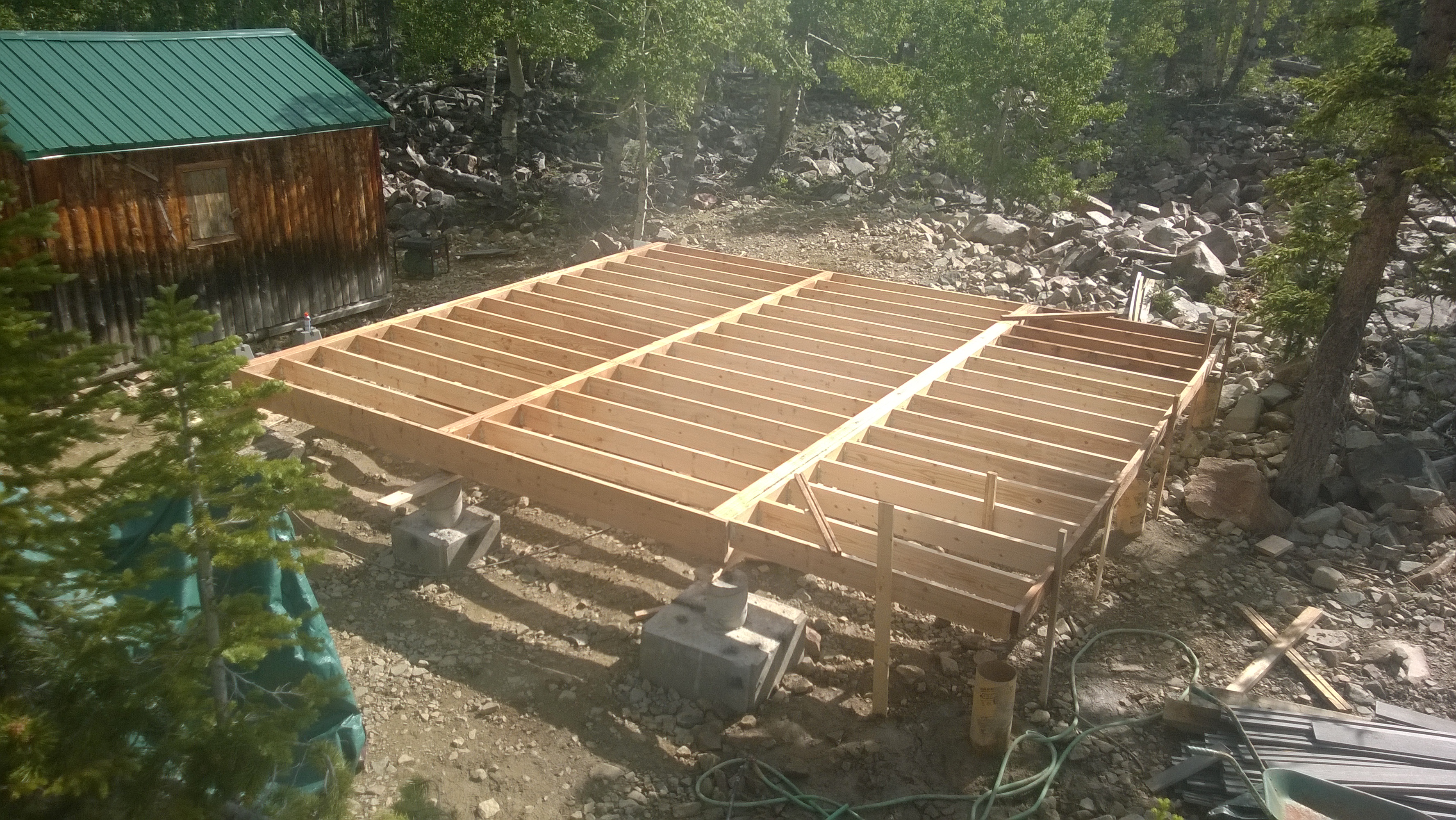

Been a while since I last posted here but this tread head a nail on the head. I build sheds and small houses with this exact same problem. Solution is to build the floor in sections (called platforms) each is 4 by 8 feet with "upside down" floor joist then 1/4" plywood, next turn back over and install a 4x8 sheet of subfloor plywood (usually 3/4") with only four screws, then install to the support piers or blocks. wait for it.
Next install "grade beams" completely around the outside edge of building on the piers to hold all the platforms in place, next install walls on the outside beams, then the roof, and wall cladding.
Now back to the floor, it is nicely dry no water in the insulation, lift the subfloor from the first row of platforms install insulation (usually mineral wool - Roxel), roll out vapor barrier one row at a time and then reinstall plywood sheets and firmly fasten down.
Note, often times go the extra and paint everything before installing to provide extra protection (white - the pencil lines show up better).
This helps in our neck of the woods due it rains just when you don't want it and also makes a very strong floor system (double floor joist every four feet.
Yes, cost a little more but also uses smaller components which a easier to handle and place.
Cheers and post pictures of your project.

Considering this is a camp house. I'd frame your floor normally, then sheet it with the cheapest stuff you can find (1/4" OSB?), then lay down a 1" layer of rigid foam. Then sheet with 5/8 or 3/4 T&G sheets, or go directly to wood planks for a finished floor.
Is this in Texas? are you heating or cooling the camp?

Some thoughts:
You will never regret having a building well-insulated. Even if you only use it seasonally, the ability to be comfortable at the edges of the season is something you will appreciate. Even if it's unheated, if it's tight you can close it up and stay reasonably comfortable with just the heat from your activity in cool weather. The nature of these kinds of places is either you use them a lot less than you expected, or a lot more. If it ends up being a lot more you'll find yourself going there in all kinds of weather.
Keeping rodents out is always a concern and particularly with seasonal-use buildings. Even if you can't keep them completely out you want to limit the amount of harborage you give them. So everything should be as tight as possible. A mouse can go through a hole the size of a dime, a rat through a hole the size of a quarter. So I like the idea of boxing the bottoms of the floor joists with plywood. Since by the look of the pictures it doesn't seem like you have much clearance below, I like the idea of running cleats along the joists and doing all of the work from above. But I see some issues. Whenever you insulate you have to worry about moisture. If any gets in there it's not going to have a way out. There is a constant debate about whether it is better to seal things up completely and keep moisture out, or give it a way out. I would consider using 7/16" Zip board for the bottom, it's about the same price as 1/4" CDX plywood around here, but has better weather resistance. It also is less likely to warp so it will stay tight. If you decide you want moisture to have a way out you might put a round vent at each end of each bay.
A lot of people around here are using wood I-beams for joists, if you used them the cleats would be built in. I don't know how they compare price wise.
It's going to be really important to keep the insulation dry until the building is sealed. It's going to be a challenge though and it may be your biggest issue. The idea of building the sub-floor so it can be removed is intriguing, but I think having a solid subfloor gives a better building. If nothing else you have a solid barrier against rodents.
Roxul insulation has better moisture resistance than fiberglass, but is somewhat more expensive. This might be a good use for it.
What about plumbing and electrical? Are you going to have those? With the joist bays sealed it's going to be very hard to run those.
I would do it so that if you had to, you could come in from below later and get into the joist bays. If the plywood isn't fastened to the cleats, I think with 2x8 or larger joists you could lift the plywood from below and angle it and pull it out. You could also just pick up a piece and slide it over a neighboring piece. Think of like a suspended ceiling.
It may end up being easiest to put the sheets of plywood in while you're framing, but not the insulation. Once the building is sealed, crawl under, slide the plywood to one end, put up the insulation and slide the boards back. It depends a lot on how much clearance you have.

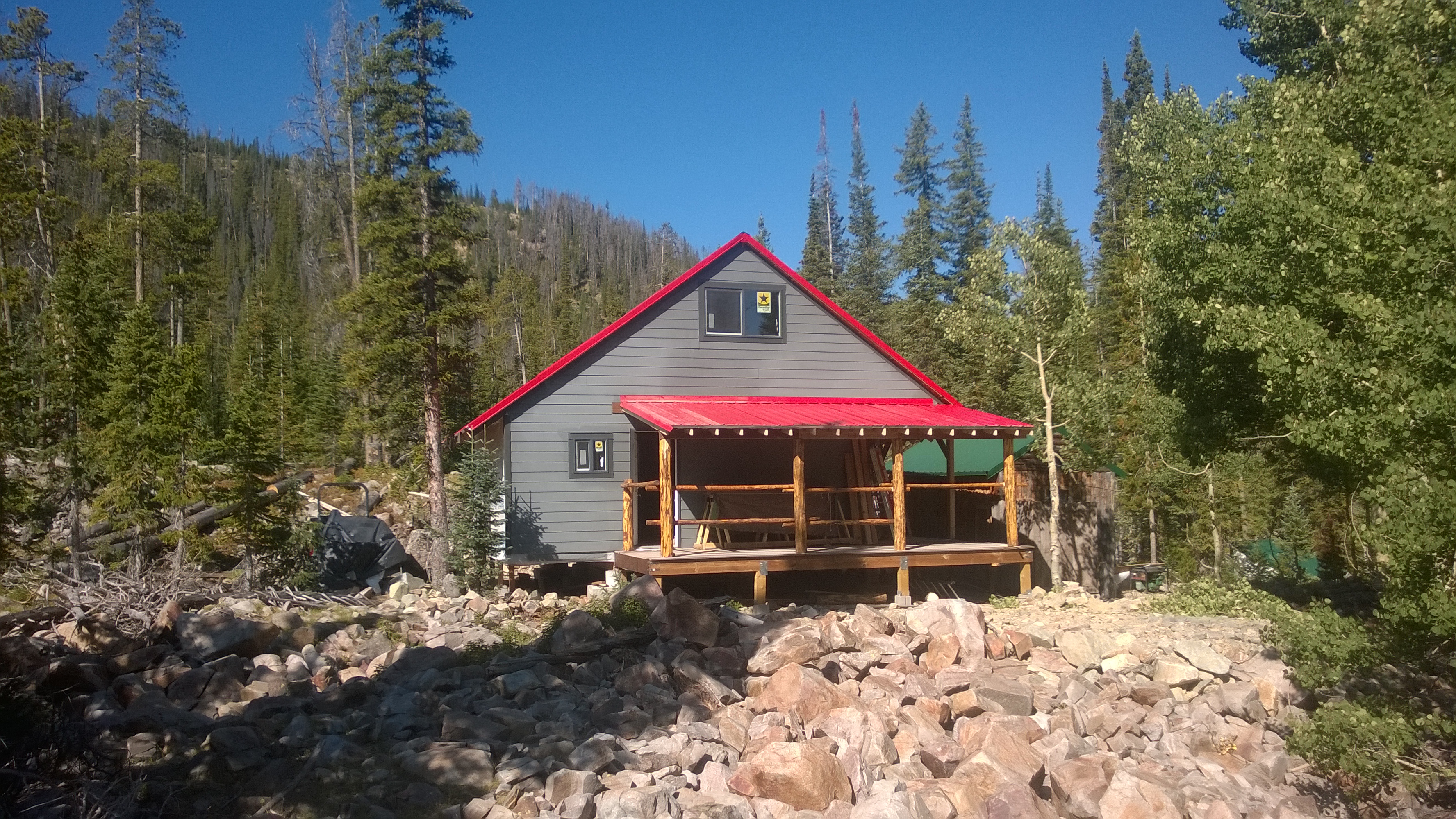

That is a fantastic looking cabin, Heck of a view.

When we built our cabin in Alaska we reached a point, very similar to the OP pic in post #4. We inquired about insulation under the flooring and were advised that almost nothing would keep the rodents/insects out. The rodents would go right thru plywood to reach the space between joists.
In the end we put down 2 x 6 T&G planking with no insulation. We put large throw rugs on the floor to help with the cold. It all worked out fine - my feet were always warm.

I think I'm going to go with 1/4 plywood attached to the bottom of the floor joists and fiberglass insulation. I've found enough lightly used 1/4 inch on Craigslist for 8 dollars a sheet.
Thanks for all the responses!
