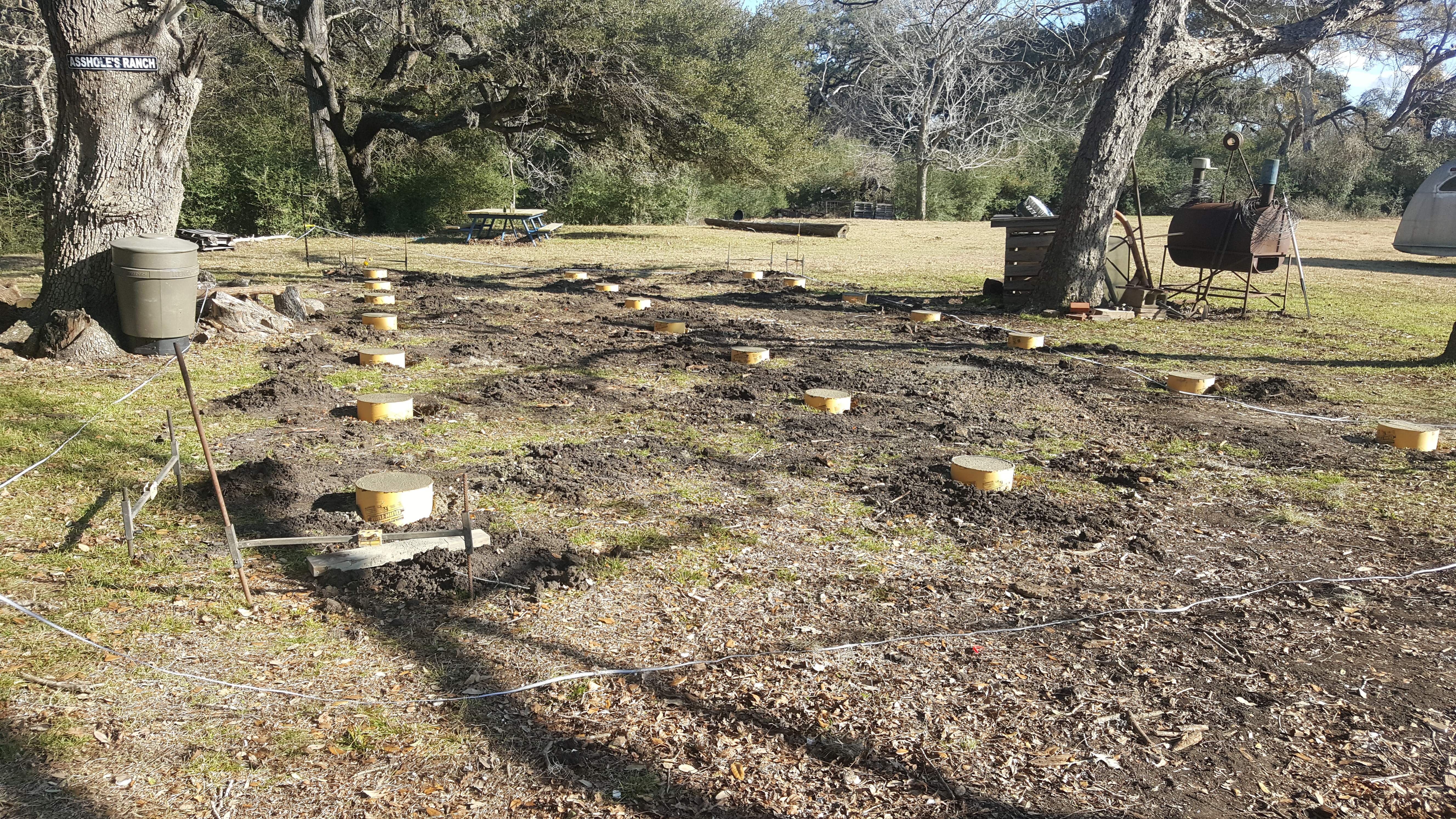

Anyone know of an easy/inexpensive way to insulate the floor for a pier & beam camp house? It's new construction.
Fiberglass batts between the floor joists I think would just end up as rodent nests
I've thought about insulating skirting around the perimeter and skipping the floor insulation
Foam boards between the joists seems like a lot of labor

Here's how far along I am

I hope your neighbor with the ranch doesn't mind that you are building that close to him.
