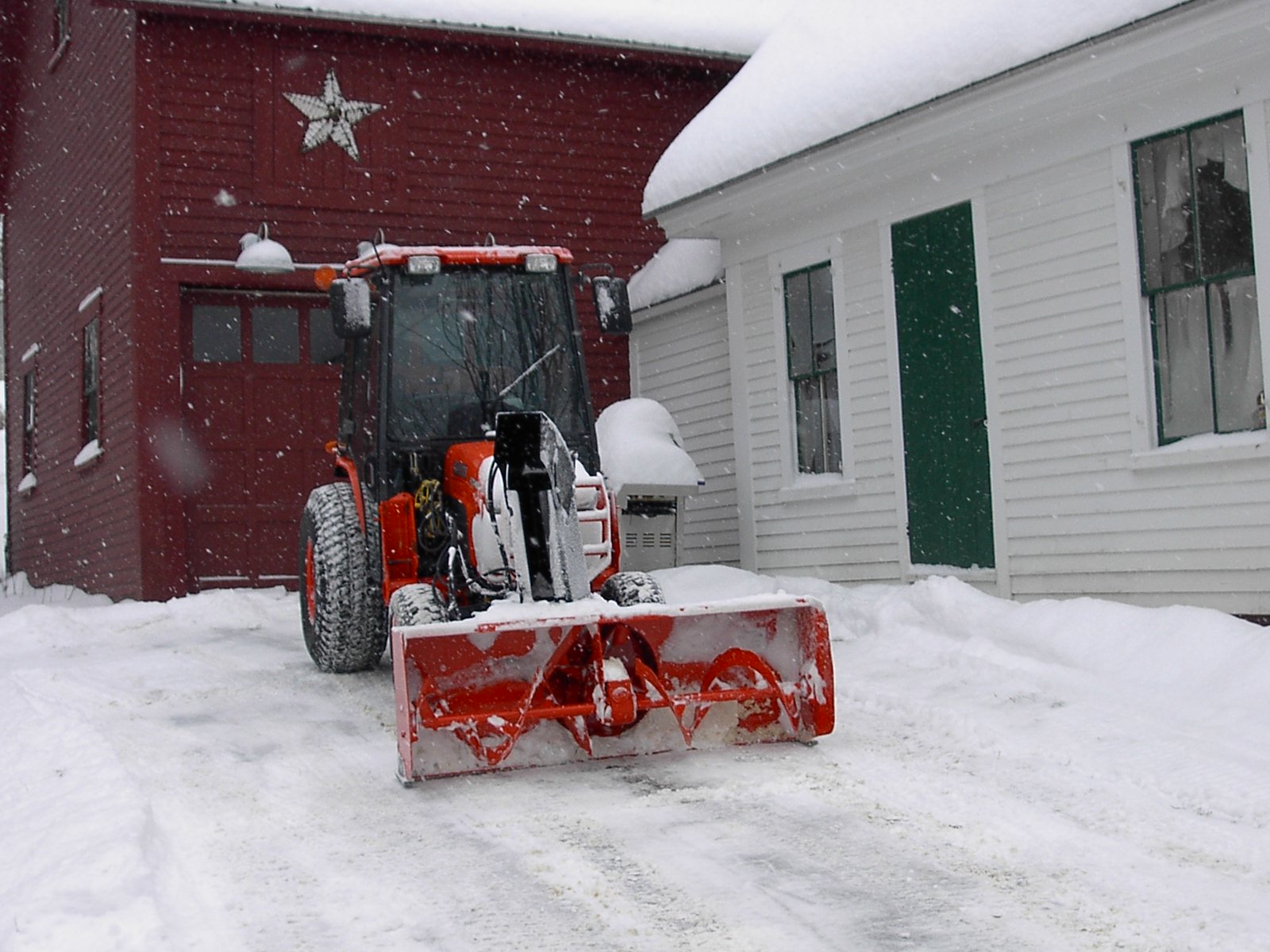

I'll offer up what I can. I don't yet own a 72" belly mower (but I may eventually), but I do mow with a 60" rear finish mower. I have yet to have anything slow the mower down. Tall grass..... a little brush, whatever, it cruises right through it. Put the A/C on low or medium, turn up the tunes, set the cruise control and enjoy the ride ! No black flies, no mosquitos, no pollen, no sweat!
YouTube - Landpride FDR1560 & Kubota B3030
I've got the same blower you're looking at. The 3030 with that blower on it is a snow eating machine with no conscience ! Only in the deepest snowbanks when the town plow fills in the end of the driveway do i need to slow to a crawl to get through it. I clear a couple of my neighbor's driveways besides my own, and frankly........ I take my sweet time so I can stay out in the blizzard longer. The B3030HSDC makes what used to be a chore, into a boatload of fun. Shhhhhhhhhh !!! DO NOT tell my wife. She thinks I'm working hard out there. The heater will easily sweat you out of the cab if you crank the heat up. You could comfortably snowblow in shorts and a tanktop. Seriously. Once again, turn up the tunes and go!
YouTube - Kubota B3030 Night Snowblowing With O&A
If I were going to make any complaint, it would be that the side windows fog up easily. The remedy is to turn the A/C button on (to dehumidify), turn the heat setting down, and the fan set higher. Again.... really a minor complaint.
I will recommend you add a chute deflector control to the blower. It will allow you to place the snow anywhere you want. I went with a hydraulic setup, but Kubota also sells an electric chute control.
I recommend sticking with the turfs, and forget about chains. I have zero problems getting around...... even in an 18 inch snowstorm. One minor issue with the turfs is that they are larger in diameter than the R4s. It will be a small problem if you have a 7 foot overhead door like I do. I had to modify my door trim to get the tractor inside..... since its like 7 foot, one and a half inch with the turfs. The 3030HSDC with R4s is about 6 foot eleven, and will just make it under a seven foot opening. I did try blowing with my weightbox on the back, thinking I'd need it. Turns out the weightbox makes the front lighter with the blower in float, and it didn't steer as well. Just leave the weightbox in the garage.
I honestly don't think I could be any happier with my 3030HSDC than I am. Do a little searching here, there have been some members who've made some nice, functional modifications to their tractors. Things like backup cameras and dome lights. I highly recommend the 3030HSDC to you, and if a little more money isn't going to hurt you, get the HSDCC. It will have a rear windor defogger (though not terribly necessary) and a 60 amp alternator instead of a 40 amp...... always better in case you ever add a couple more worklights.
