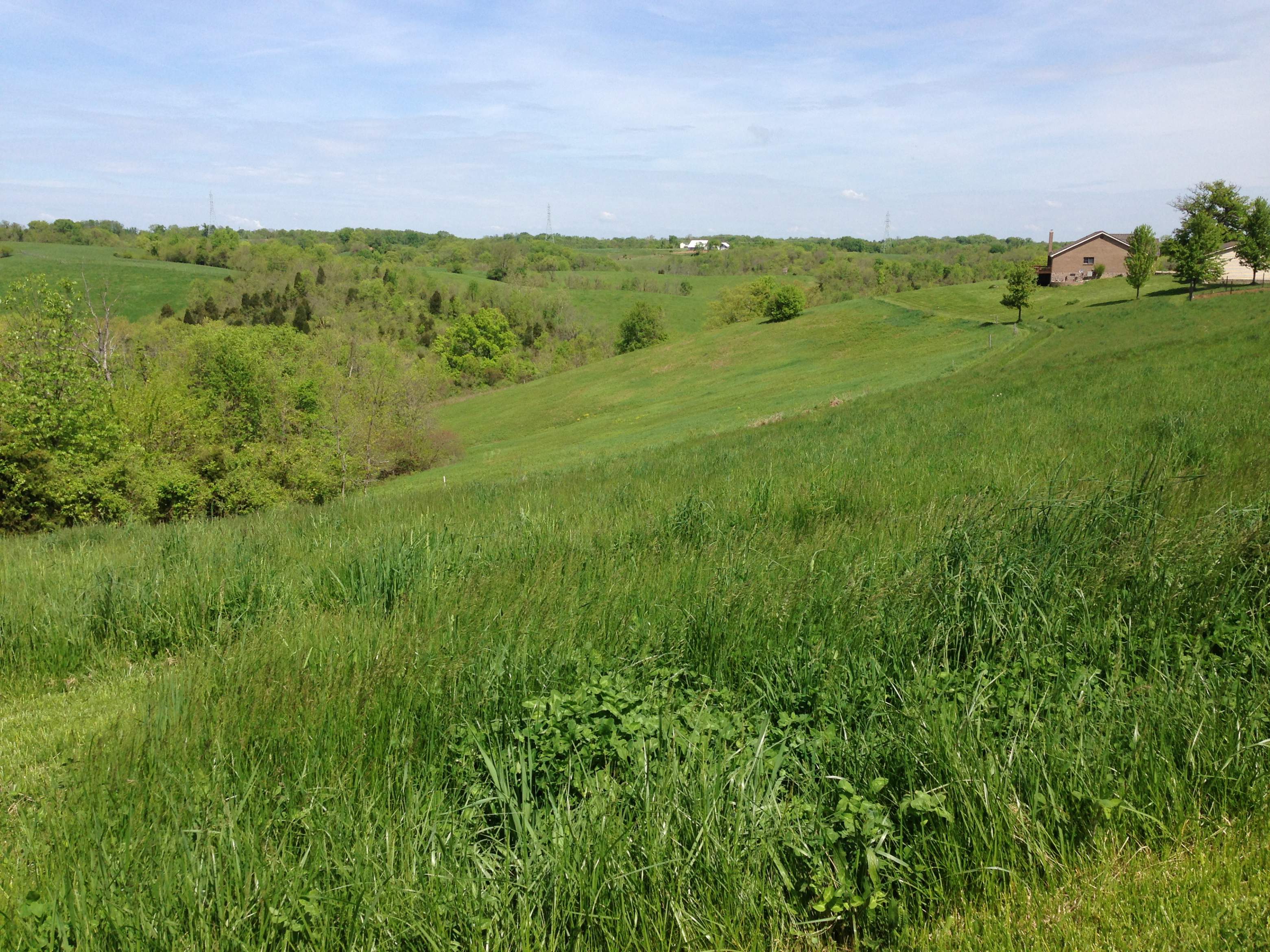

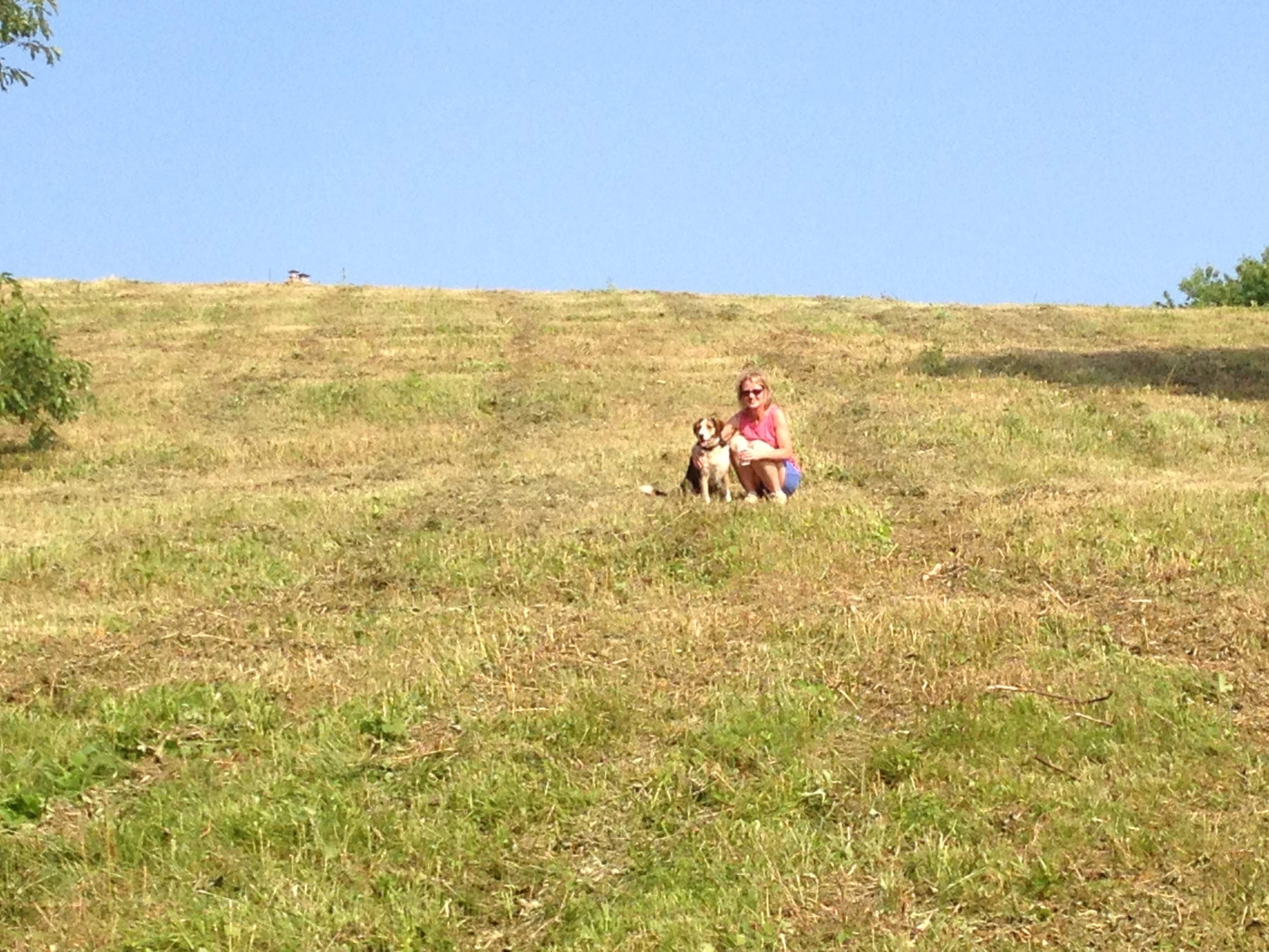

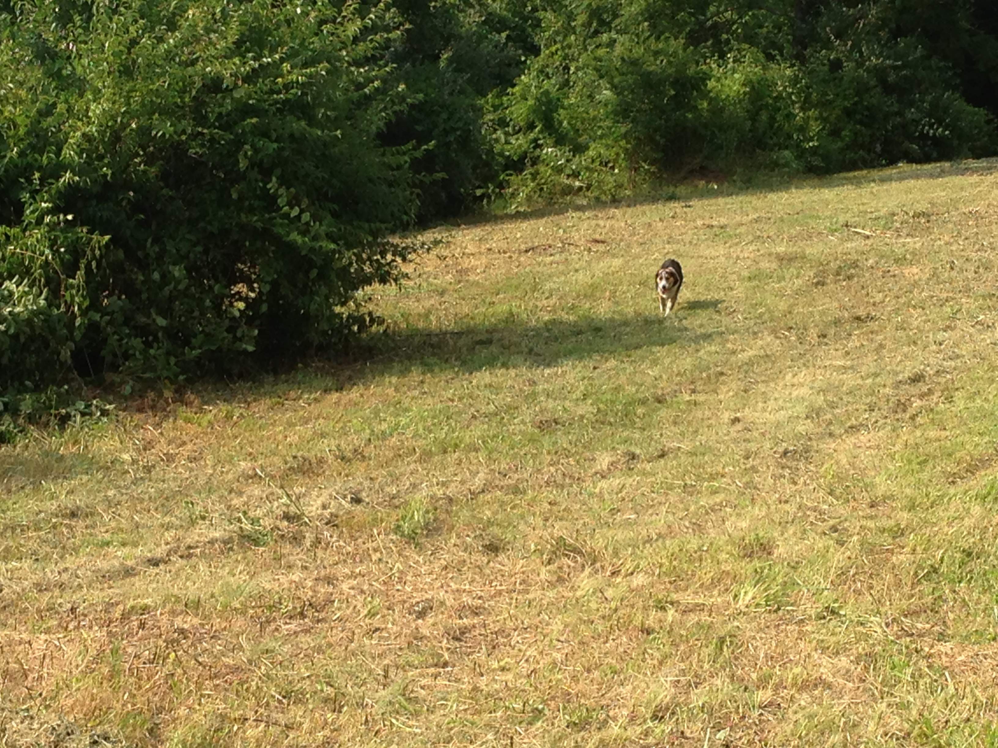

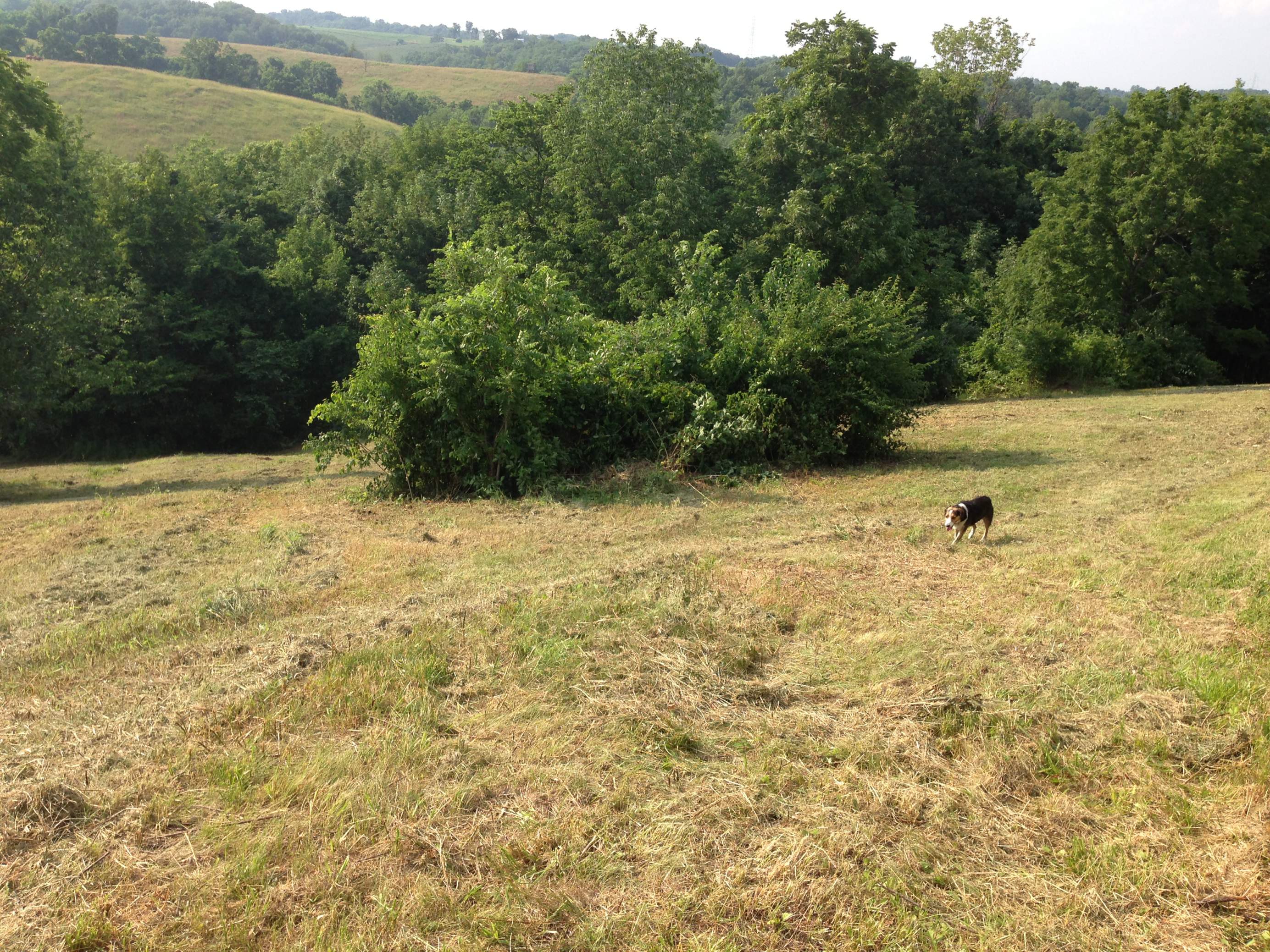

Rhino
Some shots of the slopes I bush hog.
