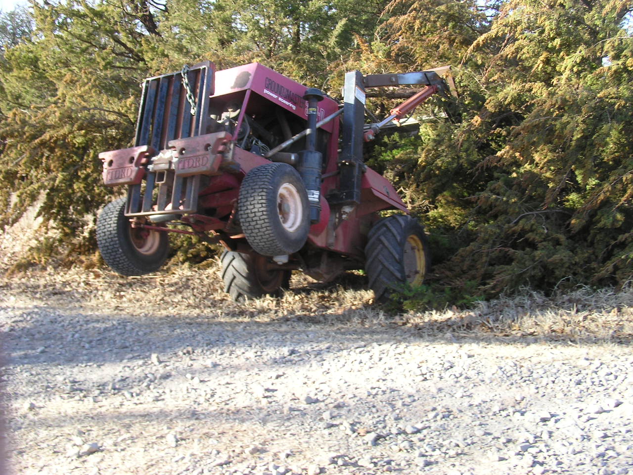

All these calculations are missing one thing... The loader might not be the weak spot. There is a good chance your maximum loader lift capacity is actually based on your front axle or front tires. Personally I'd much rather go into relief, or blow a hose than bust my front axle. Blowing a tire with a heavy load could easily result in rolling the whole machine in many circumstances too.
Front axle testing.. :D
In all seriousness, this is why I got an SSQA plate for the rear. The rear is designed to handle higher loads for a longer duration than the front end. Plus it's more stable to carry on the rear.

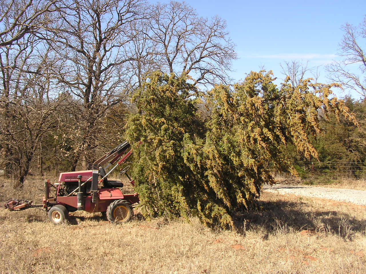

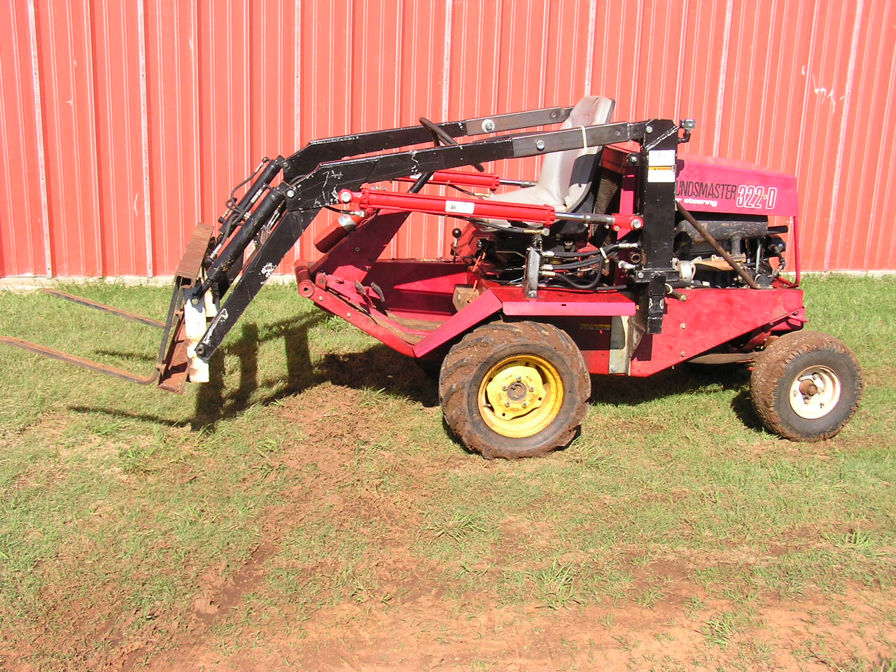

Here is my front axle testing: :)
Added some rear counter weight. :thumbsup:

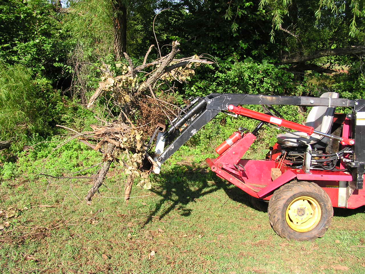

Your tractor is probably bigger than my loader and there have been many times that I could have used a grapple instead of picking up brush by hand and putting it on the forks.

Would love to see a video of you getting on the Toro.:)
