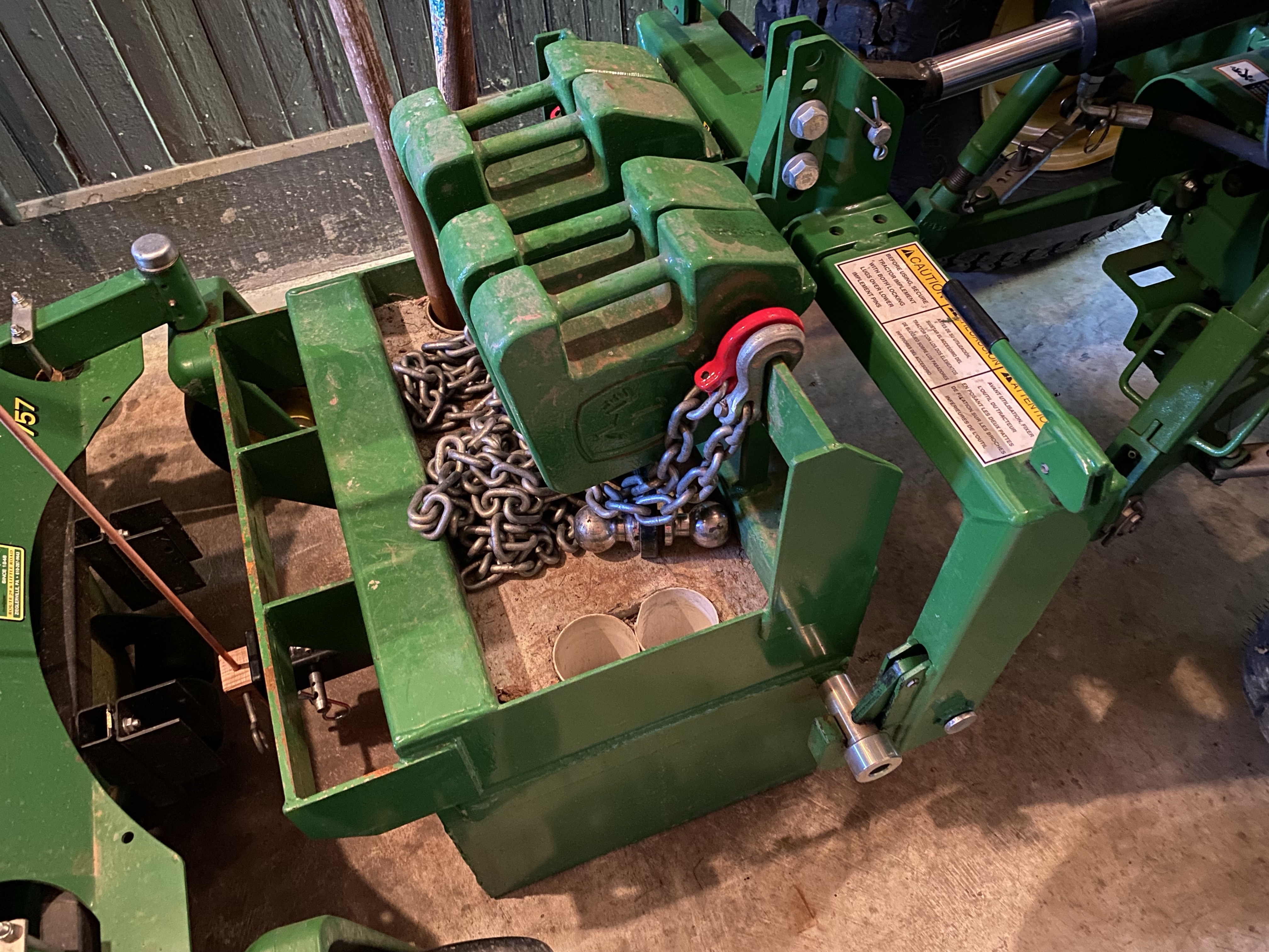

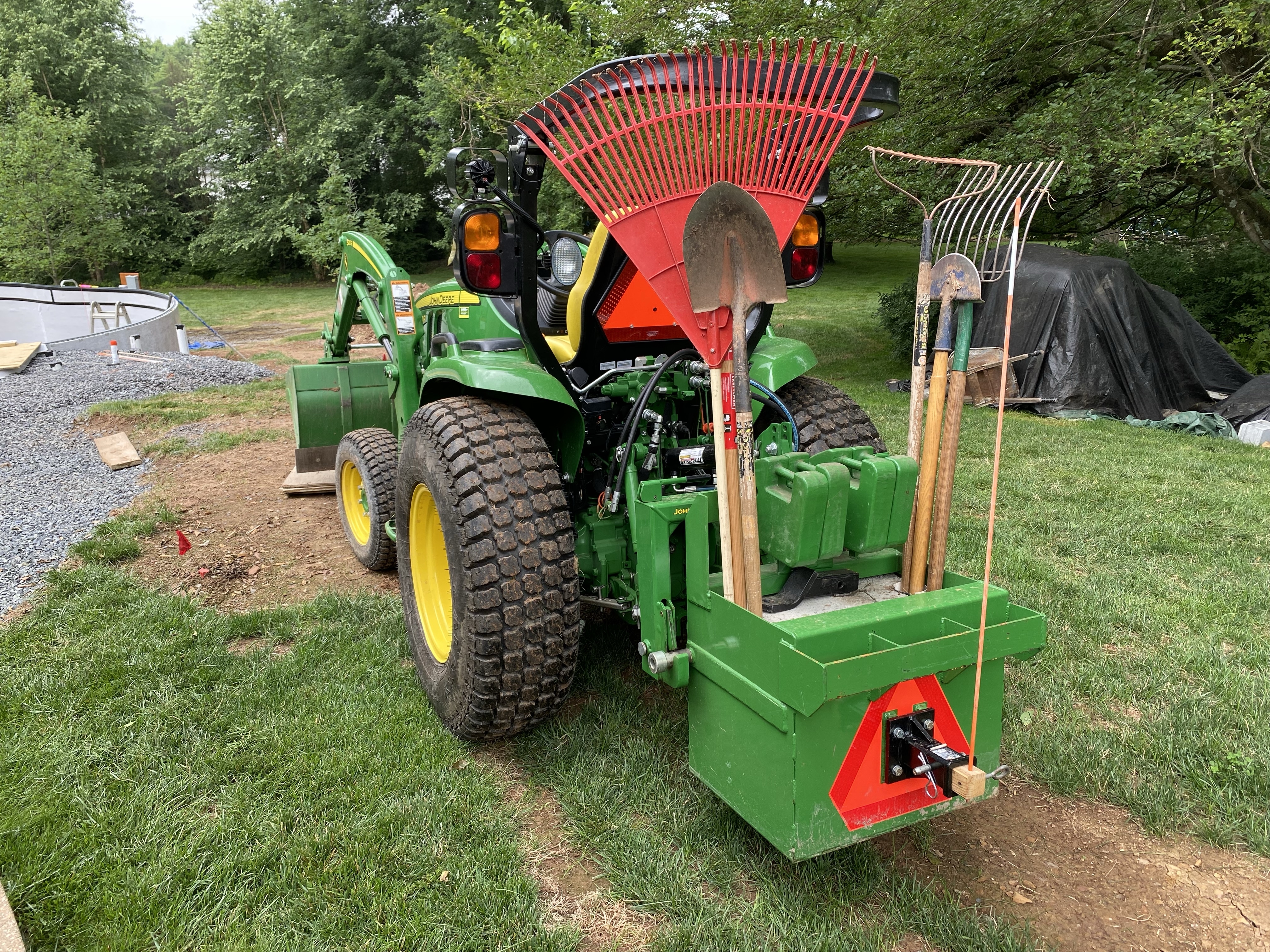

   / “Forcing” the FEL to lift? #24

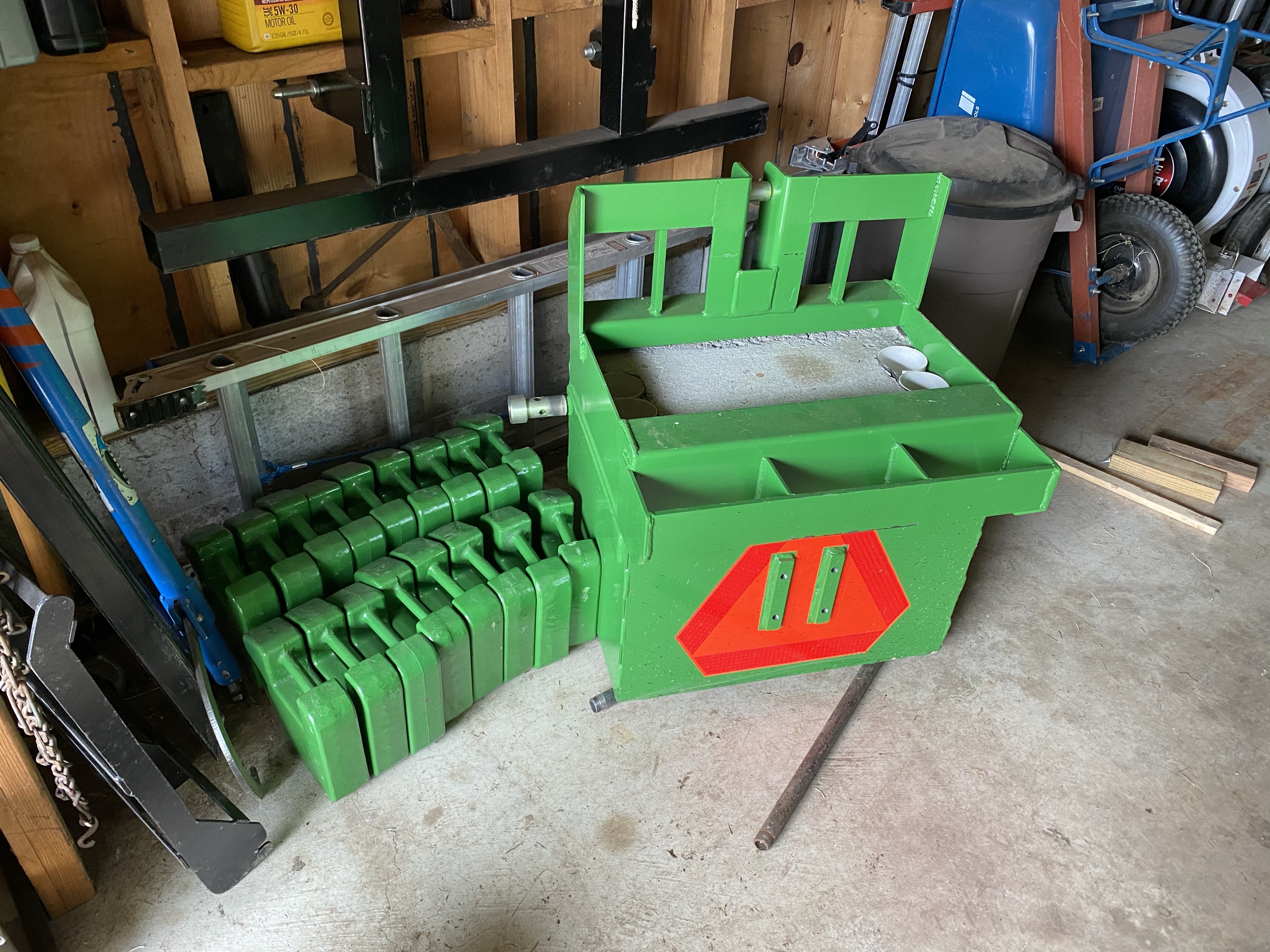

Just a means of holding the plow marker, as a visual on how far the hitch receiver projects, so I would stop backing it into things in close quarters. :ROFLMAO:
On my old tractor, I rarely used the hitch receiver on the ballast box, so I'd remove it when not in use. That machine was fine towing trailers from the drawbar.
But on my newer tractor, even the empty bucket is so heavy that the tractor has traction problems without the ballast box installed. So now the hitch receiver is pretty much always left installed, and I keep the plow marker installed on it most of the time when I don't have a trailer in tow.
For the same reason, I made a flag for my front hitch for when I am mowing...it helps.

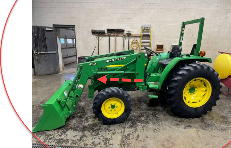

   / “Forcing” the FEL to lift? #29
Here is an alternative - "how it works" thought. Having to slightly back out of the material as you lift is more of a function of the dirt pile that is staying rather than what you are lifting. The geometry of tractor loaders is such that the loader actually moves forward on its way up when the bucket is lower than the loader hinge pin. So, when you are lifting from the ground your loader either has to push the pile forward or push the tractor backwards in order to lift the load.
I tried to illustrate below. The lift cylinder is pushing almost exactly forward on the loader. The arc the bucket has to take without curling the bucket is the other red line. So it has to go pretty far forward in order to lift. I have a baby tractor so I have to make use of this knowledge most of the time when I am moving material. I can always get a fuller bucket - faster - if I walk the tractor backwards slightly while I'm curling and lifting.

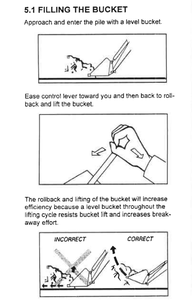

   / “Forcing” the FEL to lift? #30
My 2 cents: Your loader/bucket has a maximum lift weight, and also a maximum breakout force. If you cannot break out or lift, you are overloading. Either try to take/do less or get a larger tool.
Also, RTM...read the manual. Generally, manuals have instructions on how to efficiently use the tool. Attached is the "filling the bucket" instructions from my loader.
