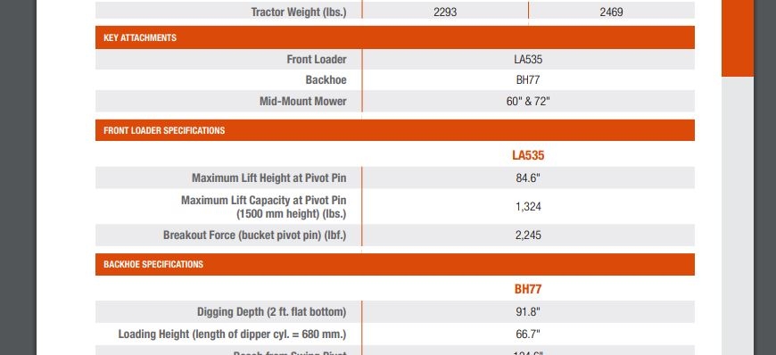

I have an extremely low hour LX3310 and could use an extra few hundred pounds of loader lift capacity and was considering a new LX4020. I thought I read and saw online that the new FEL on the LX4020 (even though the designation LA535 vs LA545 does not suggest it) was much more capable and +200-300 lbs over the LX3310 FEL, however when going to the Kubota site now I see almost no difference:
FRONT LOADER SPECIFICATIONS*
MODEL.................................................................LA535...........LA545
Lift Capacity (Pivot pin) lbs. (kg)............................1067 (484).......1100 (499)
Lift Capacity(Pivot pin @ 1.5m) lbs. (kg)................ 1324 (601).......1325 (601)
Outdoors With The Morgans showed his 4020 with 350 lbs Landpride forks lifting ( just off the ground) an IBC packed with split oak that he thought weighted ~1400 lbs and held a full 1/3 cord of wood.....

Because no.......they are basically the same loader with a slightly different model number. Probably the exact same geometry, operating pressure, and cylinder sizes.
And since they have breakout forces ~2250# at the pins.....it stands to reason that it could lift a 1400# estimated weight just off the ground on pallet forks.
But to answer your question....NO there is not gonna be a 200# improvement by going to the LA545 loader over the LA535. There will be no real world change whatsoever

Where do you see 2250 at the pins?
In the kubota brochure
