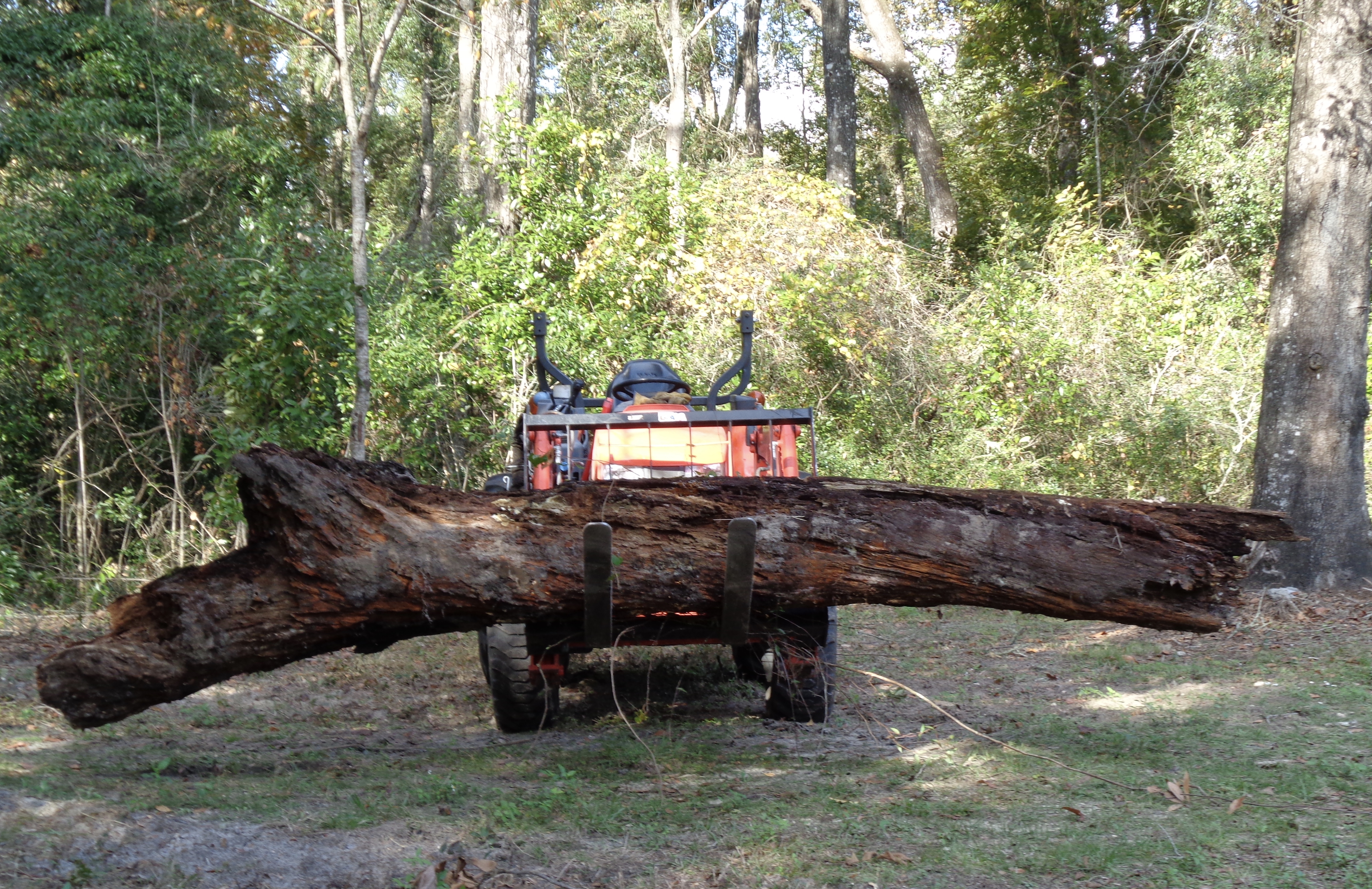

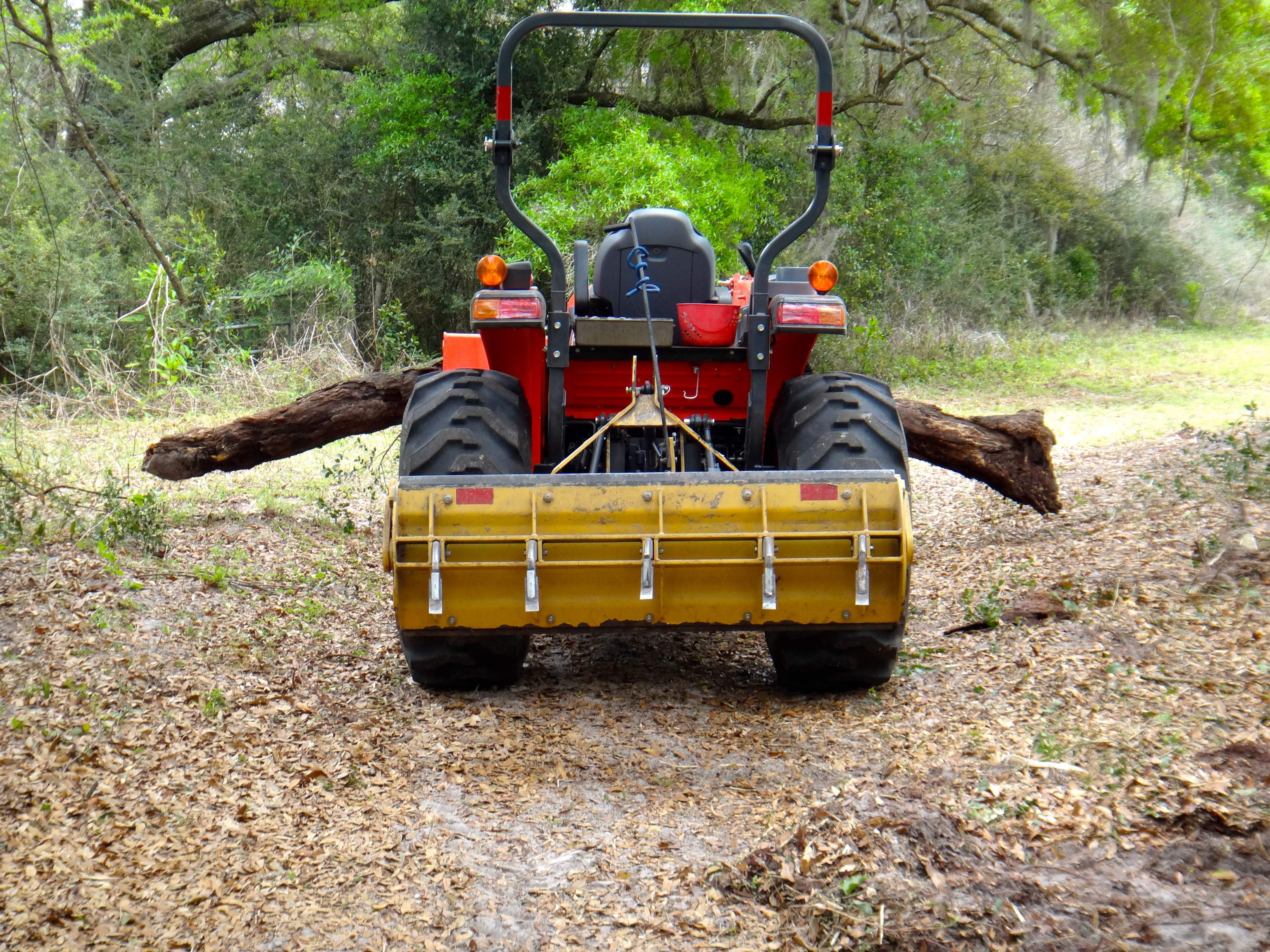

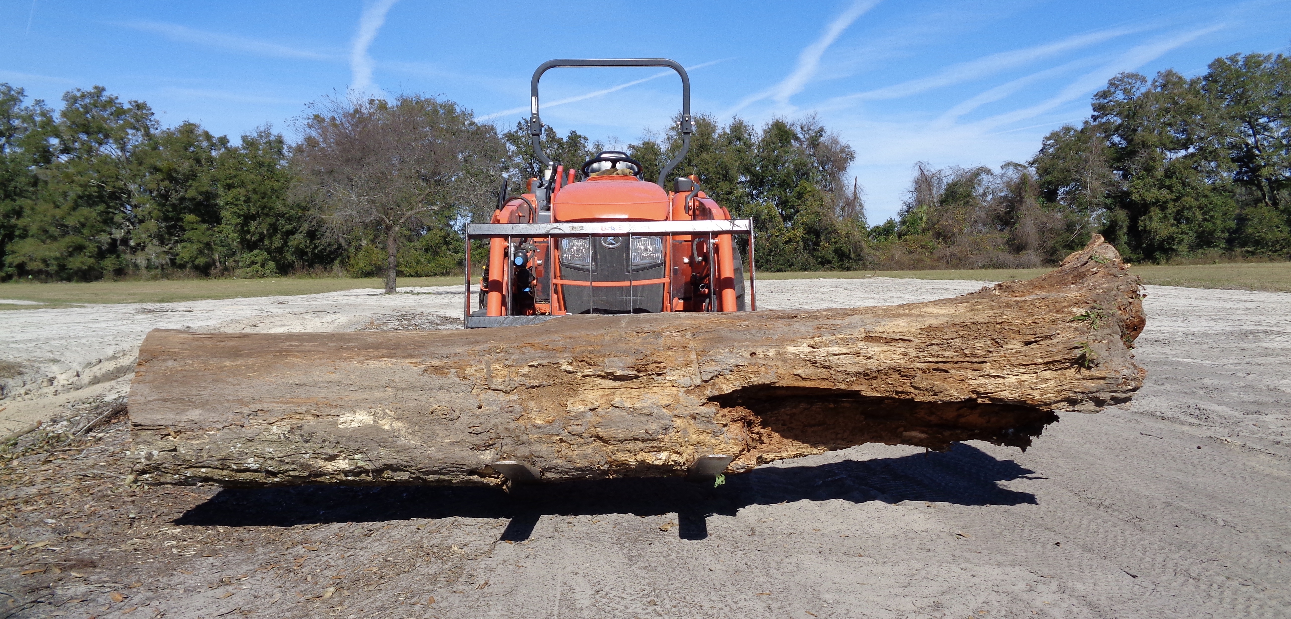

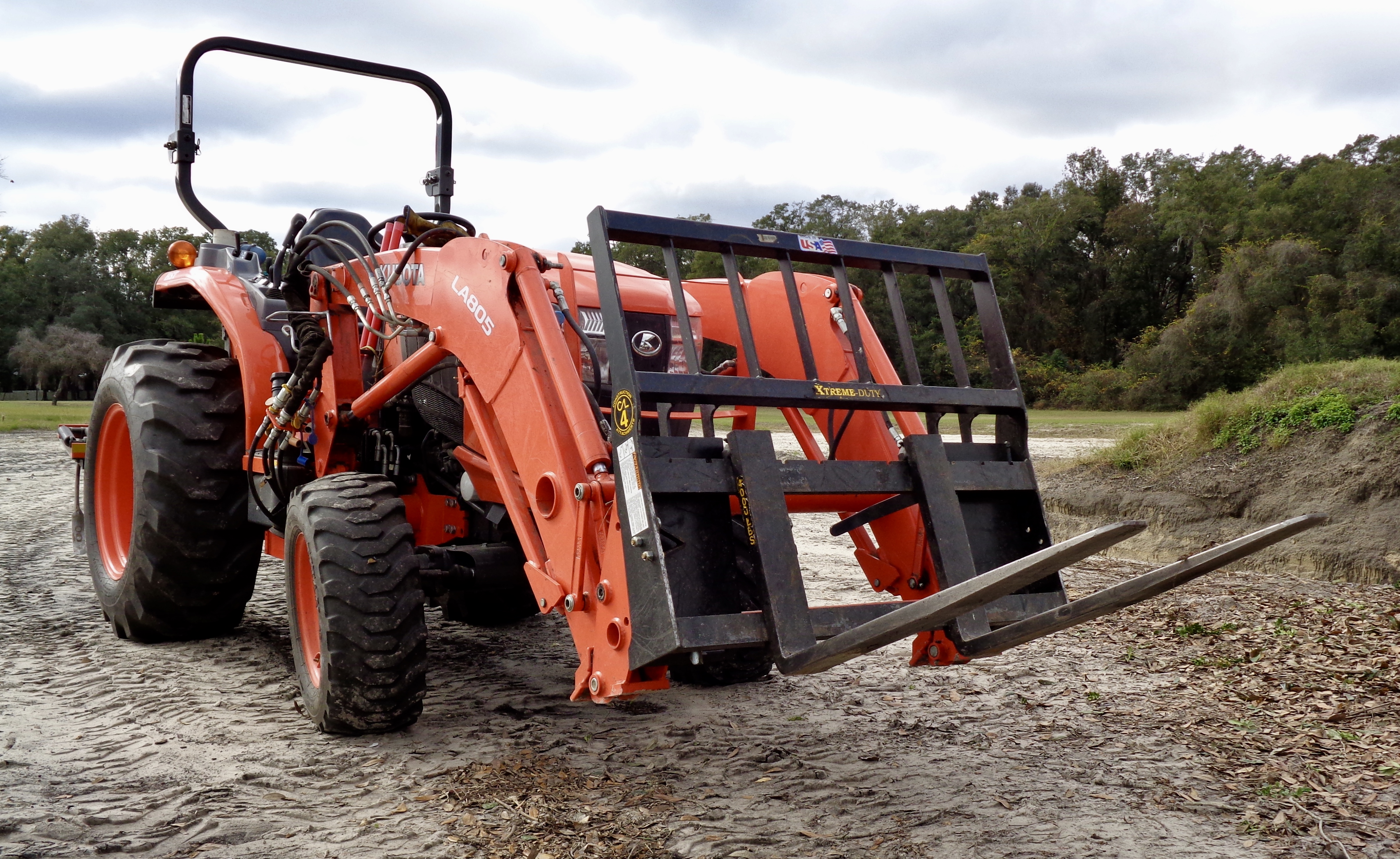

TractorData.com shows bare tractor weight of Branson 4225H as 4,153 pounds, for practical purposes identical to Kubota L4060.
The weight of the Branson Loader must be significantly heavier than the Kubota LA805, which is 1,279 pounds. It takes more steel to support incremental 1,000 pounds lift capacity.
This may be good or bad for your applications.
A factory Backhoe is always sufficient counterbalance.
The Branson would be superior if you need to unload fully laden pallets from a truck. Fully laden pallets sometimes weigh 2,000 pounds.
Kubota shows struck capacity of R-B, H-D bucket as 10.9 cu ft.
Kubota shows heaped capacity of R-B, H-D bucket as 13.1 cu ft.
If repetitive loader work is your key metric, do not discount how productivity enhancing the Grand L HST+ transmission is.

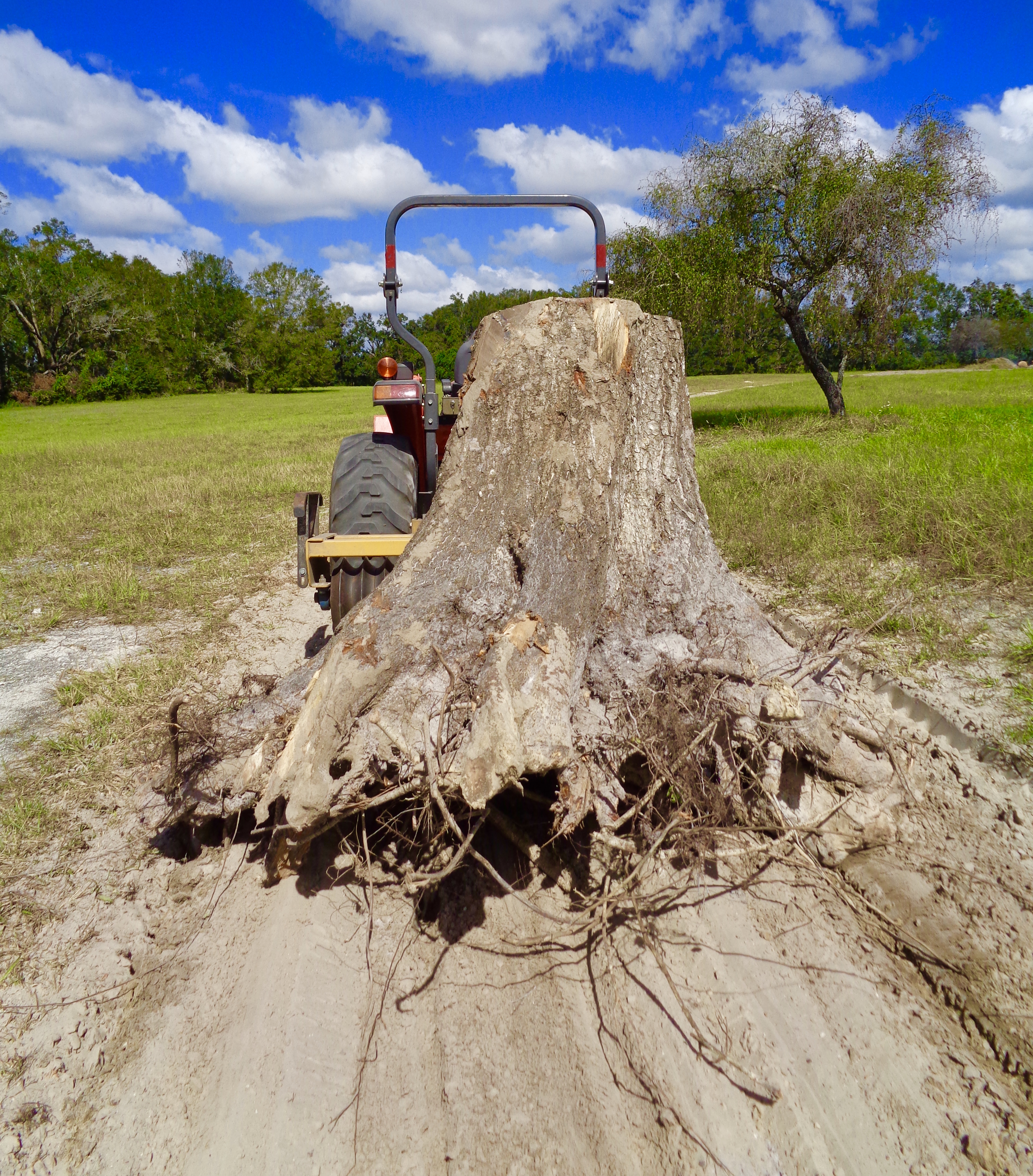

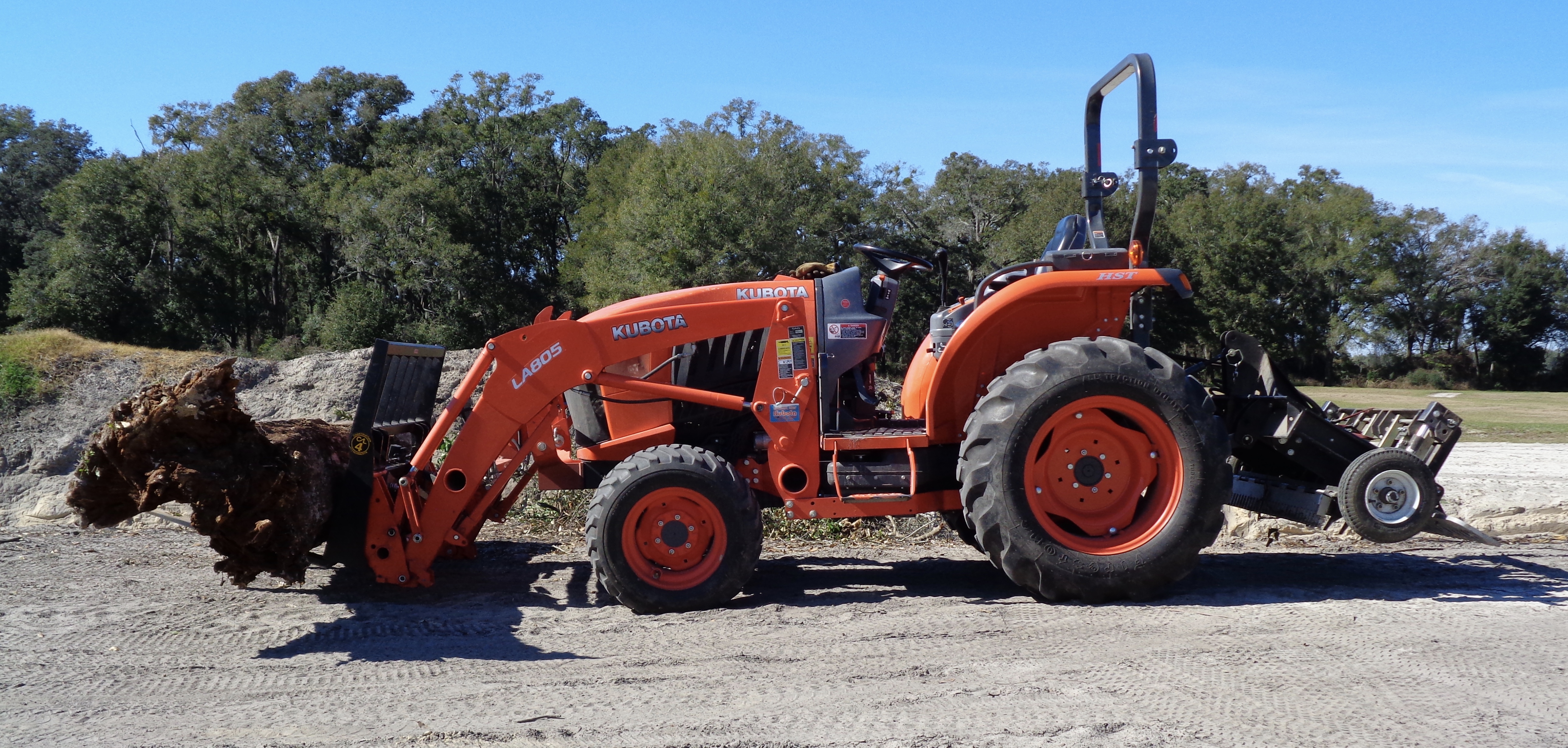

I move a lot of Oak tree trunks on SSQA pallet forks, not a grapple.

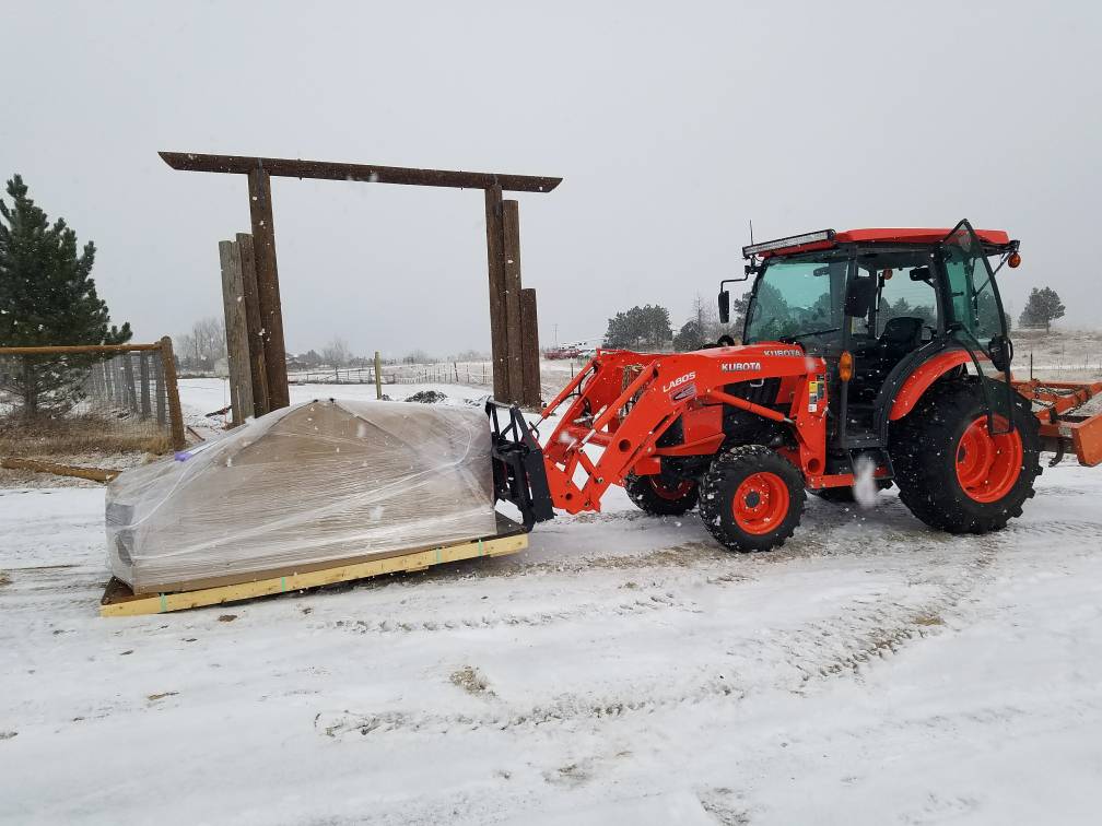

My L4060 couldnt quite lift a pallet (my flail mower which was suppose to weight 1,700lbs bare) labeled as 1,910lbs. I pulled off the PTO shaft & some plastic then could lift it a foot. Probably 250lbs of pallet forks on there too.
With loaded rear tires & a light or no rear ballast my L4060 felt way more stable than my L3200 with loaded rears & maximum rear ballast.
I would have liked to be able to afford a L4760 or bigger to get the big loader in addition to the extra HP. The medium loader is decent, but weak compared to the tractor weight. My L3200 could lift the rear off the ground with lots of ballast. There is a weak spot in every system. Ballast on the L3200, hydraulics or possibly front axle on the L4060.
   / L805/L4060 real life lifting capacity #13
And found a photo... failed to lift that pallet rotated 90 degrees along the wide side with the weight closer too. Pushed the pallet up to the shop an inch or so off the ground.20171221_125820.jpeg

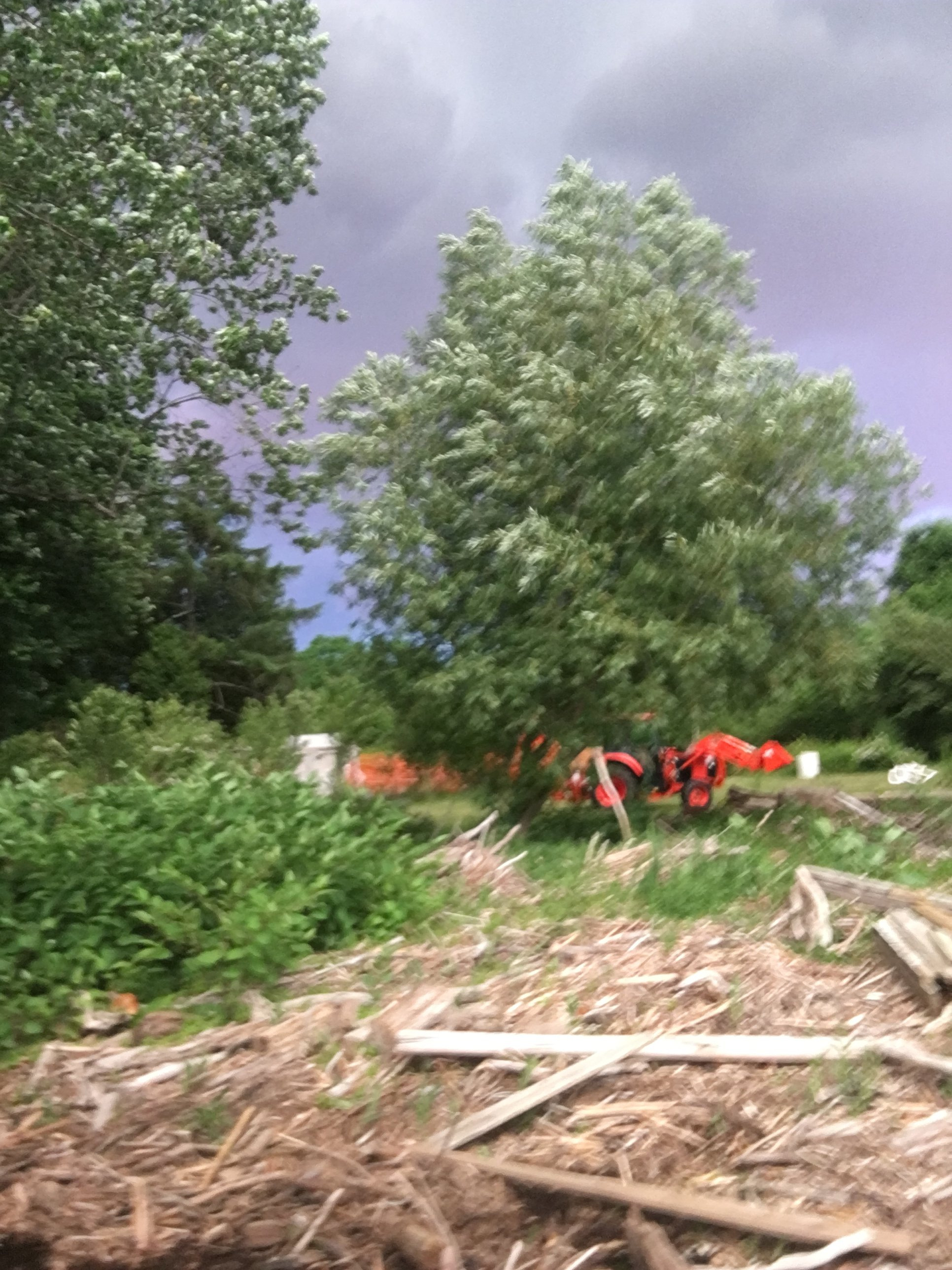

Been there, done that...
I was lucky to have decided on a bit bigger tractor on the first trip around (where many first timers have under estimated their inevitable and eventually growing needs) with the L3650 Grand L with LA805 and BH92 over the LX or L2501 (or larger HP in those same basic frame sizes).
Every season I will clear dead wood, (blown in trees) from the lake that fronts the property. (I didn't think being downwind would be all that bad, but it truly is a working mans shoreline !!)
Some of this stuff is massive, and water logged. 20ft or more long and some 24" or more in diameter. I can pull these out of the water or along the beach with the Land Pride 72" Grapple (SGC15), and then to shore where I can lift (maybe only one end at a time if they are too massive or intertwined with other trees), cut them into smaller pieces, and then get them relocated.
I've had years where the debris field that's been blown in along the bank is 3ft to 4ft deep and 20 feet out along a 100 to 200ft shoreline. I used to clear this with brute force, a pickup truck with a plow, and towing the logs out with a work boat.
That took effort and time, dependent on the water level and how far the debris field is pushed inland.
