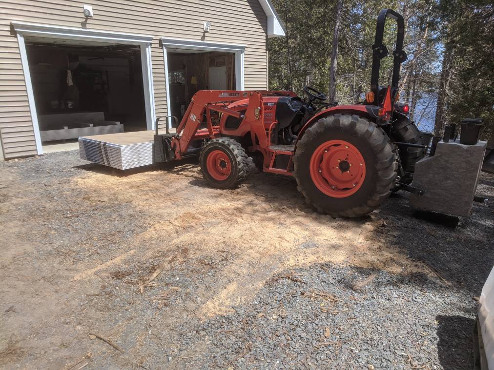

I am very very happy with my Kioti but there are a couple of areas where Kioti (the company) is disappointing. First, they will not post their manuals and documentation as PDFs. It's 2020 already. Second, is the subject of this post...Kioti does not share useful loader lift specs such as a graph of lift capacity 500mm beyond pins. The only thing they quote is at the pins. Who lifts at the pins? How much can my 2660lb capacity loader actually lift?
For Kioti owners it becomes a trial and error thing. Will I actually be able to unload that delivery that is coming this afternoon?!? In my case the answer was no. I was receiving a load of sheetrock and each "lift" was 40 sheets@1800lbs, well below the quoted 2660 at the pins at max height. The truck bed was about 4' high and the top lift was 2' above that (6'/1.8m). I could raise the 1800lbs at 6 feet (and rear tires stayed on the ground), but could not curl the forks to keep the load level. We had to reduce the number of sheets.
To be fair, I will admit and agree that most of the time I have no idea how much the load weighs so it is a case of "let's just try it". With my tractor and forks, I am excited to now be able to rank firewood on pallets so I can move it around and reduce the number of times firewood heats me up . How big a pile can I lift? The IBC tote full of very green maple was not problem. I calculated the load to be 1/3 of a cord and with a useful shared chart (Kioti, if you are reading, it was a PDF ;-), I estimate the load to be 1500lbs. I thought about raising it to 6' and trying to curl, but I did not want firewood on my hood and lap!!
Beyond my rant, is 1800lbs a reasonable maximum at 6 feet for a 2660lb capacity loader. Does anyone else have good examples of hitting the maximum? Here is a photo of my 30 sheets and firewood seasoning in the sun.

Thanks for the great thoughts and comments so far. To respond in no particular order... The HLA4248 pallet forks weigh 425lbs. The truck was up on the main driveway so my front wheels were elevated and the forks were effectively pointed downward to be level to the load. The act of backing down to level ground caused the load to be angled downward. Had I lowered the load further with that angle, I would have likely lost a few sheets. I did not think to consider resting the fork tips on the deck.
I had assumed that the quoted lift capacity included the bucket so I was just dealing with the weight difference between the bucket and forks. If not, then 1800+425 is approaching the max.
I still have more than 40 sheets in the garage so maybe I'll experiment with 1800lbs closer to the ground and report back.

As follow up...Today I experimented lifting sheetrock/drywall. I reviewed the specs on the drywall and it can weigh between 40 and 45 lbs per sheet. It is marketed as easi-lite but I expect that most days it comes off the production line on the heavy side (45lbs). The KL5510 loader is rated at 2660lbs at the pins. The sheets are 4x8 so the load averages 2 feet beyond the pins.
I was able to lift 44 sheets estimated between 1760 + forks (425) = 2185lbs and 1975lbs + forks = 2400lbs. I could not curl that load. I was able to curl 36 sheets - between 1865lb and 2045lb total..2 feet out. I was lifting about 2 feet off the ground at full throttle for max. hydraulic pressure.
I am satisfied that all is working well or at least well enough. I do not plan to work with that kind of load on a very regular basis. I should note that the approx. 1300lb counterweight and 880lbs in the tires kept the rear end on the ground. I did not hit the load dead centre so I did notice one rear tire get light. 1500lb or 1600 lb counterweight may have been a better choice if I was building another counterweight, but 1300 lets me know when I am hitting the limits. Any further analysis will be done from the seat and pucker factor!

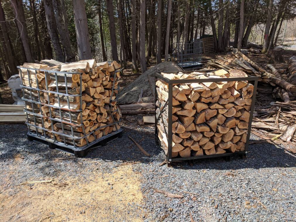

I am very very happy with my Kioti but Here is a photo of my 30 sheets and firewood seasoning in the sun.
View attachment 656648View attachment 656649
The rack/pallet on the right (as we look at it), is that homemade - looks like a heavier gauge metal - could be a good use for all the old bed-frame rails I have been collecting!!
/ Kioti loader actual lift capacity
#20
Actually that is the shipping frame that was around my WC68 6″ PTO Wood Chipper, PTO Wood Chipper | Woodland Mills Canada
I cut off the cross members at the front to allow easy loading. It is smaller than the IBC frame beside it. A bed frame would be plenty strong as well. My next one will be a hardwood pallet with some 2x4 framing.
