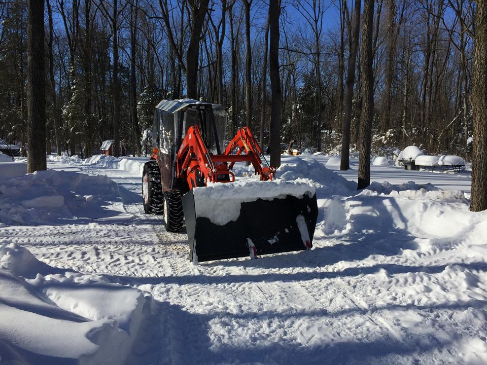

LD-1, these are the buckets I use most often (in addition to forks), thus the 19.5" isn't too meaningful to me... I don't think the stock bucket has even been on the tractor in the past year!

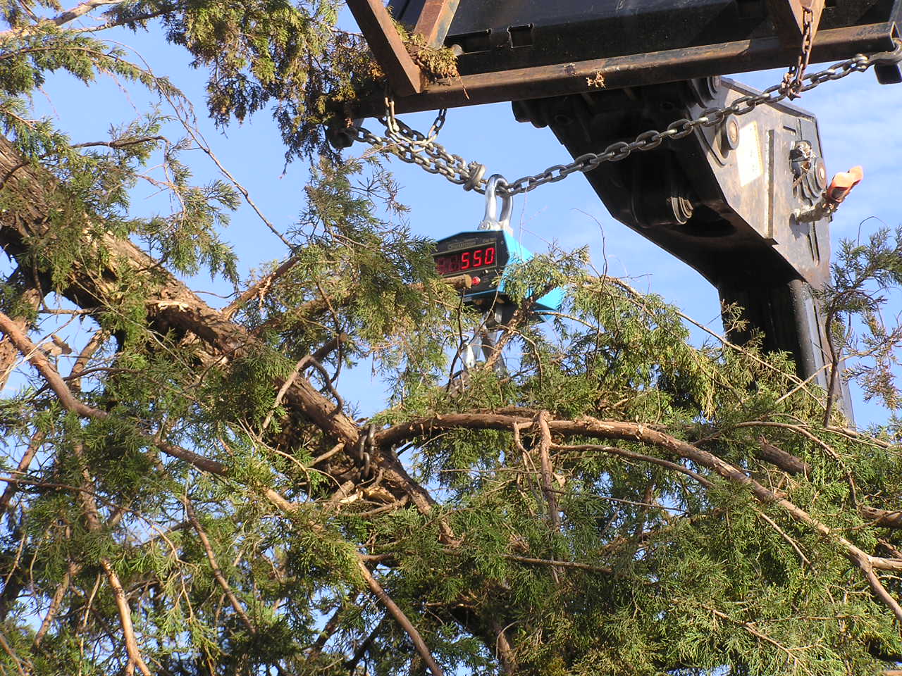

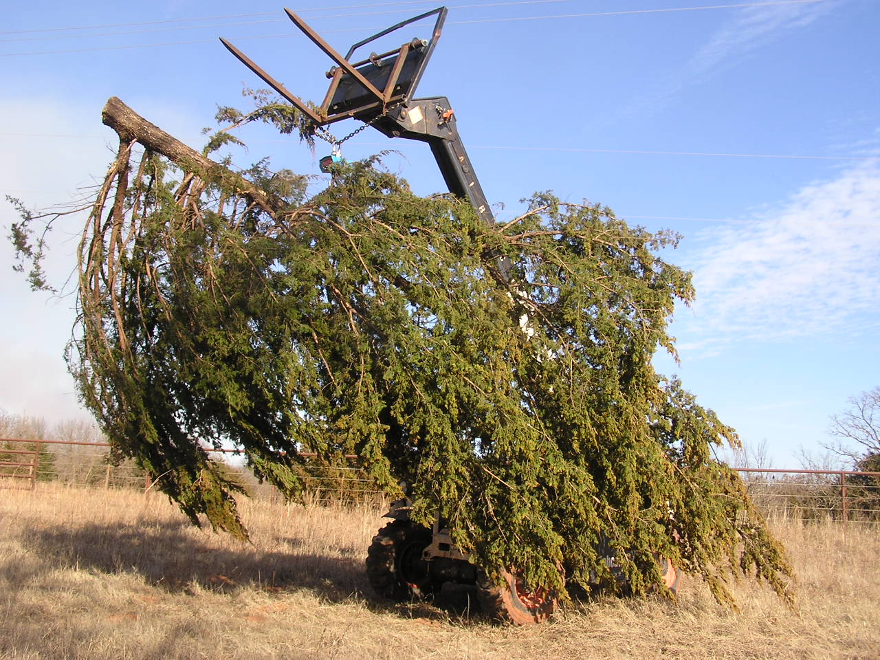

I have a project coming up where I'm going to use a boom pole. So I really want to understand the forces involved and what the tractor can handle before using the boom pole. Since some of the things I need to lift with the boom pole are of unknown weight, I've ordered a 1,100 pound hanging scale with hooks top and bottom so that I have an idea what I'm getting into before I get into it.
Don't worry, have a separate spread sheet to figure out ballast needs. In addition to the 1000 pounds of fill in the tires, the cage and me, all of which = about 1,500 extra pounds on the rear. I plan to put 1,700 pounds on the 3pt and most of that weight will be inches from the ground.
   / Calculating FEL Lift Capacity #68

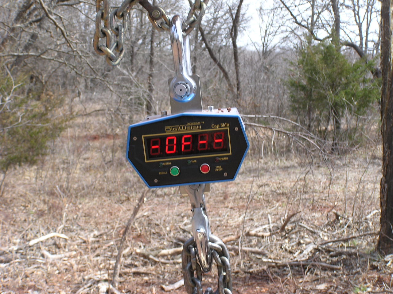

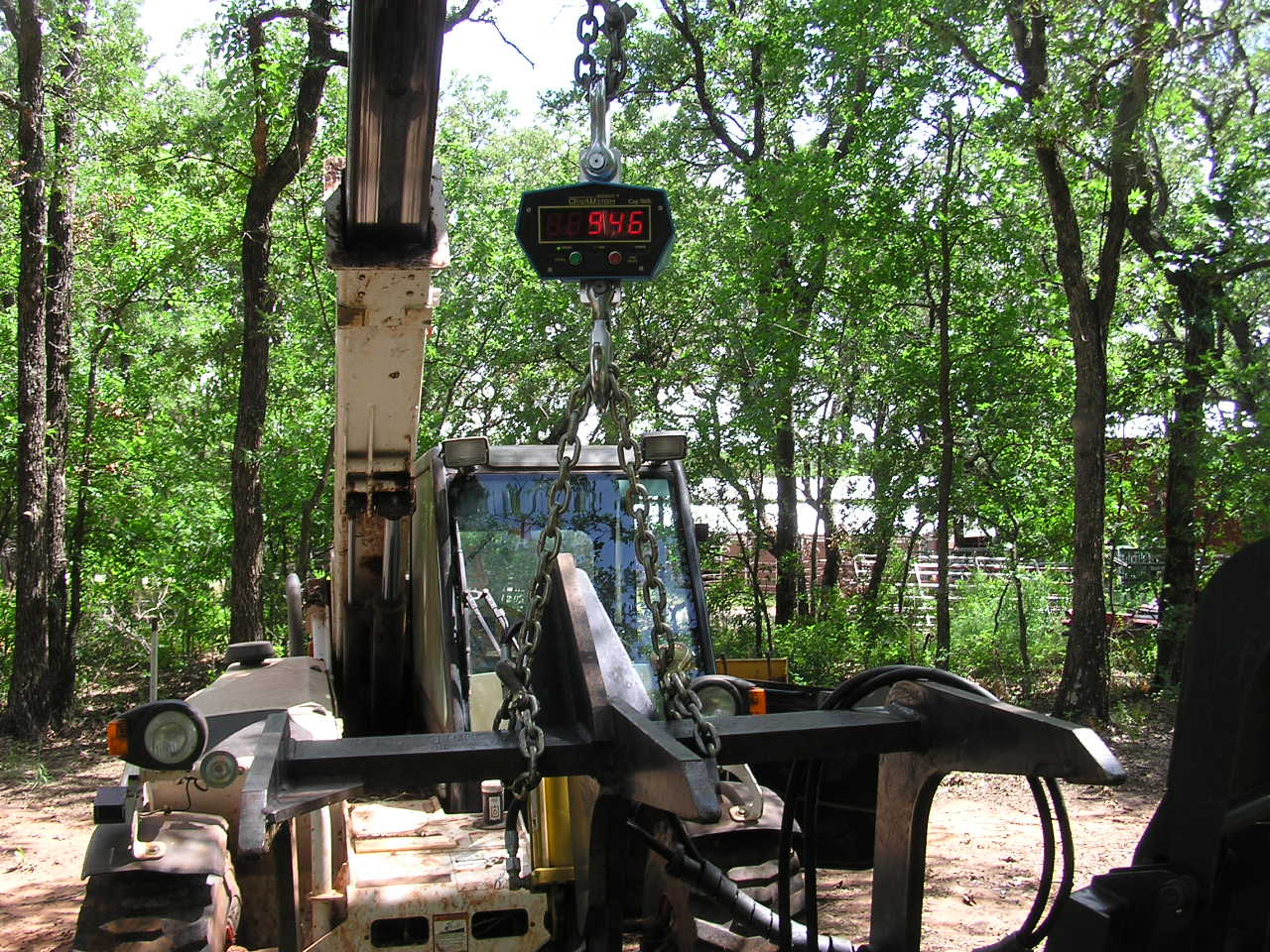

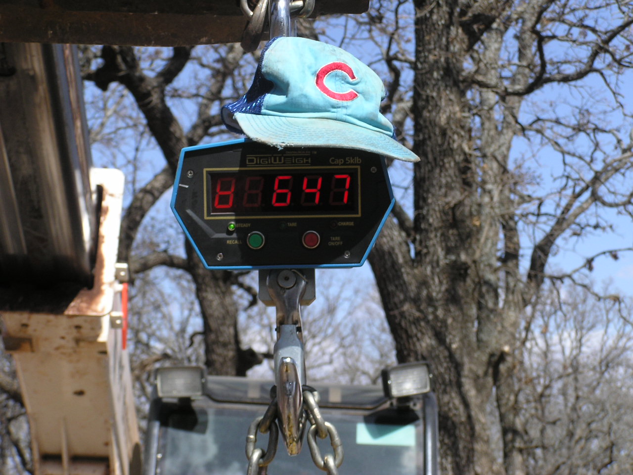

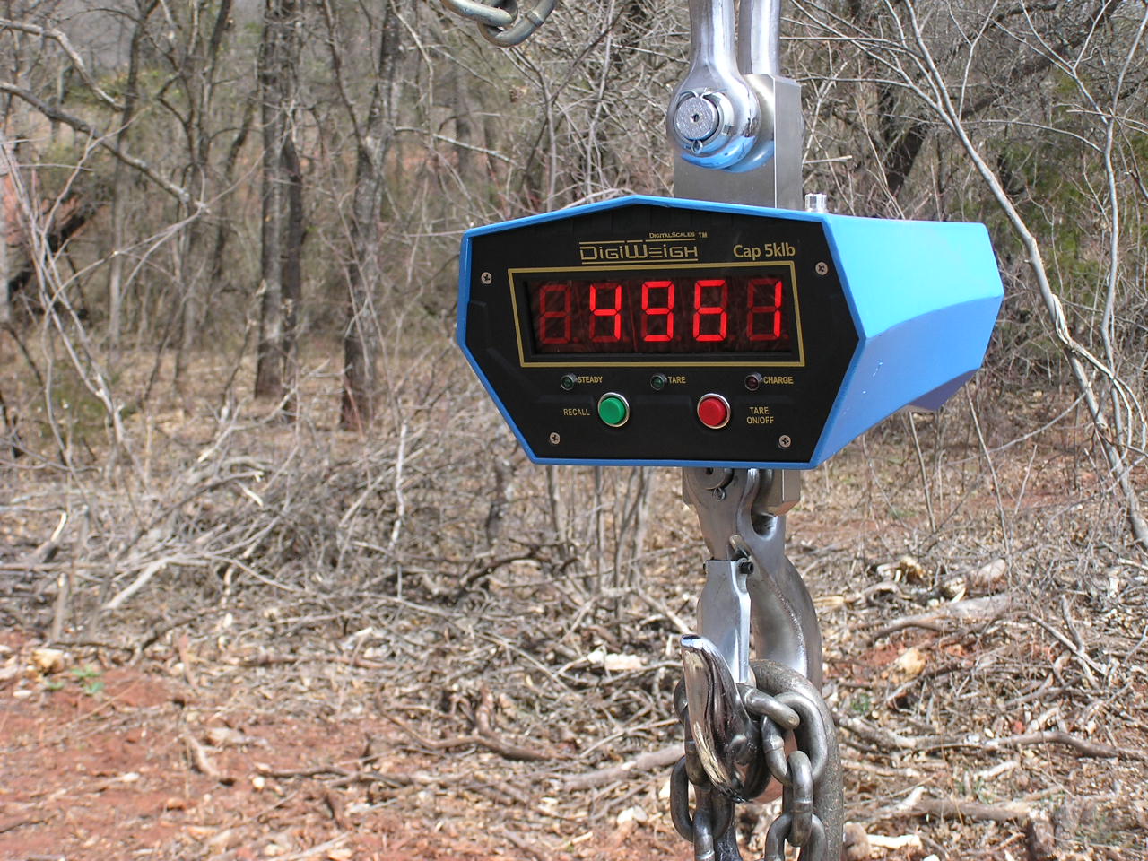

I predict that you will wish you had ordered a higher capacity scale.
My loader lift was rated at 4,400 pounds so I ordered a 5,000 pound scale, not enough, OF means Overflow.
More pictures:http://www.tractorbynet.com/forums/...quipment/275747-v417-max-lift.html?highlight=
It does get used a lot for weighing things. :thumbsup:
