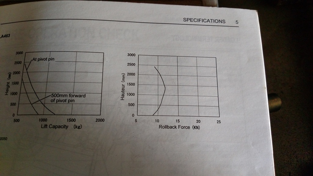

LD-1 - would still appreciate if you could post the roll back force graph that you have for your Kubota!
Sorry for the delay. Been a busy last few days
Here is what a typical loader force curve looks like. 1 KN = 225#
I have a project coming up where I'm going to use a boom pole. So I really want to understand the forces involved and what the tractor can handle before using the boom pole. Since some of the things I need to lift with the boom pole are of unknown weight, I've ordered a 1,100 pound hanging scale with hooks top and bottom so that I have an idea what I'm getting into before I get into it.
Don't worry, have a separate spread sheet to figure out ballast needs. In addition to the 1000 pounds of fill in the tires, the cage and me, all of which = about 1,500 extra pounds on the rear. I plan to put 1,700 pounds on the 3pt and most of that weight will be inches from the ground.
Most modern loaders have a stronger curl force than lift force at/around the bucket edge.
But as the load is moved forward.....the curl strength drops off much quicker than lift force. Usually to the point that they are about equal at the tip of 48" forks.
A boom pole, say 8 or 10' long on the loader......you are gonna find that your curl force is weaker than the loader lift cylinders.
Thus the scale. at 10ft past the pins, my lift cylinders will lift more than twice what my curl cylinders will lift. Don't want to pop a cylinder!:shocked:

You really should bet a gauge, attach it to a tee, and a pair of QD fittings. Insert it inline with the curl cylinders so you can monitor the pressure those cylinders are seeing while lifting with the lift cylinders.
I have a gauge that I can move to any port on my loader. IT normally spends its time on the lift circuit.....with a little math on the fly, I can get a pretty rough estimation of how heavy something is I am lifting. But with the QD's and Tee, its easy to put it on any of the 4 circuits.
When I had my L3400, I attached a make-shift 15' boom to the loader bucket to lift, and set trusses on the shop I built at my old house. The trusses were only ~200#, and I couldnt curl them at all. But lift was no problem.
