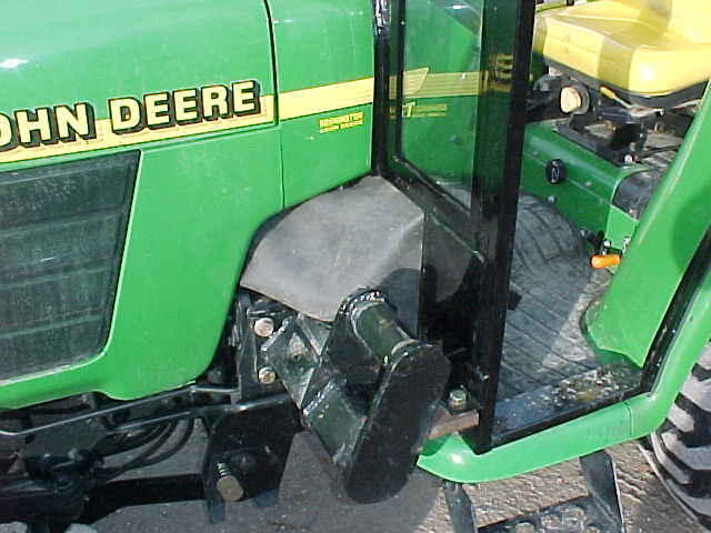

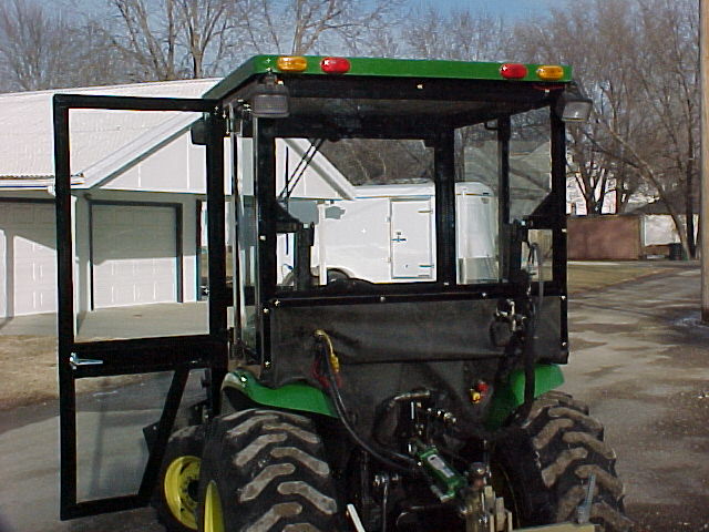

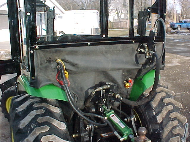

The black canvas came off of a rail road car, they call it a airbag. I got a leaker and used both sides of it, it is about 1/6" rubber. cuts easy, but strong. If needed I can try to get more.
Lets see- Plans umm. I did not have any, I just started and dreamed alot (day & night ).
Thanks I am very proud of it.
I took the back off and put the hoe on after work. plenty of room

Great job on your cab. You went to a lot more expense than I did on mine. If you didn't read one of my prev. posts, I stated that Northern Tool has a cab heater that connects to the engine just like a cars heater hoses do.

Great looking cab. Well done and thoiught out. Question; How is it secured to the tractor?

Question for you - did you get tempered glass all round, and if so, how do they cut the shapes? You can't cut tempered, can you? Also, is the glue-on method all you used (no screws, retainers, etc.), and how is it holding up?

glass ....
plexyglass? ploycarbiate? or regular DS safty glass?
btw do you have a rhino FEL?
/ Cab in progress #51
i personaly would go with what is called tractor glass my father owns a skid steer and he tried plexiglass it cracks in winter and it attracts alot of dust. tractor glass spiders but wont break. my fathers skid steer has runn two years with a hole in on of the windows that he made. a cut off tree limb went through the side stopping just short of his head. all we had to do was just lightly push the glass back in place and it has stayed in place ever since.
thats what i suggest really neat glass it has layers of plastic integrated into the glass to keep it from completly shattering.
