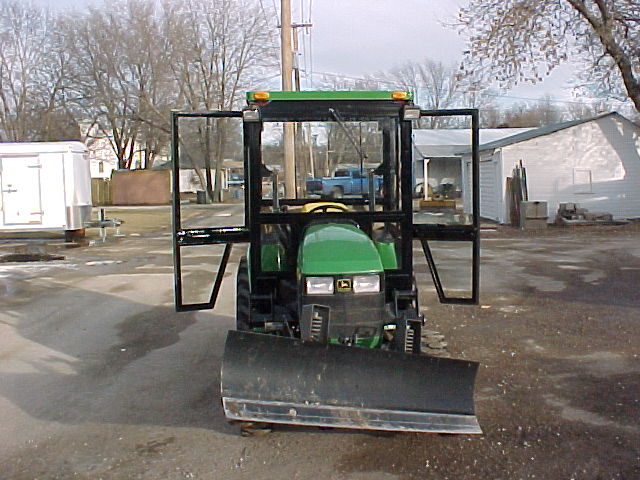

Cab in progress
/ Cab in progress
#21

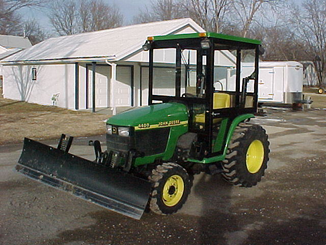

/ Cab in progress
#22

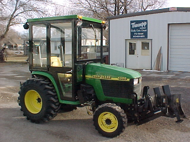

/ Cab in progress
#23
last one
/ Cab in progress #24
Very nice, thanks for sharing!
/ Cab in progress #26
Very nice job, looks professional to me. Wish I could fabricate like that.
/ Cab in progress #27
Not sure what you have left to "complete", but it looks awesome! Great Job!

MAN THAT LOOKS GREAT!!!
/ Cab in progress
#35
THANKS for all the kind words! I am tickled beyoud words.
I just got done putting in 1" thick foam for cabs. I put on the ceiling, what a difference. I think I will be able to stand the noise level now, so maybe I won't worry about a heater. I have alot of money in this cab.
Someone asked about if it was a roll over cab. I think it is as strong as the rops but still would not just my life with ethier one. When I get the price tag added up I will pass it on.
DDT

I got all my totals in:
steel $265.00
ww wiper $204.12
foam for doors,fender ect $24.47
glass,caulking,installed $365.63
foam & glue for ceiling $51.23
door handels,lights,wireing ect $176.96
a grand total $1087.41
