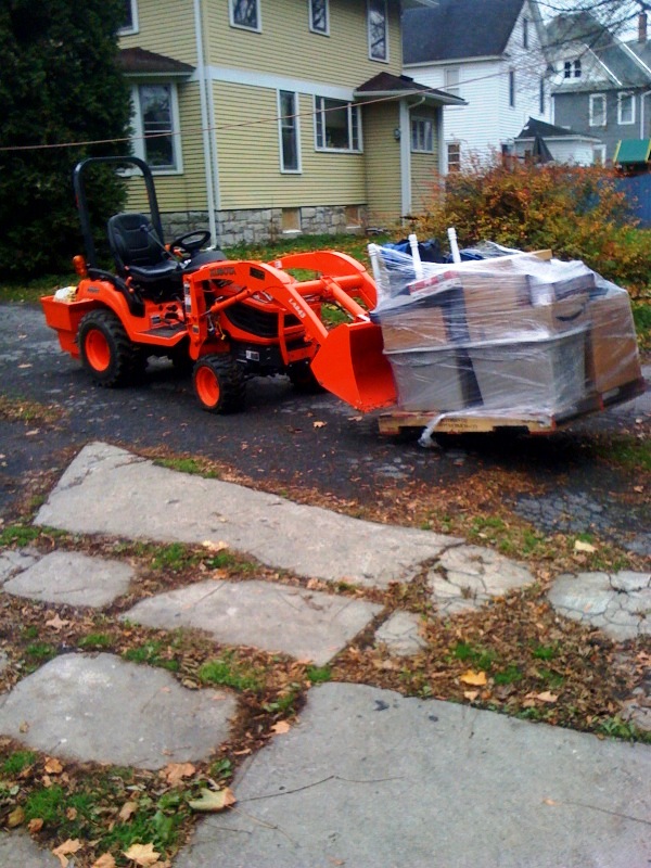

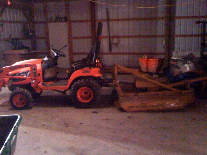

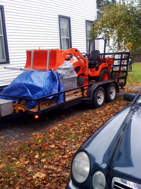

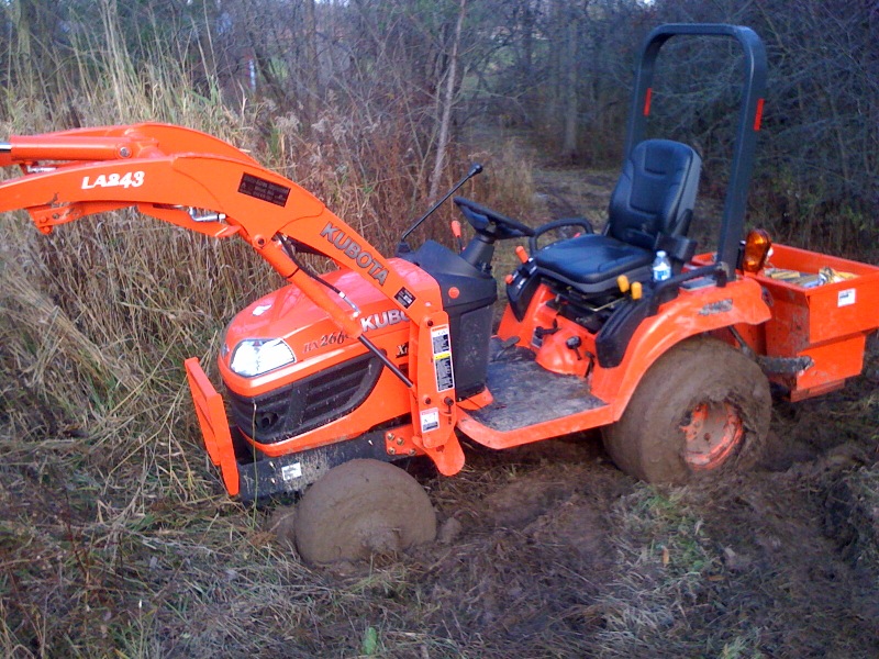

After putting about 18 hours on my new tractor, im really starting to see how much of a jack of all trades tool it is! We just moved into a new house and has made the move easy. Clearing and cleaning up the new property (8 acres) was an absolute pleasure to do with this tractor. Now I only wish there was more. enjoy the pics. By the way, what is the best rotary cutter to get for this, size wise? I borrowed a friends 60" woods, and it was a little big and clunky to carry around. Needed the FEL for front ballast otherwise the front wheels wouldnt turn. The tractor handled it like a champ cutting our back lot down, not so much as a hiccup. 42" or 48"? How about a 54". I would like to go woods or landpride. Any suggestions?

I see you wasted no time in using your BX! congrats on your new home for your BX. I se you also wasted no time in testing the r4s in how well it gets stuck! lol! So you liked the bxpanded forks ?
kidding aside- I am surprised you manged to use a 5 foot bush hog with no problem. They do have a 48 incher hog at TSC. If you plan on using it often to keep feilds down- perhaps a 5' RFM would be a better choice since it less clunky in the back.

The R4 tires are good in the muck, until the treads load up with mudd, then forget about it. I had to use the loader to push me out. The less weight you have on it, the less chance you will get stuck. I went over that same spot without the ballast box and it went through fine.
The 48" at TSC I believe is a KingKutter. Maybe I could bargain with them for one thats been sitting in the rain for the last year. What is the general consensus for "safe" max width for a bush hog?
The RFM I think might get pretty beat up in our back field. Its not all smooth, with many ruts. I also like the ability to run over small trees and sticks, etc.
The BXpanded forks are great! They really are top quality, fit and finish wise. My only gripe is that they put the weight so far forward, you are limited to a lesser weight than the loader can actually handle. And, you NEED a ballast, even for the most minute load. Trust me! :)
I did manage to pick up a V6 engine w/tranny out of a 2000 toyota camry strapped to a pallet and put it in my pickup. Scary, but did it.
I too was surprised it handled the 60 incher with no problem. The field was wet too!

I would go with the 42" rotary cutters that are designed for that size tractor. I have a Bush Hog SQ48 that I use on my B2620, and I personally wouldn't want more length, or weight further back than that. I actually have thought about getting a smaller one myself because of some of the tight, and steep areas I do. You would be OK with a 48" of course, but being "able" to do it, and having your machine handle it "well" are two different things to me. I see that the state DOT is using 5' rotary cutters on Grand L series Kubotas, and they mow miles, and miles of "junk" mowing. If those tractors handled 6' mowers in those conditions well, I expect that they would use them. Your mileage may vary of course, but these are my feelings.

After I got it nearly stuck up to the frame in the field, I power washed it and it looked like new again :D

1*Raceing slicks don't make good tractor tires.:rolleyes:

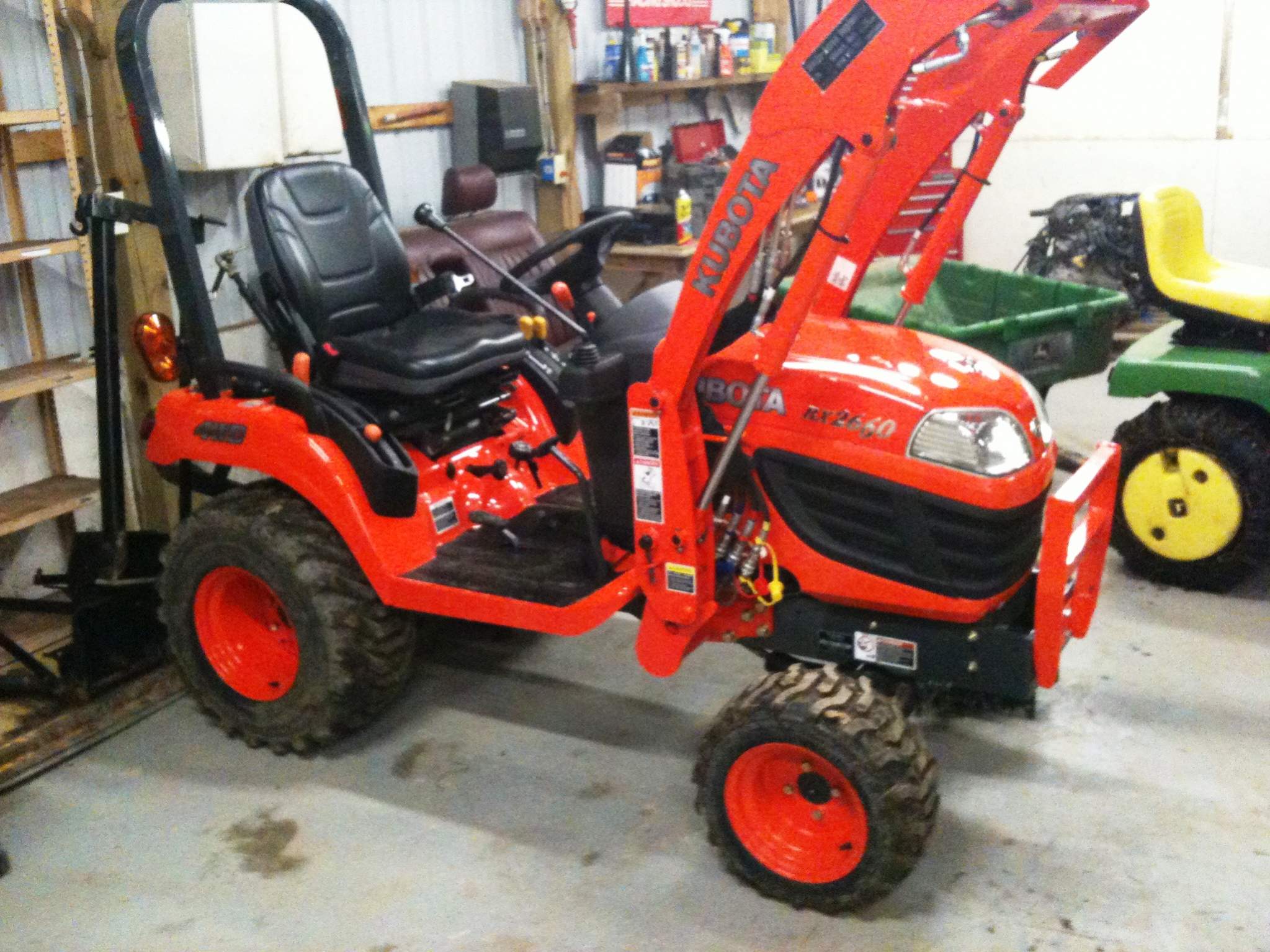

Since that last pic of my tractor buried in mud was probably disturbing to alot of you on this board, I post you this....I freshly cleaned tractor :D
