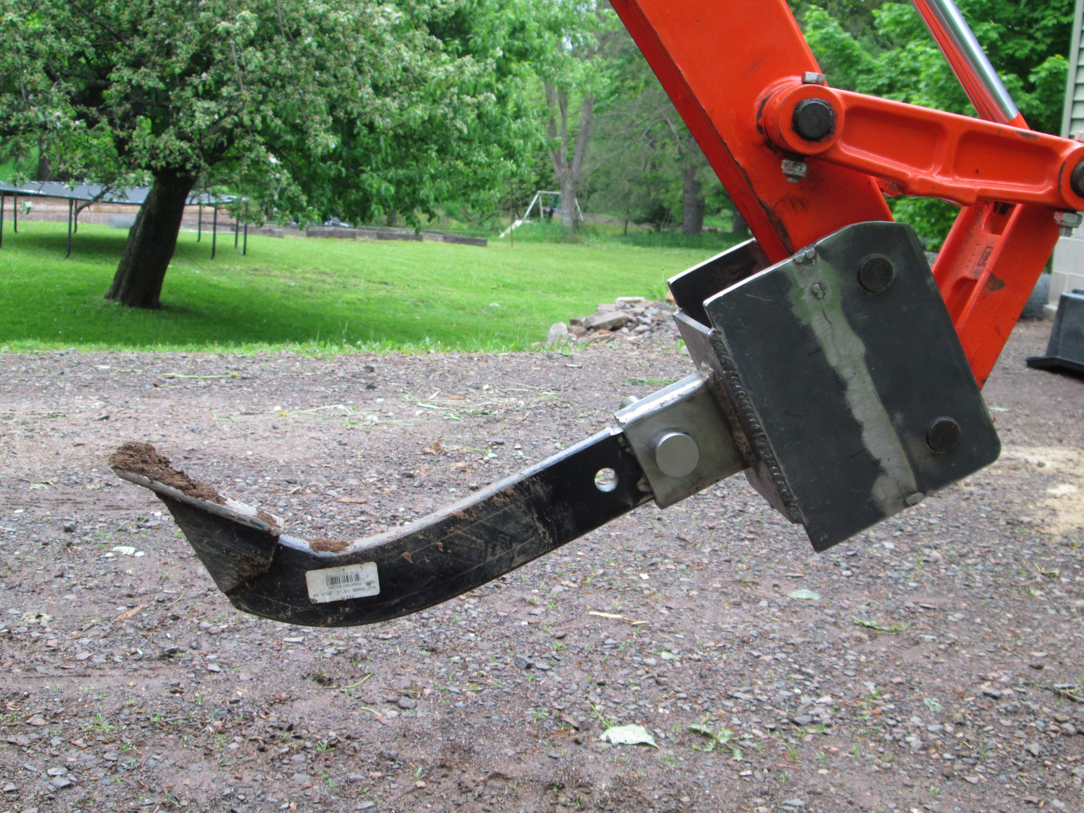

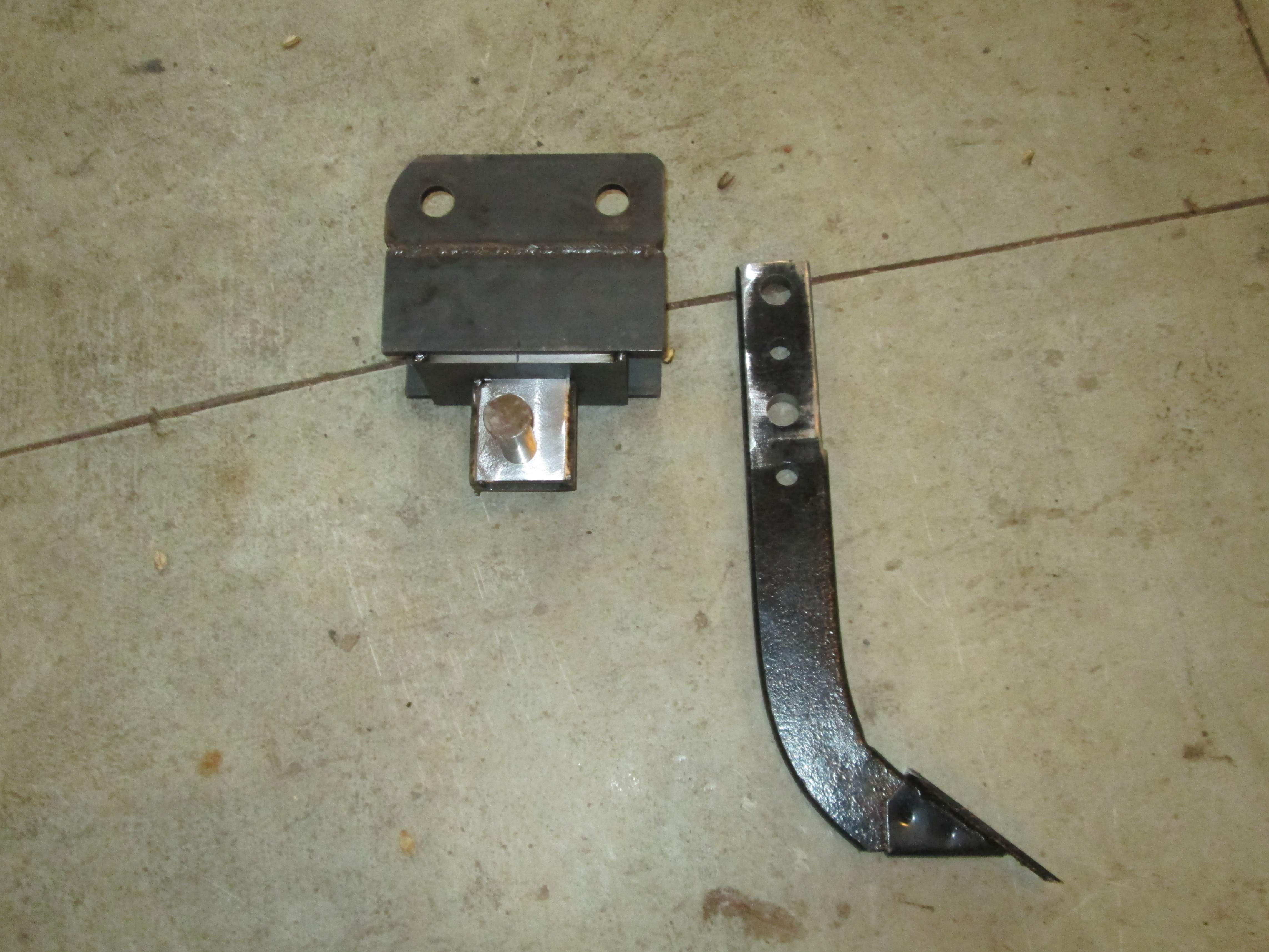

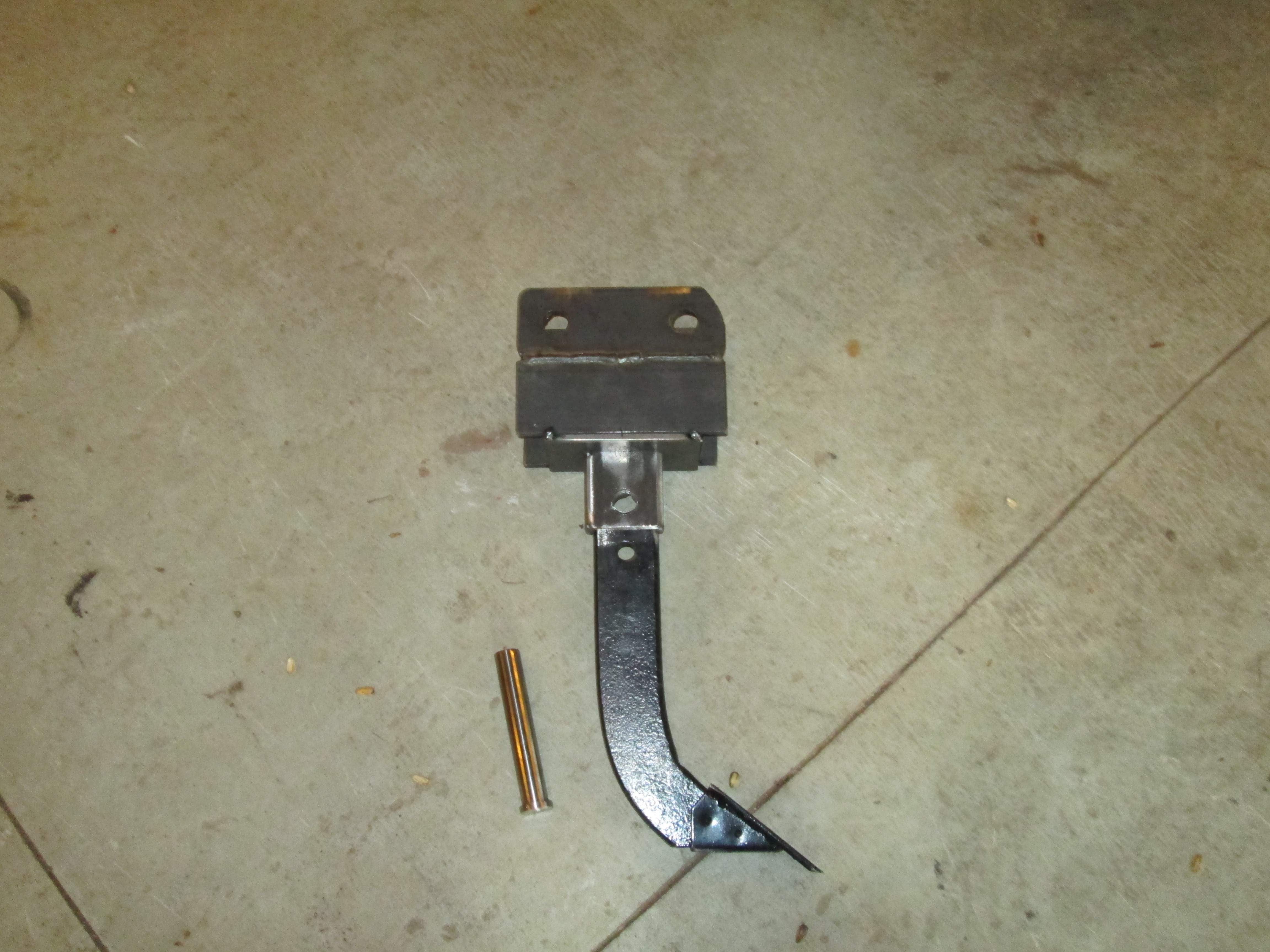

nothing like a rainy day to get me started.. and just about finished with my ripper tooth. Found the tooth at Tractor Supply, got me to thinking, cut and welded some steel together and I've got an adjustable depth ripper! needs some finish grinding, shorten the adjustment pin,and paint. The rain stopped long enough to try it on some rocks in the yard. It works great. Tooth was under $40.00 and the steel approx. $20.00. I think i am going to proof-test it a few more times before paint. What color? Black or orange?

bxbuggy; Looks good! I vote black for the color.
