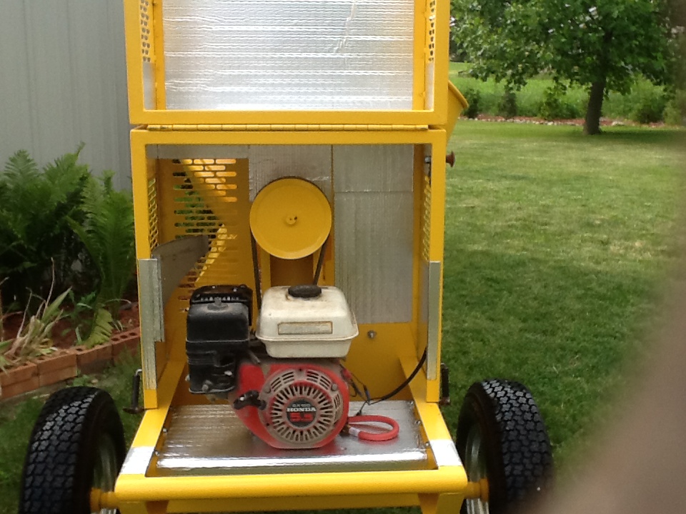

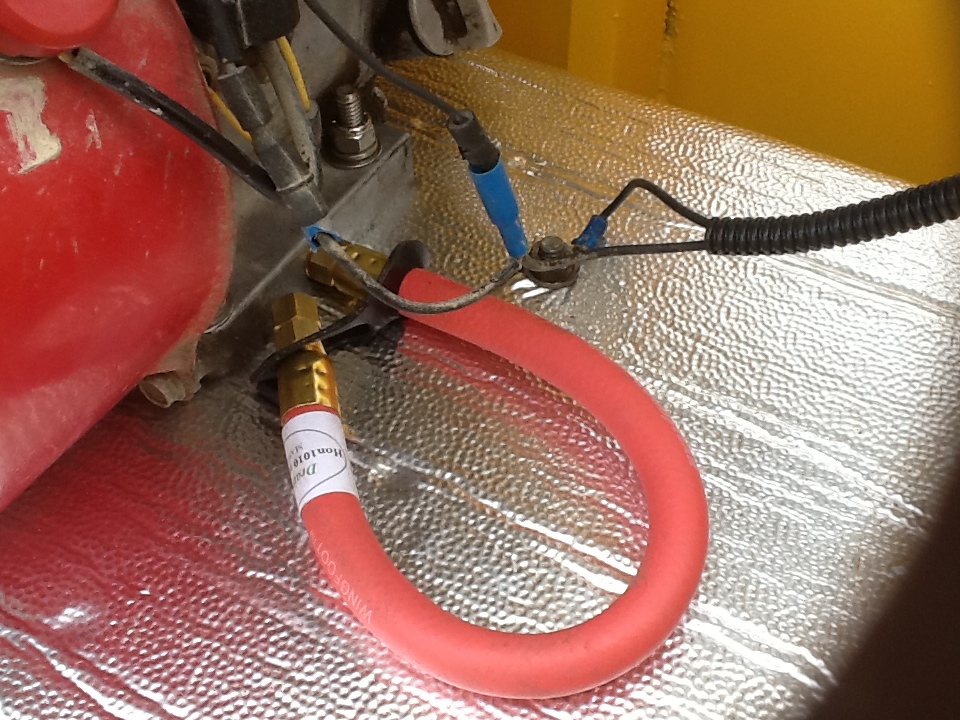

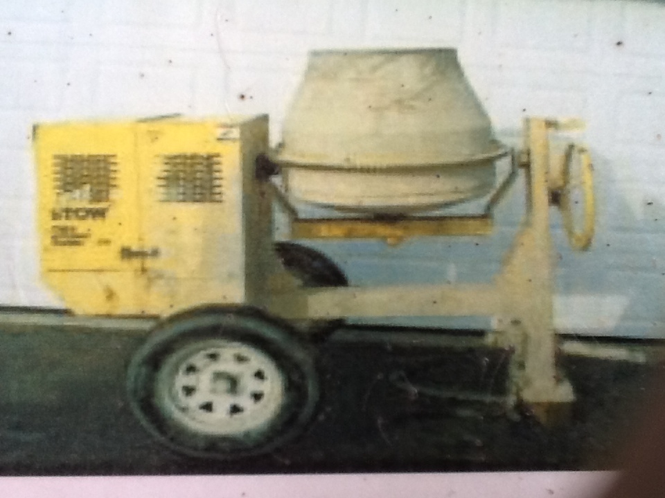

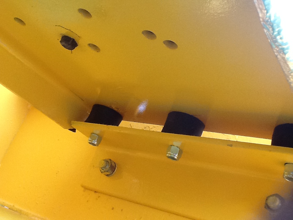

First off, not trying to Hi-Jack your thread...but...
I got done with the cement mixer.
I did just a couple MODS so far,
I added some "Flex-Clad" under the sheet metal motor enclosure, and use rubber mounts for the Honda Engine Deck. The thing wanted to vibrate itself to pieces.
I also added some rubber mounts on the engine deck. I used 6 of them, so the "belt side"is in tension, which is different than what would normally be acceptable I guess. (compression) We'll see how long they last.
I didn't shine up the Honda 5.5 (Gx160) yet, but that could easily be a "next winter"project.
I added a
"Drainzit" drain hose for oil changes, gets engine oil over the edge instead of just draining all over base plate About $20 plus shipping from Northern Tool.
If you ever have a noise or vibration problem to abate, the addition of the Flex Clad made a huge difference. Keep it in mind for our tractors. It's available from any industrial insulation supplier, if anybody needs info on it let me know.
