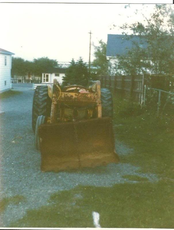

I know you love to restore things like I do so I found this photo of an old MF tractor I bought almost 30 years ago and fixed it up. It had a Perkins diesel and it was a brute. Had to split it because of oil leaks and I remember it had a crank problem but I eventually completed it.
I never had much to work with in tools or equipment back then but somehow I got it done.
Here's the photo of the day I literally dragged it home :shocked:

4shorts--Great before photo. Somewhere I have seen an after photo of that. It might have been your website or perhaps a prior post of yours but I think I've seen the after photo.
/ BX25D. Mod #1 and continued.
#1,476
You just might have. It was a sore looking thing. It was buried in a old barn for 20 years and wasn't running when I got it. I'd NEVER tackle anything like that now.

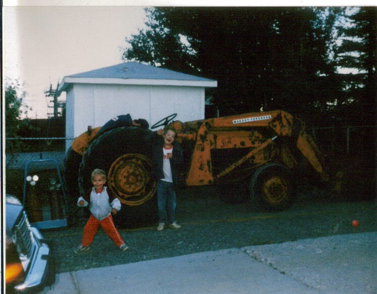

Here's another view. My two dons were so young then but then again so was I :eek:

For anyone interested I'll attach a few more photos of the old Massy project. Keep in mind that this project was 25 years ago. The two little boys in the photos are my sons who are now in the military. The only welding unit I had back then was an AC Lincoln tombstone unit. Man that thing burnt lot of rods. I built the bucket with it as seen in the photos.

4shorts--what great photos and what a youthful guy you were. The ladies must have been all over you back then, especially when you offered them a ride in your wheel loader. What a charmer.
Any more photos of the completed tractor?
