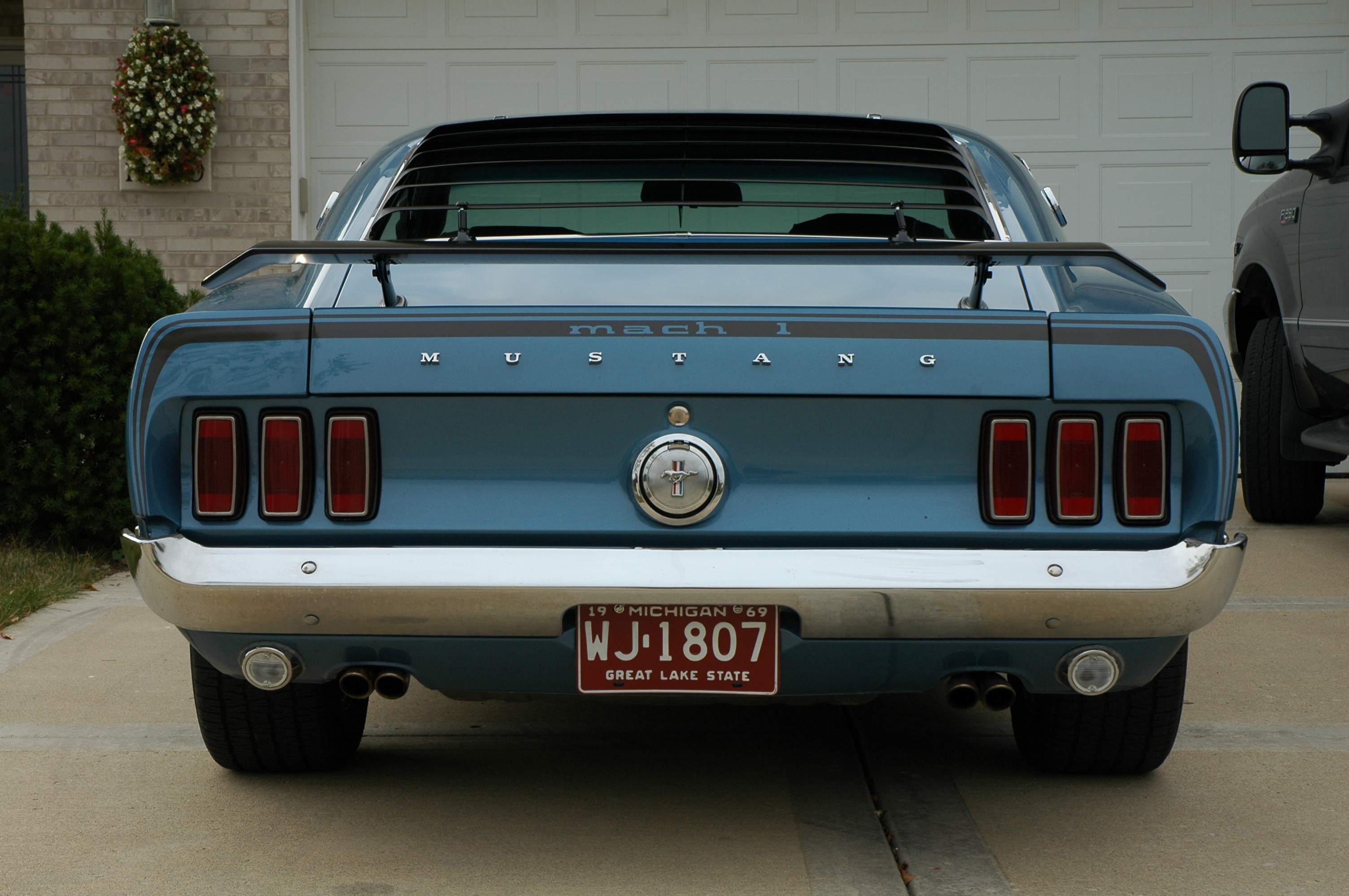

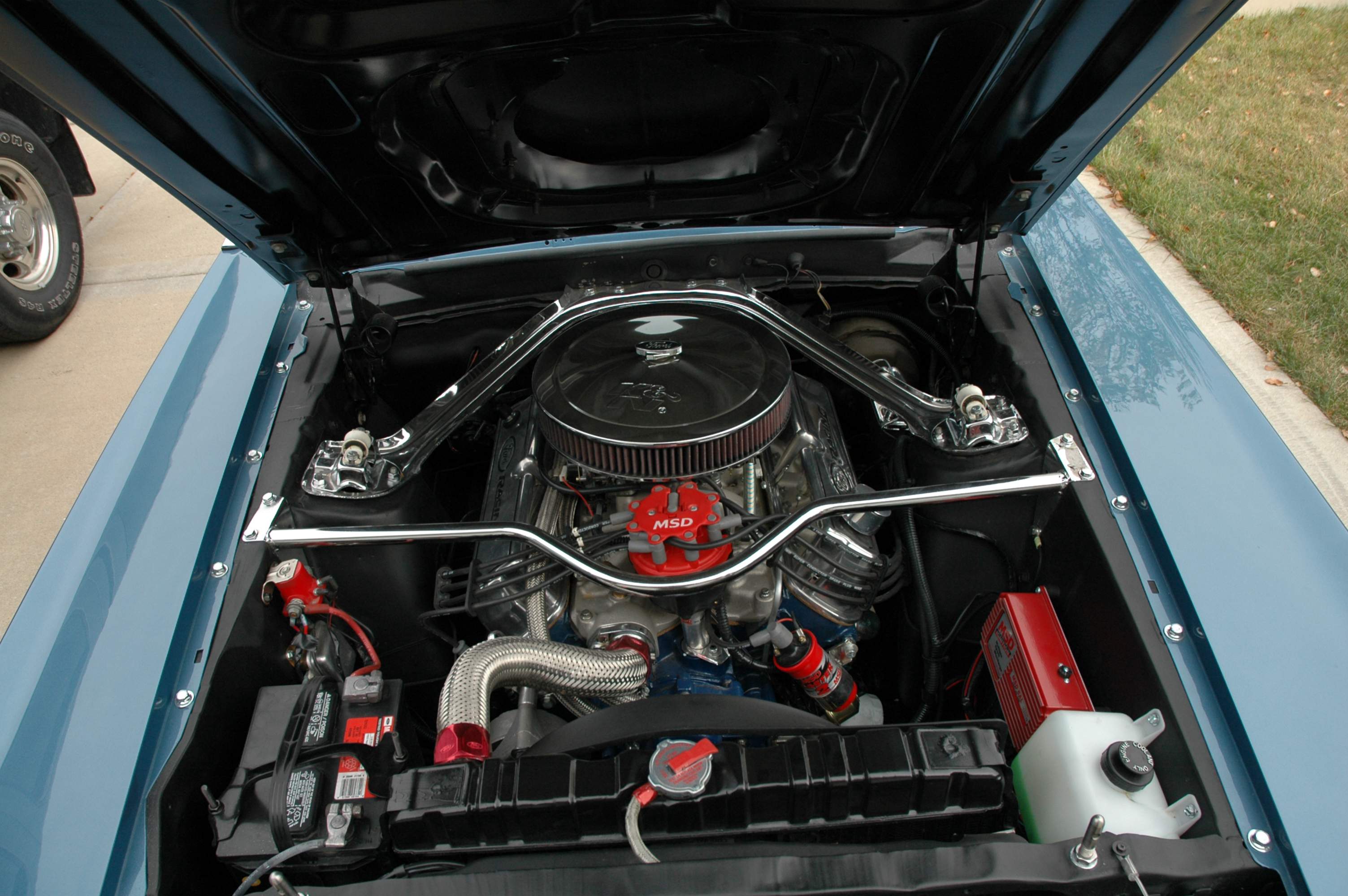

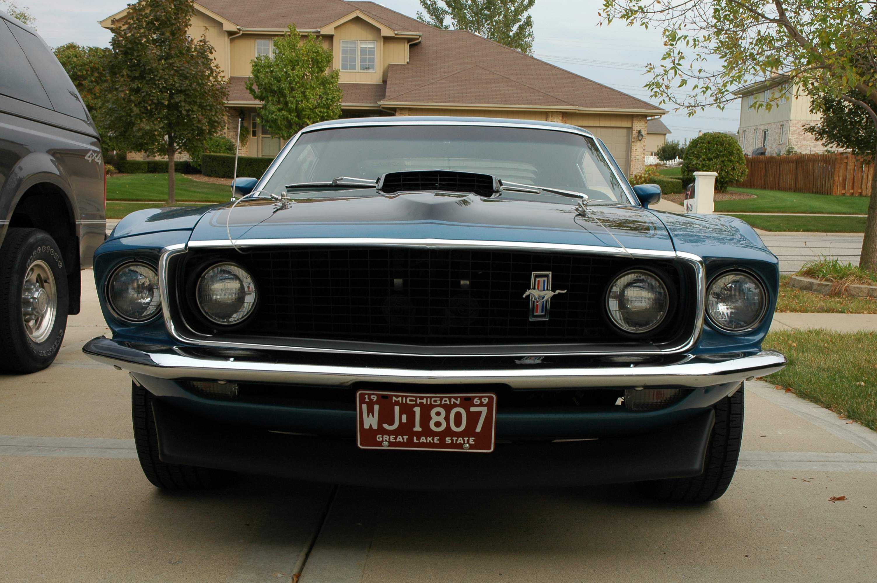

4Shorts love your posts/mods and ur Sang. I'm a lifelong Mustang fan, heres a few pix of my second pride and joy, not as refined as your ride (my 5 kids get the #1 pride n joy spot)View attachment 336466View attachment 336467View attachment 336468. No a/c so i'm lookn forward to some cool fall days for cruizin. Dan
My friend that is one gorgeous car. It's the reason we have a Mustang. Yours in my opinion was the greatest looking model ever produced. I had a "72 Mustang way back when but you have a real beauty sir. Love the detail and the colour. It's as refined as one could get. Really appreciate seeing it. I bet it sounds great too.
Thanks for posting.
Paul

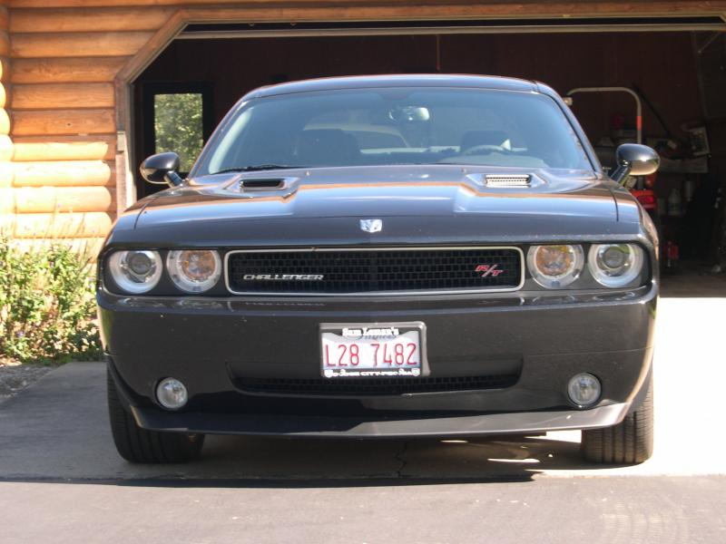

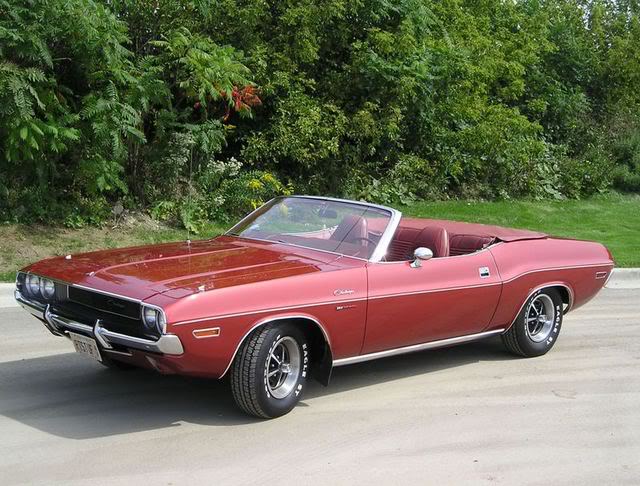

Here is a picture of my black 2010, its an RT Classic, 5.7 hemi with a few mods. The older one is a 70 Challenger I bought in the late 1980's and restored and owned about 15 years.
I love the Factory Mags on those older cars.
Very Very nice. So nice to see a survivor. Love the new one to :drool:
Thanks for showing them. :thumbsup:
