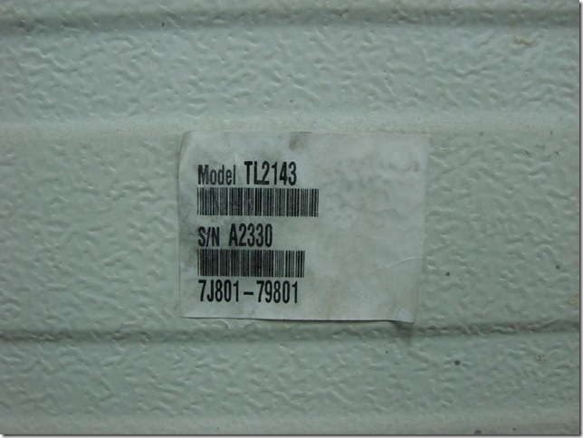

What bucket size and model tractor was the cutting edge from? Also what were the original dimensions of it? If i had to guess I'd say it started off as 54" x 6" x 1/2" but not positive.
Great job once again!
The cutting edge was from my Kubota dealer. I snapped a photo of the PN for you. It was around 61" long. My dealer said they couldn't find one short enough for the BX and I really didn't mind. This one came with the bolts, nuts and washers. I think it was around $200.

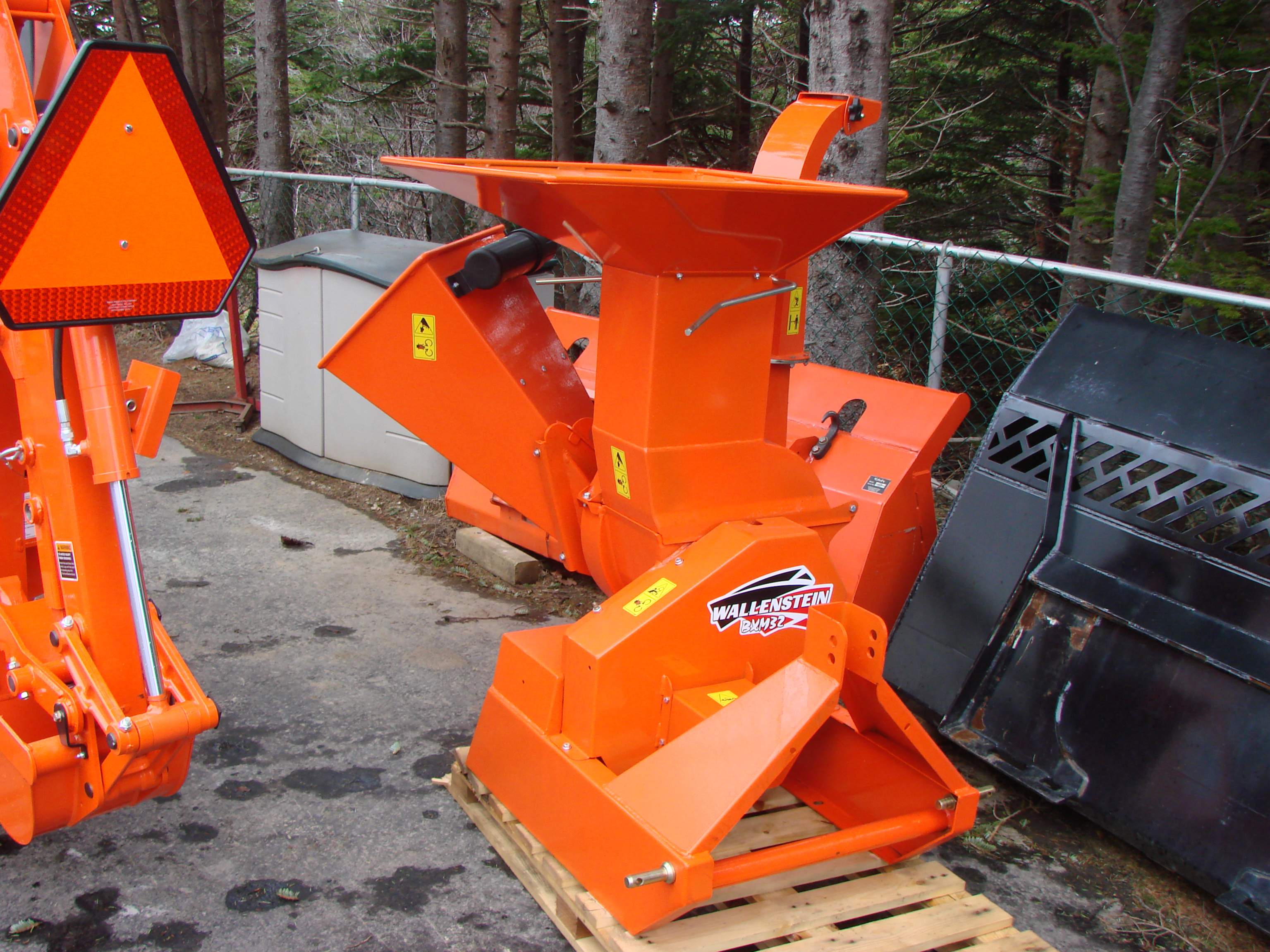

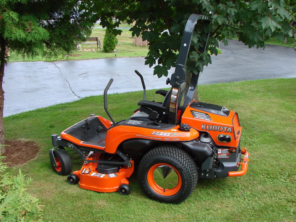

Yes I realize I covered the PTO but I have no need for it. I'm only using this machine for the chipper/shredder and the back hoe. I'll use the ZTR for the mowing. Thanks for commenting.
