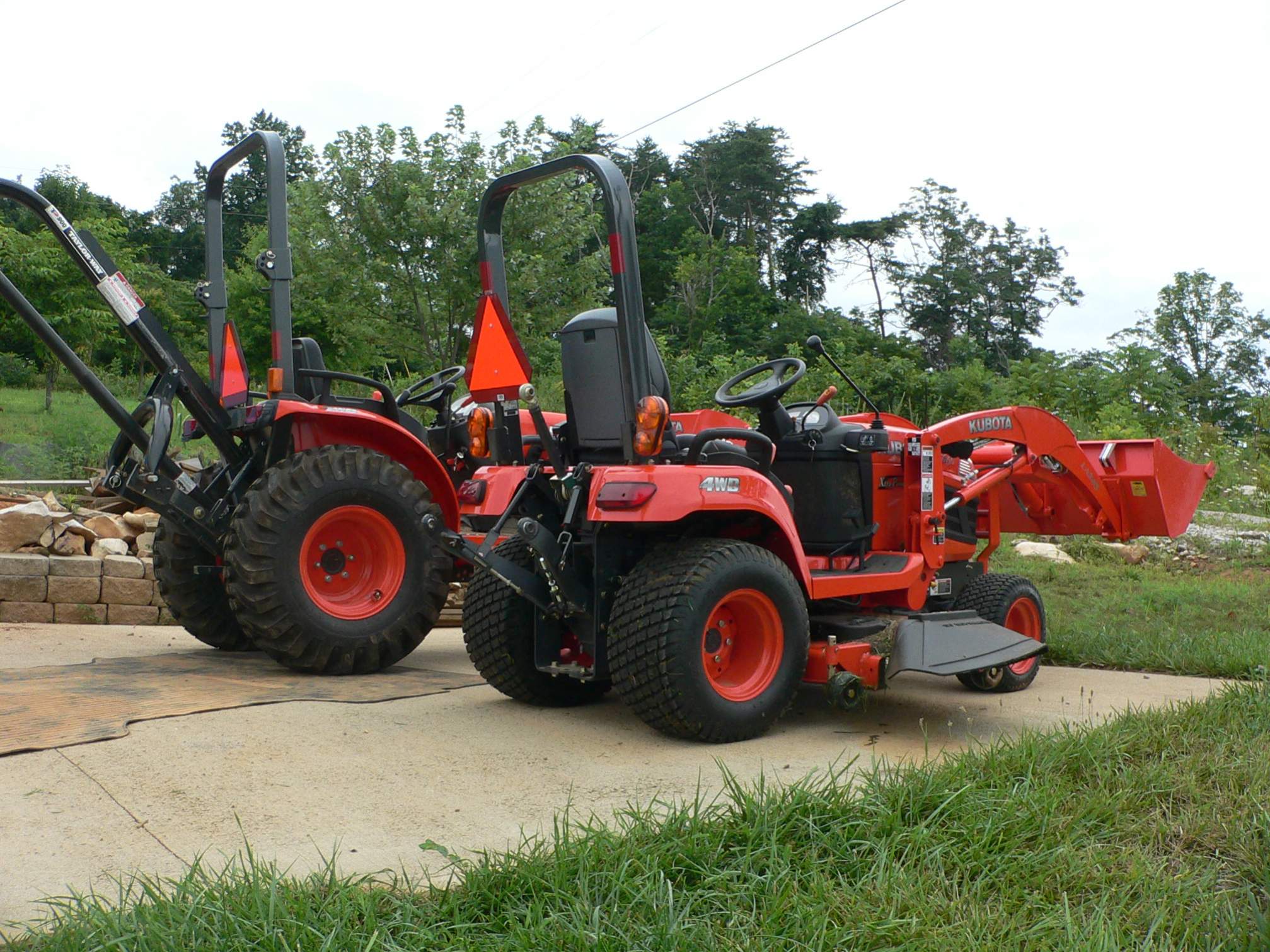

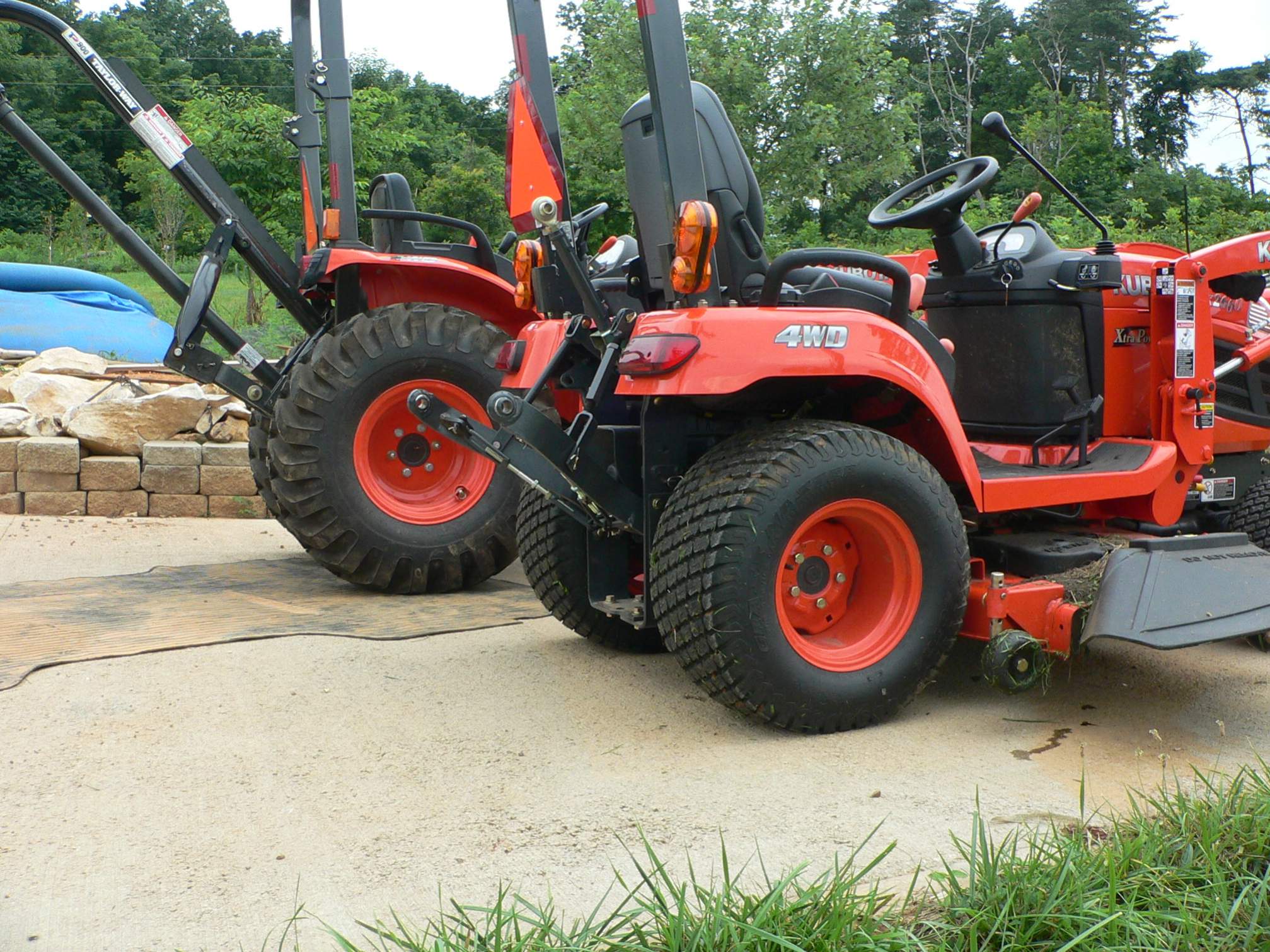

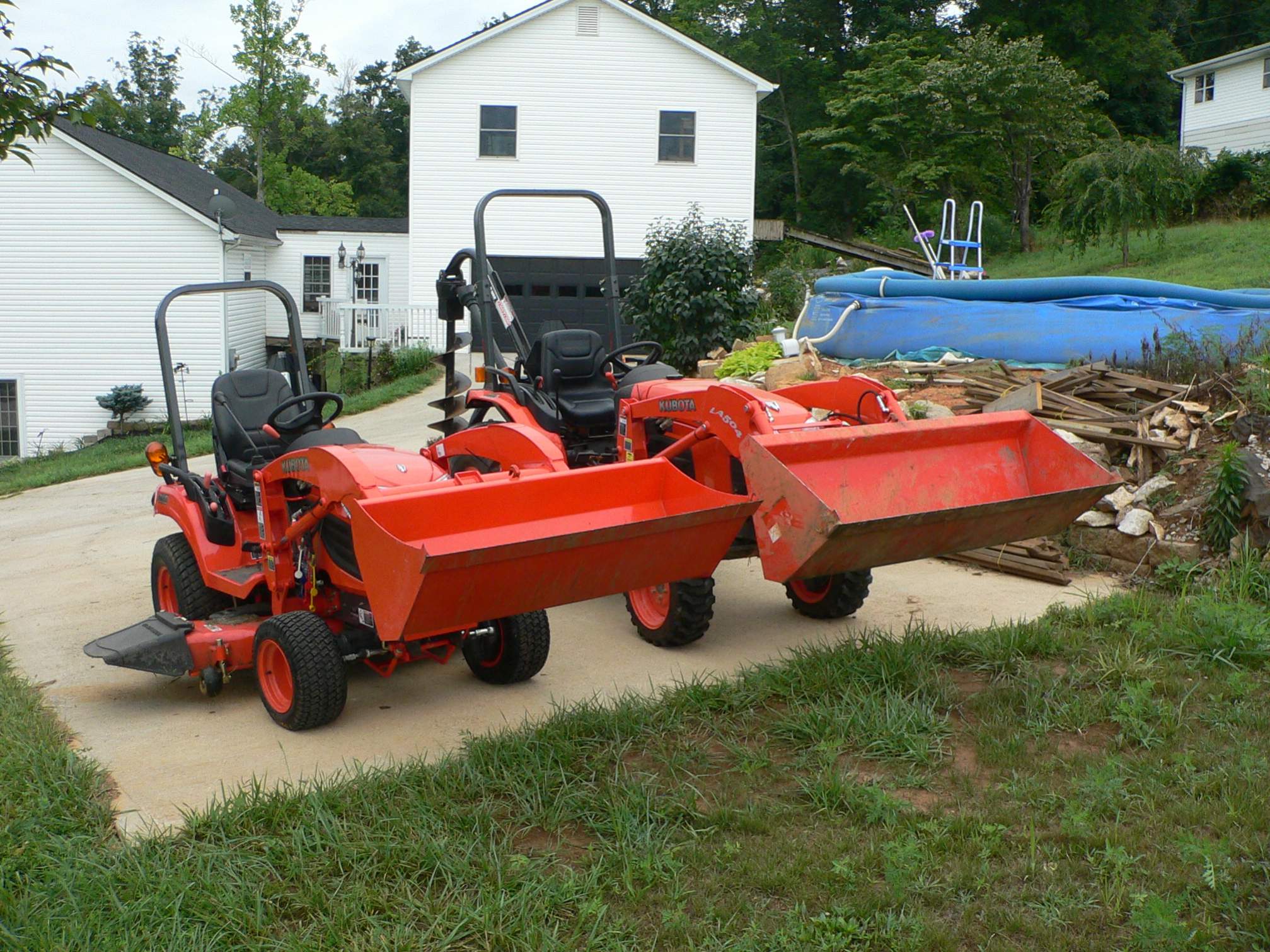

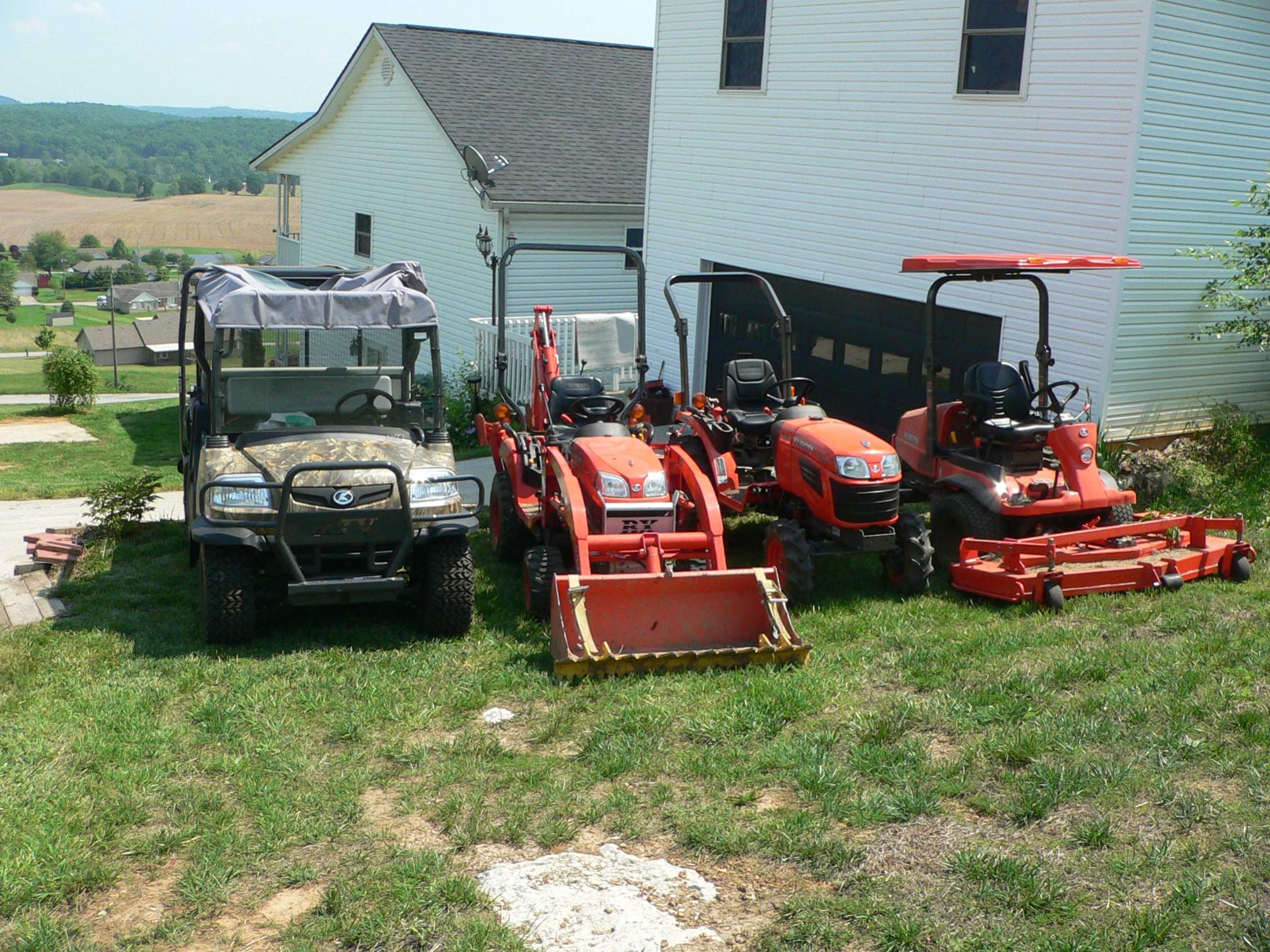

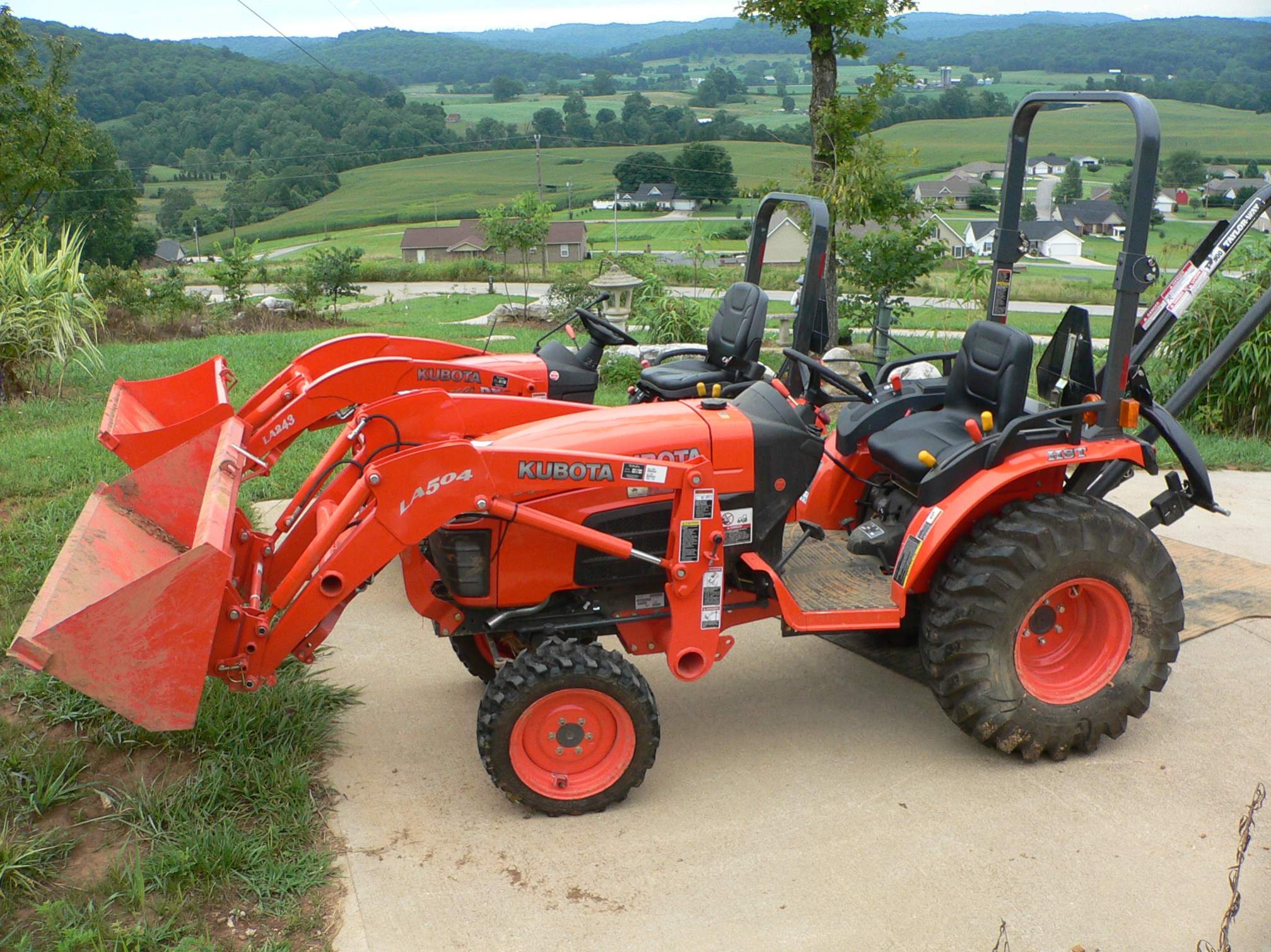

BX side by side with B.
BX2660 vs B3200 BX25 vs B2320
Ok, you have the perfect solution :D buy them all.. only wish i could :D

I have used BXs for mowing except for a B7800 with 6'RFM I used for front yard which is flater, not flat but flater.
I currently have the F3080 4wd for all of my mowing. It's the most stable mower Kubota and maybe anyone makes.
The best BX for mowing was a BX1500 (smaller and closer to the ground) and then all the other BXs.
The Bs that I have owned and own do not feel as stable to me and they aren't, in my opinion as any BX. I once traded for an L3240HST and it was a short term machine, very scary on hill side sitting so high off of the ground.
Get a BX2660, MMM and under carriage plates or leave the MMM on all of the time which is what I did. If you want a BH then get the BX25 with MMM and take FEL and BH off when mowing.
