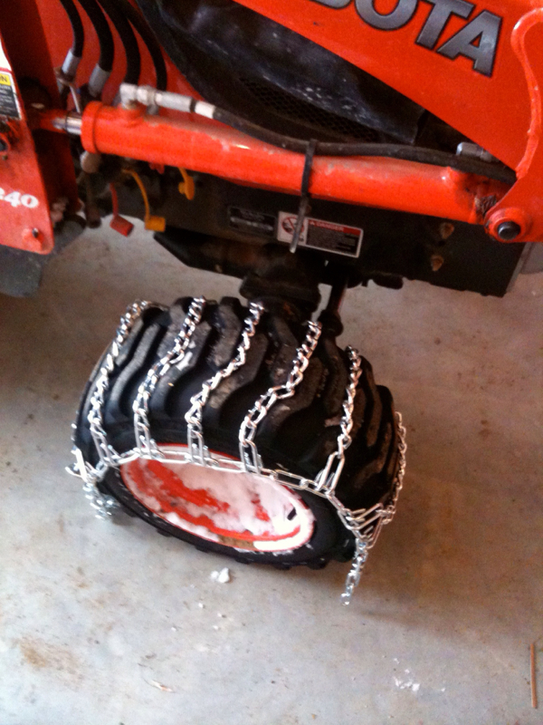

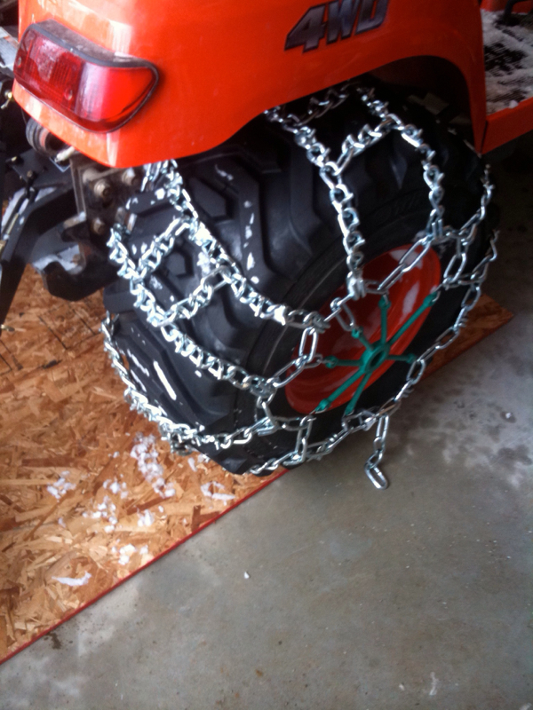

I got the rear v-bar chains for my BX 25, and they were great in anything. The only problem is, when I drive down the road from my one Cottage to the other Cottage about 300 yards away it is the roughest ride you could possibly imagine. So, after putting them on for the first time, I left them off for the past two years.
I had at first purchased the latter chains, but the links simply fell in between the treads of the tire, which would have made them virtually useless, so I returned them and bought the V bar.

By the way, I had to add 2" wheel spacers to the rear wheels in order to get enough fender clearace for the chains. (The ladder chains ion the front wheels n the second photo are the ones I teturned.)
