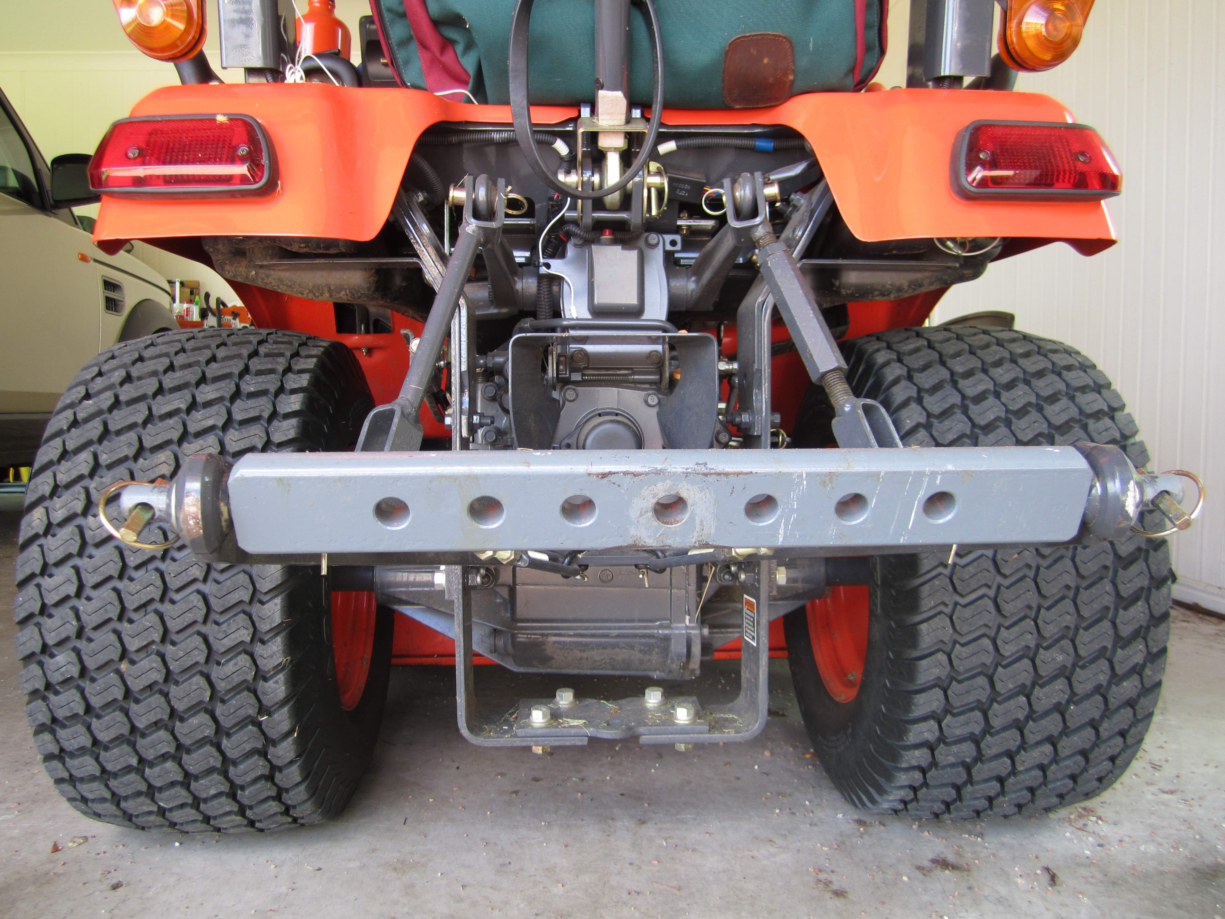

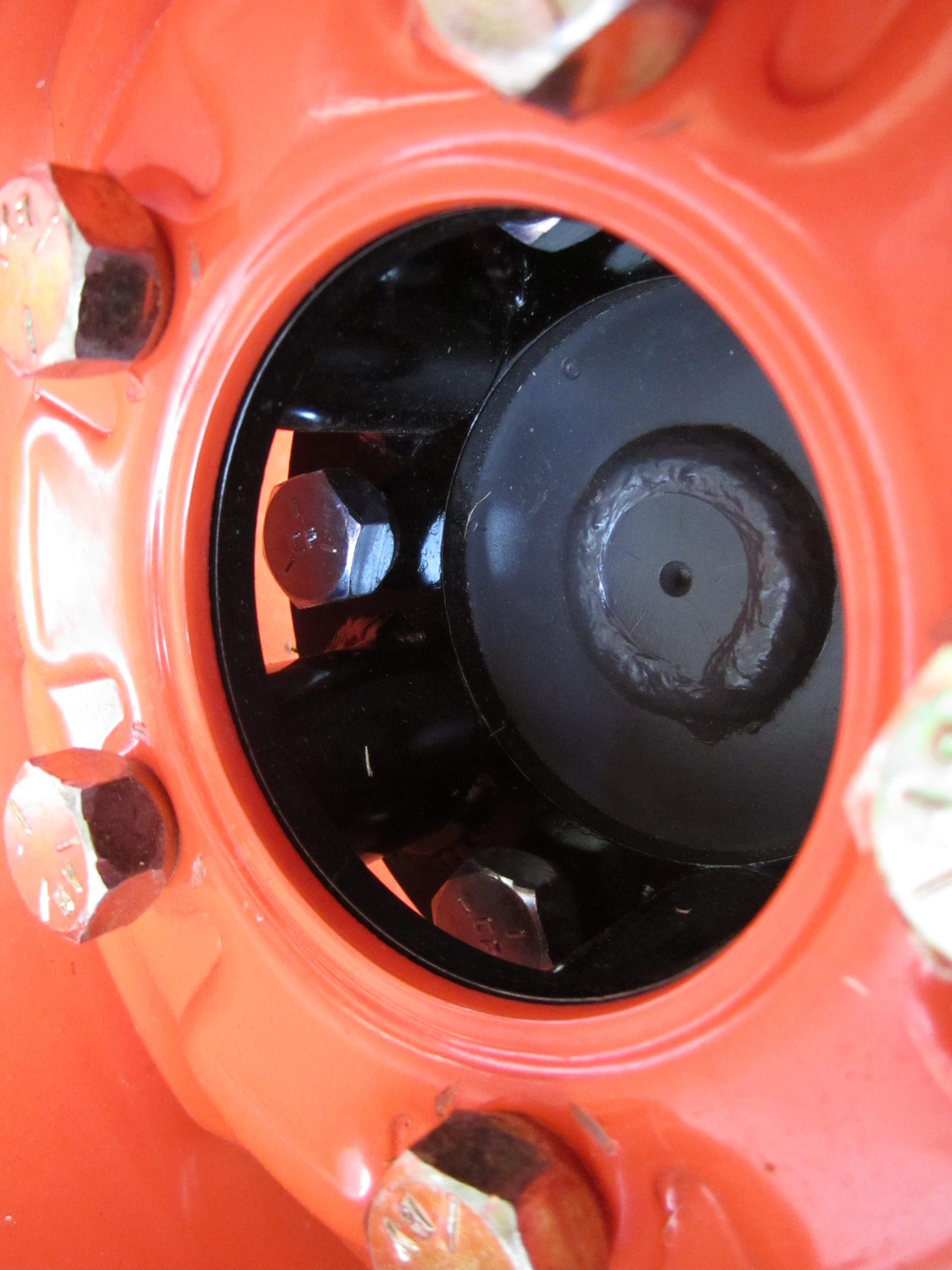

Have you bought spacers for the rear wheels to increase track and stability
when using the loader on a backhoe machine ?

Nice looking spacers OrangeRidge! can you give any details regarding source and pricing? I chicken out at 25 degrees sideslope :D

USD234 delivered ( USPS 7 day air / sign for and tracked )
Wheel Spacers for Kubota B and Kubota L Series Tractors, Kubota BX Series Tractors, Kubota RTV, John Deere XUV Gator HPX, Cub Cadet Tractors, Polaris Ranger 6x6 Tracks
Christian Hansen will make whatever width you want. I went with 2" and
a 1.5" ( 54" MMM restricts you ... ) .. or 2@2" for 60"MMM
He supplies 10 original Kubota bolts and fixing bolt aswell.
Pay with PayPal and it's currently Aus$225.
The Yanks have very cheap freight . Product from Canada was USD120
freight !
