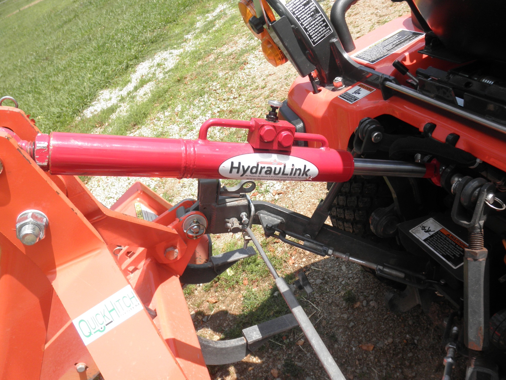

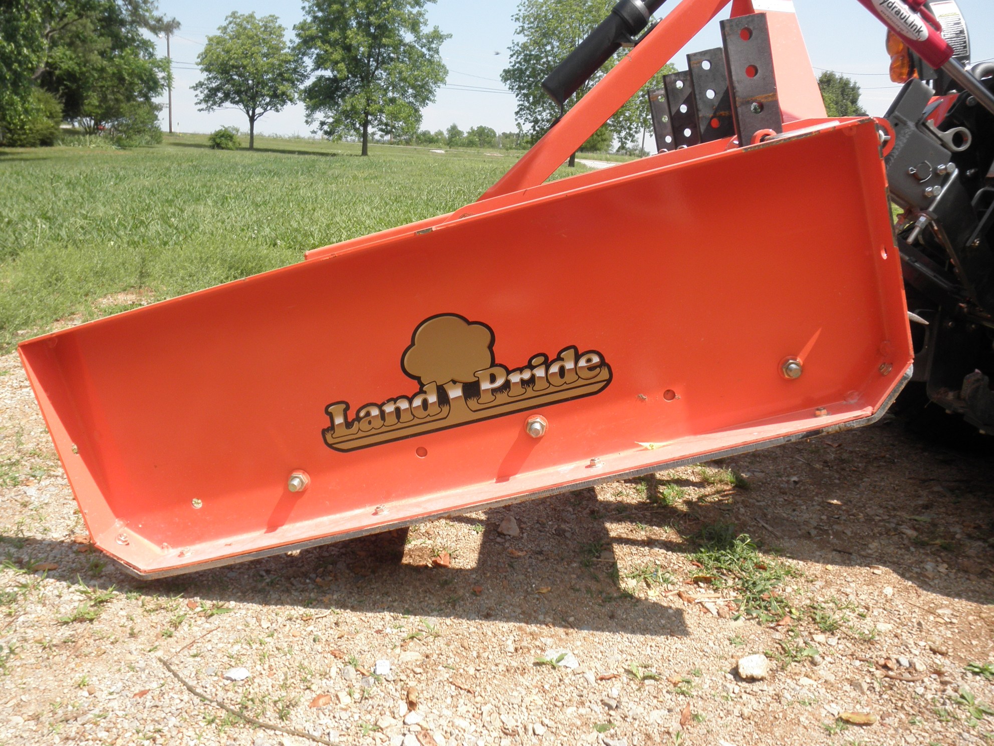

Took some photos this weekend, along with some measurements... I never could find the model number for my Hydraulink, my order is buried in an email someplace and I filed it away and now I can't find it?!?! :eek: Sorry for that...
Anyway, enclosed are some pics of my setup... First pic is the 'Link itself. I zoomed in on the pic, but this is in the fully compressed position. I've got just two or three threads showing past the lock nut on the adjustable end and it measures 19" center pin to center pin. 2nd photo shows the orientation of my Plane in that position.
3rd pic is showing the HydrauLink all the way extended. Center pin to center pin measurement in that position is 25". The last pic shows what an extreme angle that puts the Plane on. 'Course, it's unusable in that position but the point I'm trying to make is that to get it in that position, I opened the valve on the 'Link and raised up the 3pt hitch and then closed the valve. Simple...
Hopefully this will give you gents an idea of the range of motion the HydrauLink will support. I got mine from Greenwell when I ordered a set of Pat's Easy Change QD's.

Thank You for the pics...
It explains it well. Now how about some good pics of that land plane
and PATS stuff! :)
It kinda looks a little to long. I wonder if you could make an extension to
the rear top link bracket, not the hydralink but the receiver for it at the
rear. That would give you more usable range of motion yes?

Welcome Sir! :) No photos of the Plane or Pat's gear handy, but if you are looking for something specific let me know and I'll see what I can dig up.
When you say "too long", I guess I can see your point, but why would you want it shorter?? If the toplink was shorter, then you'd have the "nose" of the implement angling down... What kind of implement would you use that way?? Both my Plane and Box Blade wouldn't work nose-down, that's why I'm asking...

I simply look at it and see it is all one way, one angle. An auger or a
boom or a subsoiler where you do not want an agressive angle, a
carryall, a pond digger, back blade, all could benefit from the ability to angle to AND fro, for lack of better words I thunk...
Also I look at your profile and when it is totally compressed you still have
a bit of a rearwards angle yes? I would think you would want that land plane level at times, maybe it settles down to level when you plop it earthwards...

Hey, I hear ya on that! :laughing: Still learning myself... And you've got some valid points there, all I can speak to is the Plane and Box Blade. I don't have any other implements other than a 40gal boom sprayer and the 'Link works fine with it too.
That photo is a bit misleading, the ground falls away where I had the Plane parked. If you look at the profile when it's on the concrete floor in the shop the Plane shoes are flat on the ground.

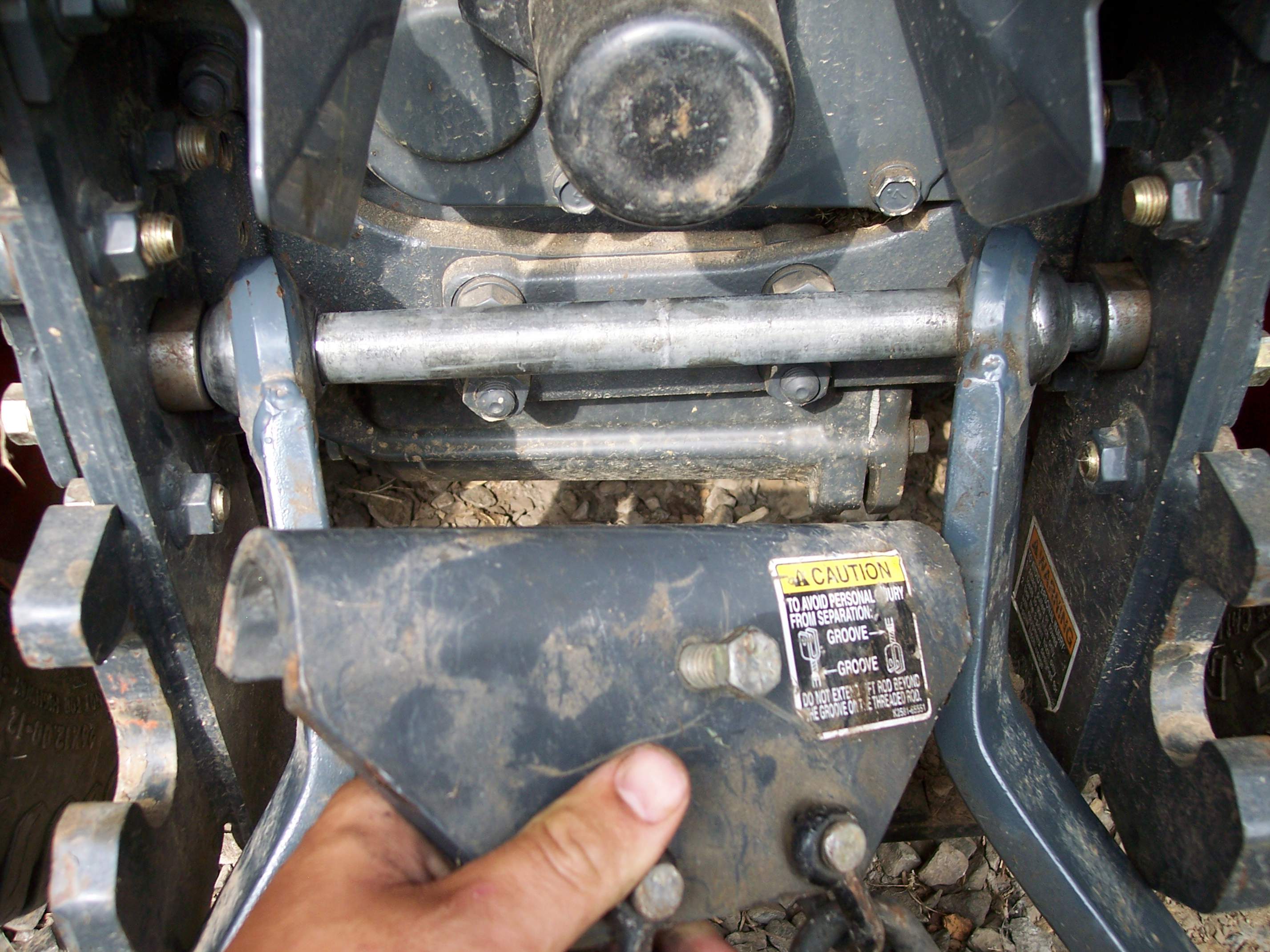

Ron I know nothing of QH's. What brand did you get may I ask? Got any
pics to show N tell ? As I believe I said prior, I threw on my 3PT hitch for
the first time a few days ago. I threw out the top cotter pins and
changed them to lynch pins to hopefully facilitate a quick change out
when I go back to the BH. I too am looking at this set-up...
Oh, the idea of throwing away the "Stopper Pin and its "Hair Pin" and
either tapping in a thread, or I think I perfer welding on a nut so you can
simply unscrew a bolt or screw down a bolt for ease of installation
and removal. (Welding a nut onto the CheckChain bracket)
See the 3pt instructions to see names of parts if necessary.

Artisan,
I bought a QH from HF, $72 on sale. Had to do some modifications though as their engineeerin on this one is faulty. I am sure the chineese company just made it he way they recieved the design. I took some pictures today; will convert to PDF and annotate what I had to do. Not bad if you are handy and have welding equipment and skills. Still saved from $100-300 depending on the brand you look at and what comes with it. I'll try to get it done tomorrow as today; using my tiller, broke two more of those 5/16 check chain clevises. WILCO doesn't stock them so will try another place tomorrow. I had the chains tight but still broke, those who like their chains loose must go through a bunch of them. This running around for a two bit part gets old fast. I have to go to Bremerton to get some steel and welding rod and another farm store is on the way. I hope someone from Messicks picks up on this and relays this flawed piece of engineering to KUBOTA. While in Bremerto I will check on some 1/2" long turnbuckles with clevis ends. I have an idea on a fix.
Say, aren't you a plumber? Are you a UA member? I am a retired UA Steamfitter.
