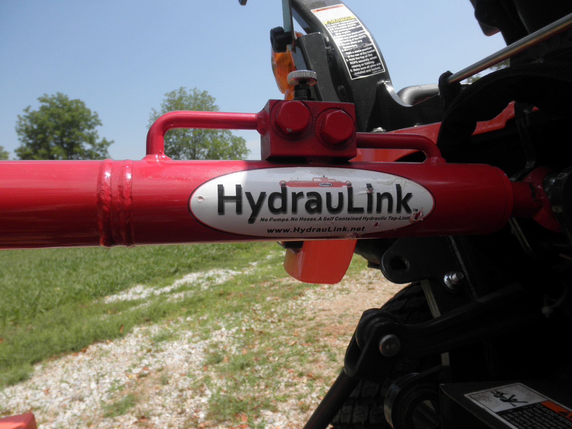

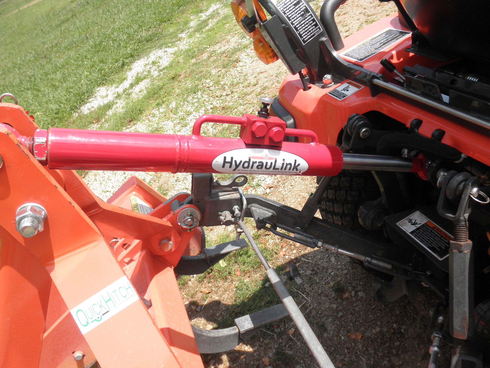

Seems this thread got a little far afield, but just to finish up my comments on adding a hydraulic top link, I pulled the trigger today on a Prince dual-spool valve with, hopefully, all the fittings and adapters I'll need to add dual rear remotes to my BX25. I plan to plum it into the BH power-beyond loop to run the hydraulic top link I made up when I had the old BX1860 with the dual rear remote kit (which is not available for BX25). I will start a thread probably in the Hydraulics forum once the project begins. I will need to make up a mounting bracket that will attach to the ROPS and then measure and order hoses, so it will be a while before it's functional. Chow.
Oh, mostly for Artisan, my long run plans are to add the Thumb grapple to my FEL bucket and power it from the rear remotes with loooong hoses. Not the ideal solution, but this approach will let me use my old hydraulic top link to start.
