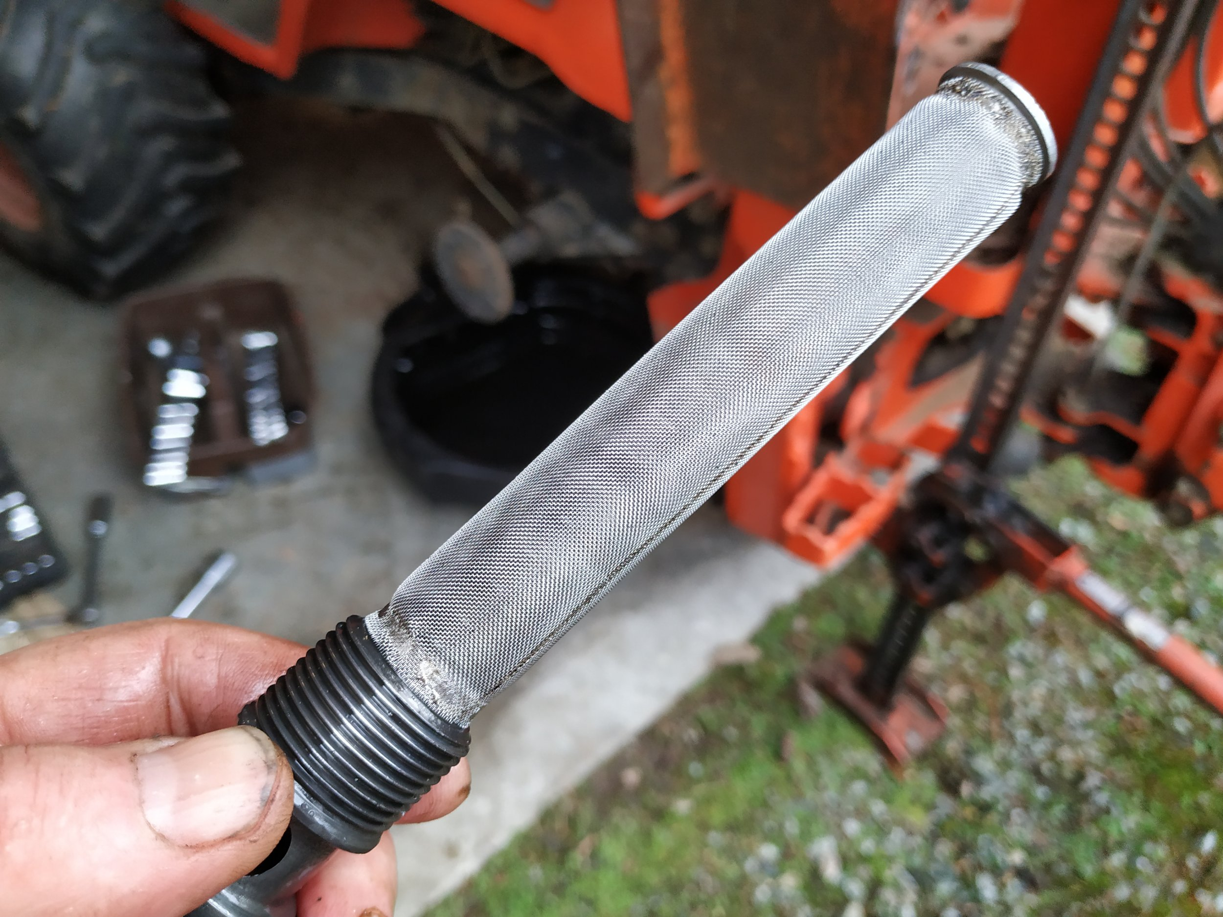

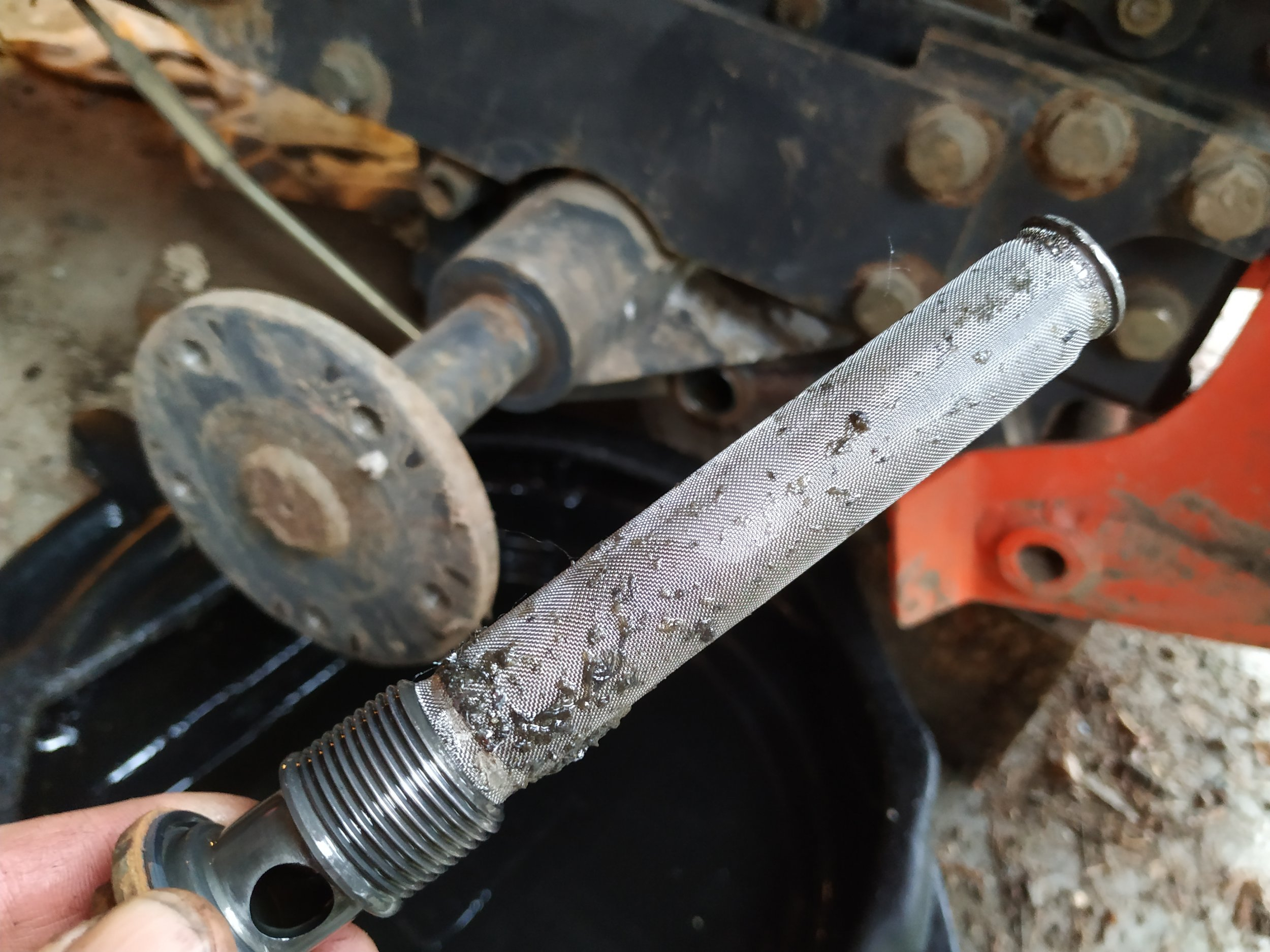

Little late getting back here but happy to report the fluid changes have been going well for the most part. Here is what I found on the strainer screen for the HST and hydraulic oil, before and after cleaning pictures. Does that look like the normal amount of gunk to you?
Also, when doing the oil change on the front differential I thought the manual said it would take more than 4.5 litres of 80w90 oil. I put in three litres and it was way over full so I ended up draining out 1/2 of a litre and it appears to right on the mark after driving it on a couple of short runs.

Looks to be about average. Clean it in mineral spirits or diesel and reinstall it. If it has a copper sealing washer, you might want to replace it. Your local discount auto parts store will have various sizes.

Thanks! It's cleaned up and back in for about a week now.
