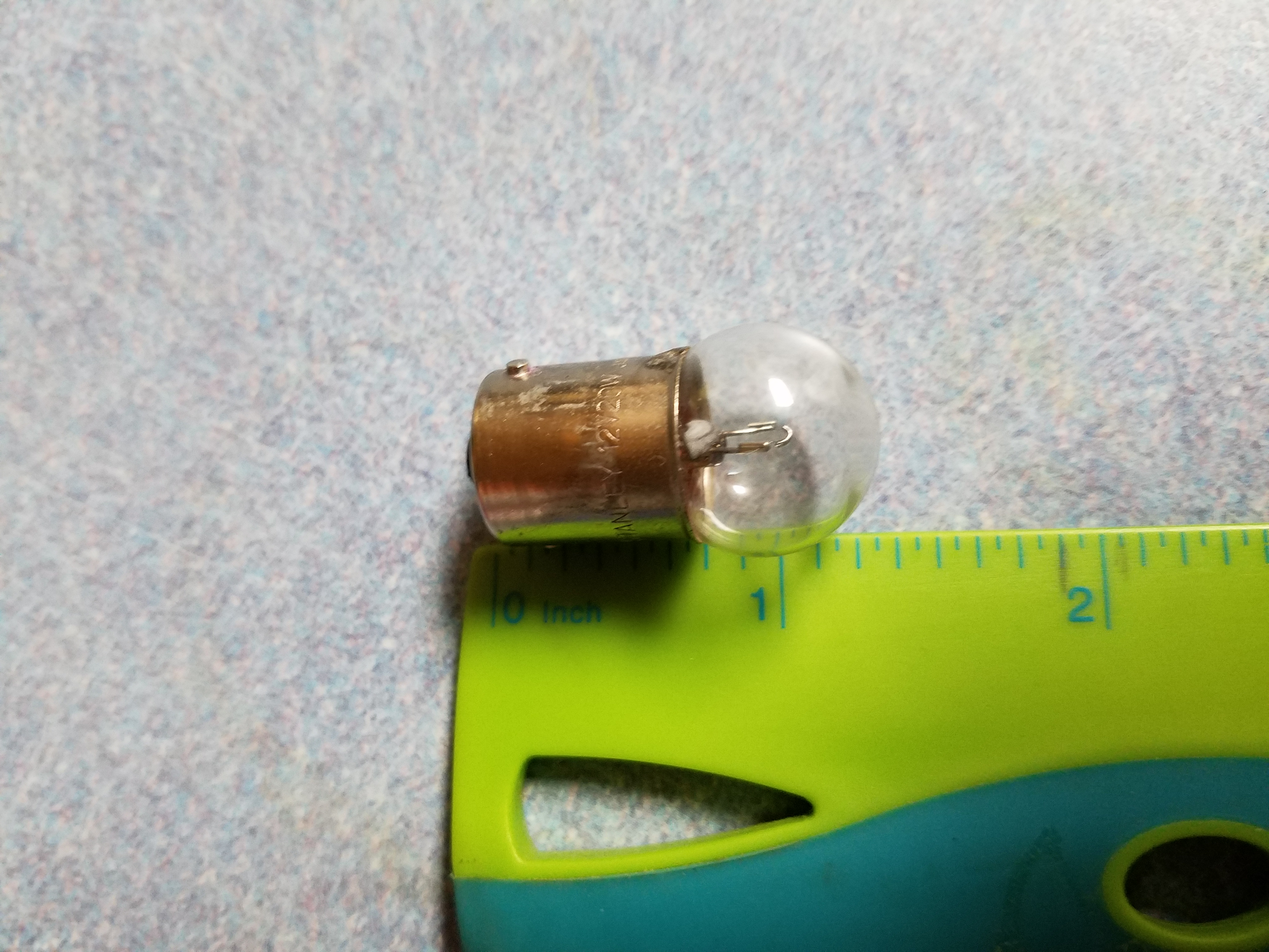

The bulb is stamped Stanley 12V 20W. It's a single contact bayonet base bulb. Bulb is approximately 11/16 dia. x 1-1/4 long.

Thanks George, but that bulb is to big. It's a fairly small bulb, with a high wattage. I attached a picture of the bulb.
/ Bx23 blinker bulb #4

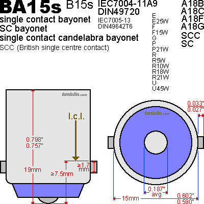

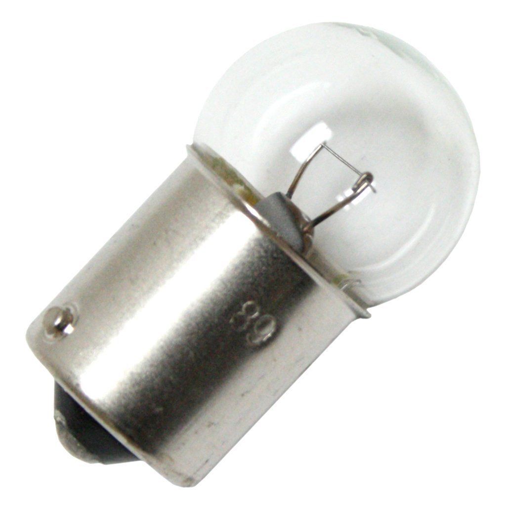

What you have appears to be the equivalent of a 12V #89 automotive bulb with G6 BA15S base. They come in brass and silver base color. Any auto parts store can match it up to the equivalent LED.
I found some more specs on your bulb.
4129/12V/20W EUROPEAN
4129 EUROPEAN
4129 STANLEY
category: Incandescent-miniature lamp
volt: 12
amp: 1.67
watt: 20
base: BA15s - Single Contact Candelabra Bayonet (or S.C.Bayonet)
glass: G5-3/4
d.hours: 200
notes: clear glass

OK George..... I'm really impressed! I scoured the web looking for that bulb, and you found it in a couple of hours. Thanks for taking the time to do that.
