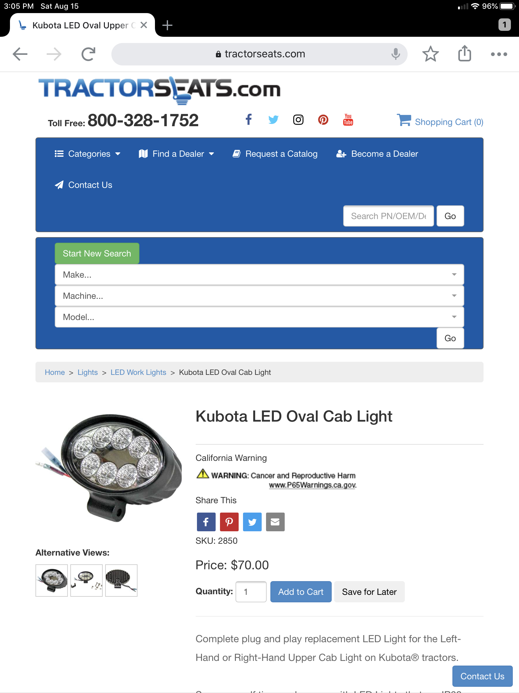

Has anybody tried these? I'm thinking about it as it looks like simple plug and play.
