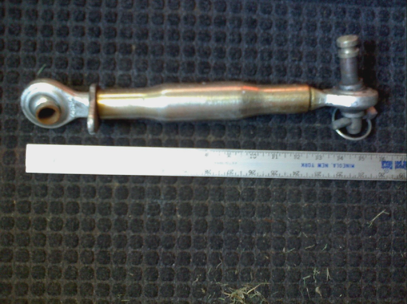

Thanks, any chance you have a pic or a link for that top link? I found a "short" top link that I was using, but it wasn't as heavy duty as a "normal" top link and it eventually bent while working in tight quarters around some trees. I went back to the original one that came with the tractor. I have several top links that I use for different applications, but none shorter than the Kubota one. I'll get the Tisco if it's a bit more durable than the one my local shop had for sale.
It's beefier than OEM & far less costly. Around $15 I think.

I have the same top link that SeymourBota shows - it is definately beefier than the OEM, but a little shorter
I also have a 16" top link I got at TSC (to hold me when I broke the OEM and before I found the shorter one above) - It is a perfect fit after I added Pat's Easy Change system. The extra four inches on the lift arms definately helps.
