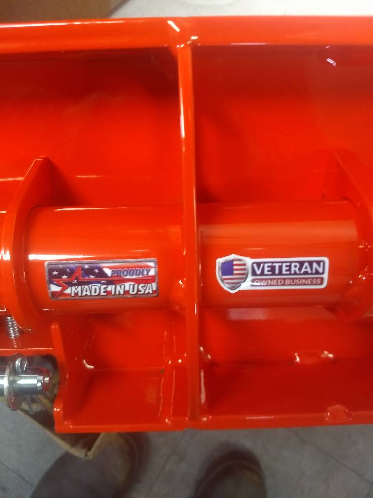

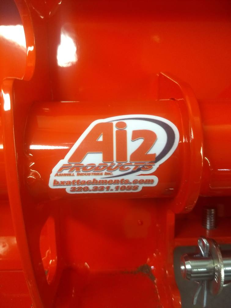

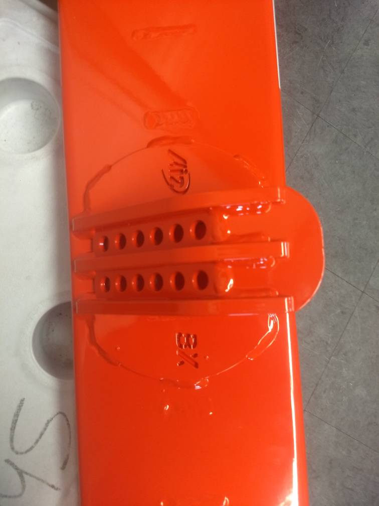

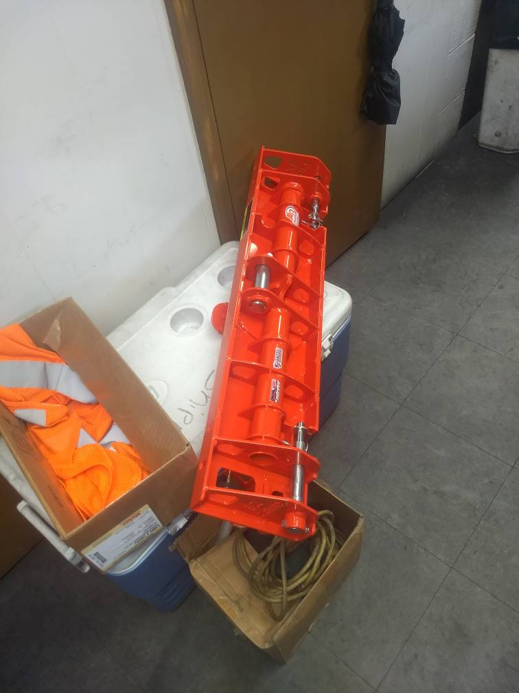

AI2 quick attach has come in. I'll install it tomorrow!

Boy it sure is purty. Now what is it?

It's a quick attach for my loader. According to Kubota, you lose 126 lbs at the pins of lift capacity with the SSQA. With this quick attach I (supposedly) only lose about 50 lbs.
In practice I don't think I'd notice a difference between either but I wanted to avoid that extra weight lost when I was purchasing the tractor, before I had really used it.

Be careful with those calculations. They may say that you lose 50 pounds (maybe because they simply subtract the fact that the quick attach weighs 50 pounds), but I bet they do not factor in the lifting capacity that you lose due to the pins being farther away from the loader arms. And this can be quite significant.

It's a factor, but that's partly why this loses less than the factory SSQA. He's designed it to keep the load in closer to the pins than the factory SSQA.
