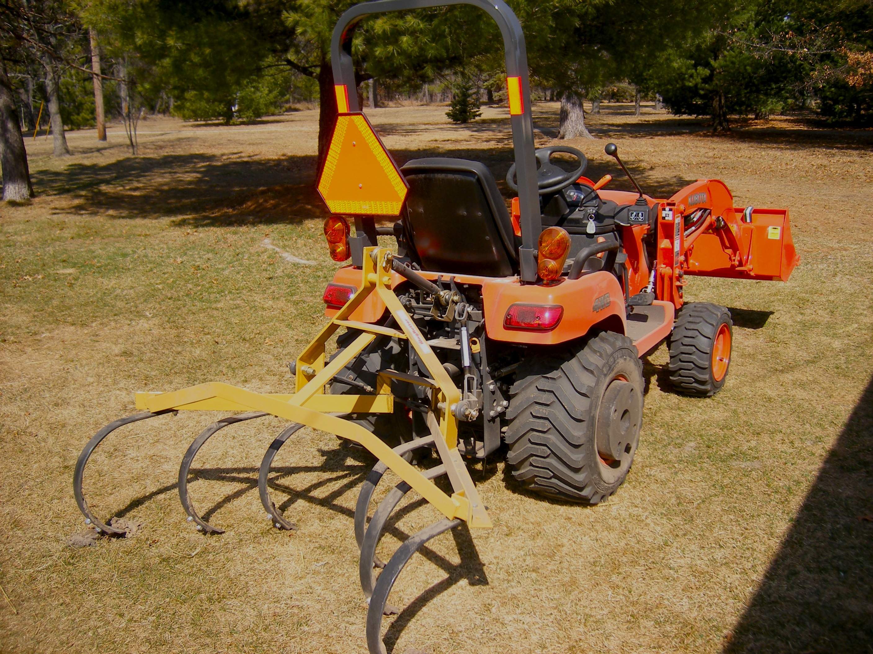

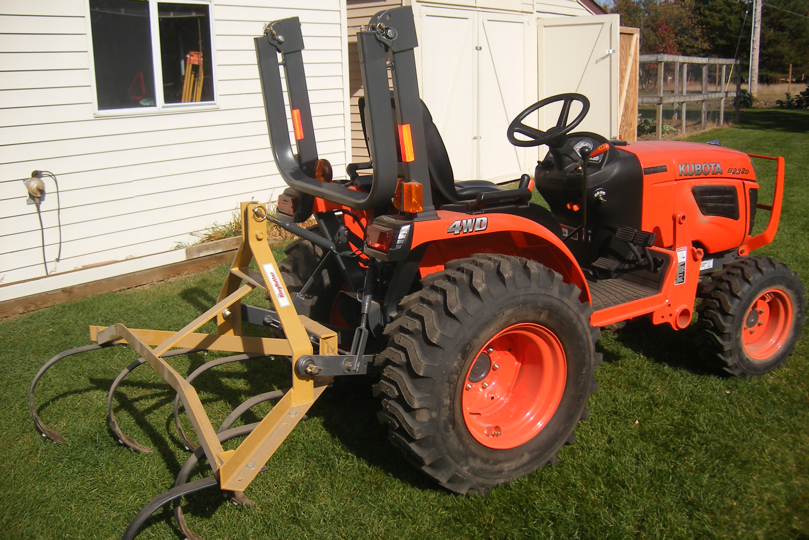

Operating The Field Cultivator

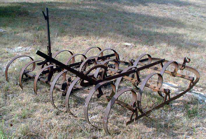

I use the the field cultivator two ways. First, I use it as a spring tooth drag or harrow. I would like to have small section of traditional drag, but haven't taken the time to get one. They are still very popular and fetch a stiff price, if they are in good shape.
The cultivator I have is standard KK, Cat 1 and is an implement that I did not buy in the XB size. I didn't see one in XB and if I saw one on line, it didn't look to be as quality a piece, nor have the flexibility in positioning the tines I needed. The KK was very inexpensive and has movable C tines. It is a very tall unit and the BX1860 could just pick it up and move it to the field across the yard. The turnbuckle check chains on the BX got bent by this unit more than once. It was simply too large for the BX, any BX to handle.
As a row cultivator, the BX simple did not have the ground clearance to be of much practical use. It could not pass over any plant more than 5" tall. This implement and it's use as a one row cultivator is what doomed the BX. My 1860 was fitted with wheels/tires from the larger BX, to give it that added inch of clearance, but it still was far from enough.
Today, I just used it as a drag to pull all the stubble, dead vines, stalks and chaff from the field. Then, I dressed the soil with compost material and dragged it in. The B2320 has a larger geometry 3 pt and it handled this implement very well. It's not growing season so I will have to wait until next year to do any row cultivation.
Thanks to Jinman for the photo of the old C tine drag.

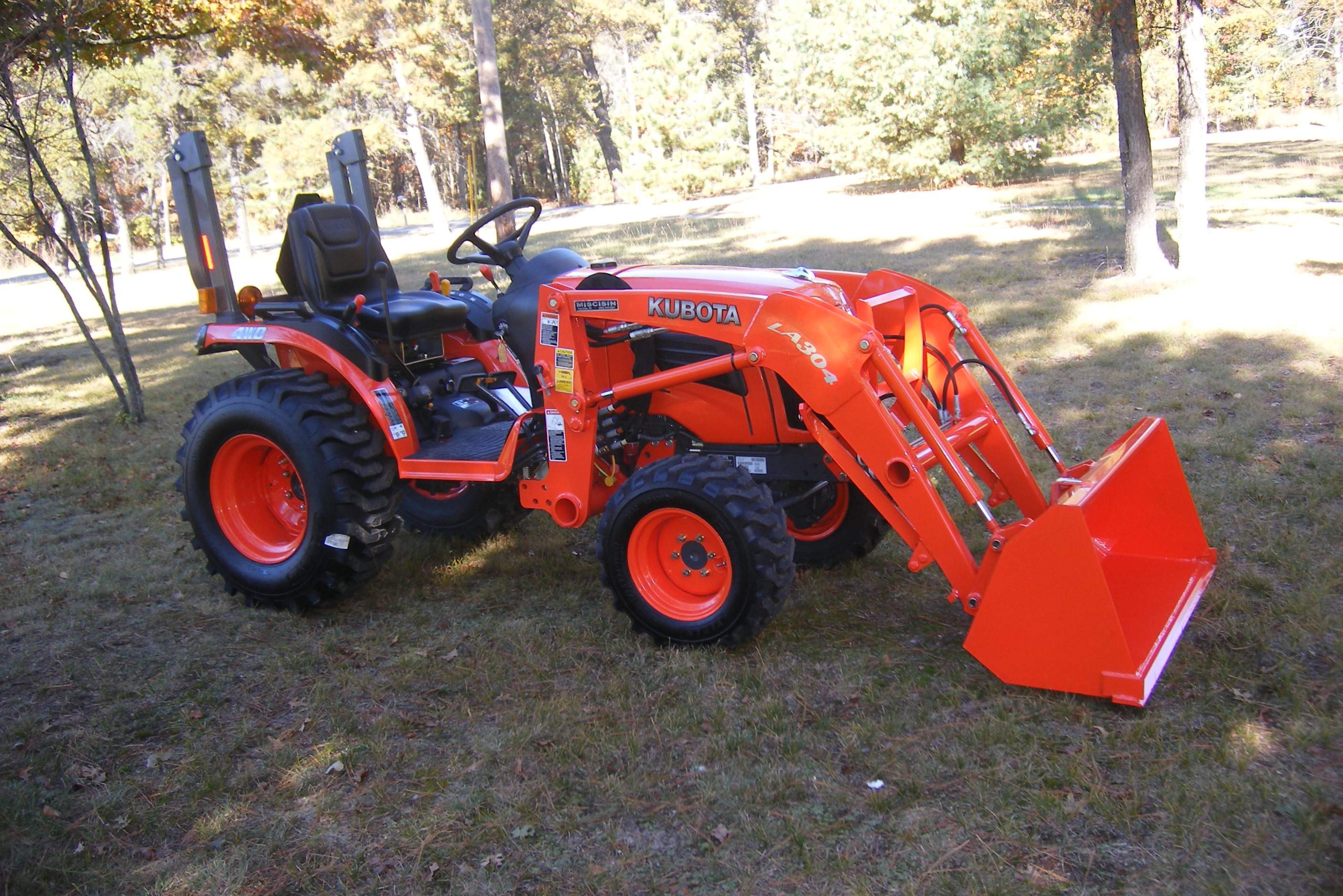

Well, ladies and gentlemen, this about concludes my first week's review of the B2320 in light my experience doing similar tasks with my recently parted BX1860. I've tried to review the "seat of the pants" subjective/objective differences.
I've run the middle buster and the FEL. Mowed the grass with RFM and used the field cultivator. Of course, I also done a handful of utilitarian things such as move some sand and tow the trailer around.
Until the snow flies, I'll put this review on hold, basically, for awhile. After I get a chance to plow some serious snow, perhaps I'll resurrect this thread and add that comparison. Thanks to all and I hope some of the information was helpful to anyone who wants to compare a Bxx20 to a BX Kubota. Best regards,

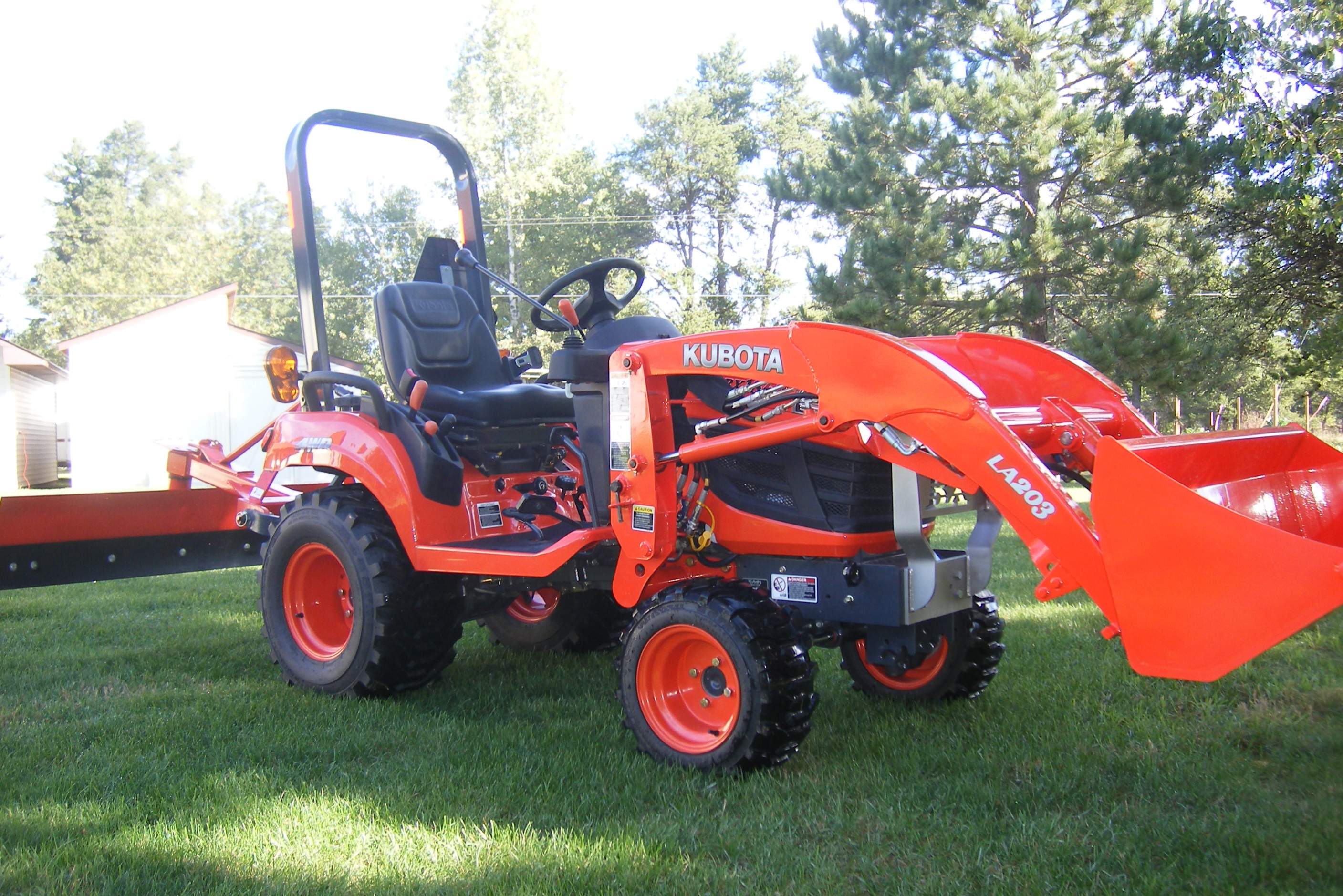

Plowing Snow With B2320
Since I promised to update this review when snow plowing came around, I thought I'd take a minute to do so. Got home from a long business trip in Texas to find bitter cold, 7F temps and 6-8 inches of snow to clear. I had been expecting a bit more, but our area doesn't get lake enhanced effects.
I have a block heater on the B, so I plugged it in for 90 minutes. Glowed the plugs for 6 or 7 Mississippi and it fired to life. The first thing I noticed was just how quiet this D1005 engine is, even when it's cold. By quiet, I mean it just doesn't hammer like the BX1860.
The hydraulics didn't seem to mind the cold. It always took a few minutes before the hydraulics limbered up on the BX. It might be the larger B2320 pump flow, but the FEL lifted normally and the 3 pt snapped the back blade up immediately. I gently rolled the tractor out and idled it a bit outside.
Here is what I noticed.
The 1/4 valving on the 2320 simply works better and allowed better control. The larger wheels and tires also "creep" through the deep snow better and held their traction well, even with unloaded R4 tires. I don't recall any wheel spin.
The BX is more nimble in tight quarters, but the B can track through the deeper snow better. The quieter engine and much quieter HST made the experience more enjoyable.
The BX was armed with an amazing front, full hydraulic blade and THAT was a thing of beauty and I still miss it, even though it was frightfully expensive for a limited use implement.
I'm sure there will be many more opportunities this winter to work and evaluate the B2320, but rest assured, it will clean up a 300' drive efficiently, with just a cheap back blade and the FEL.
