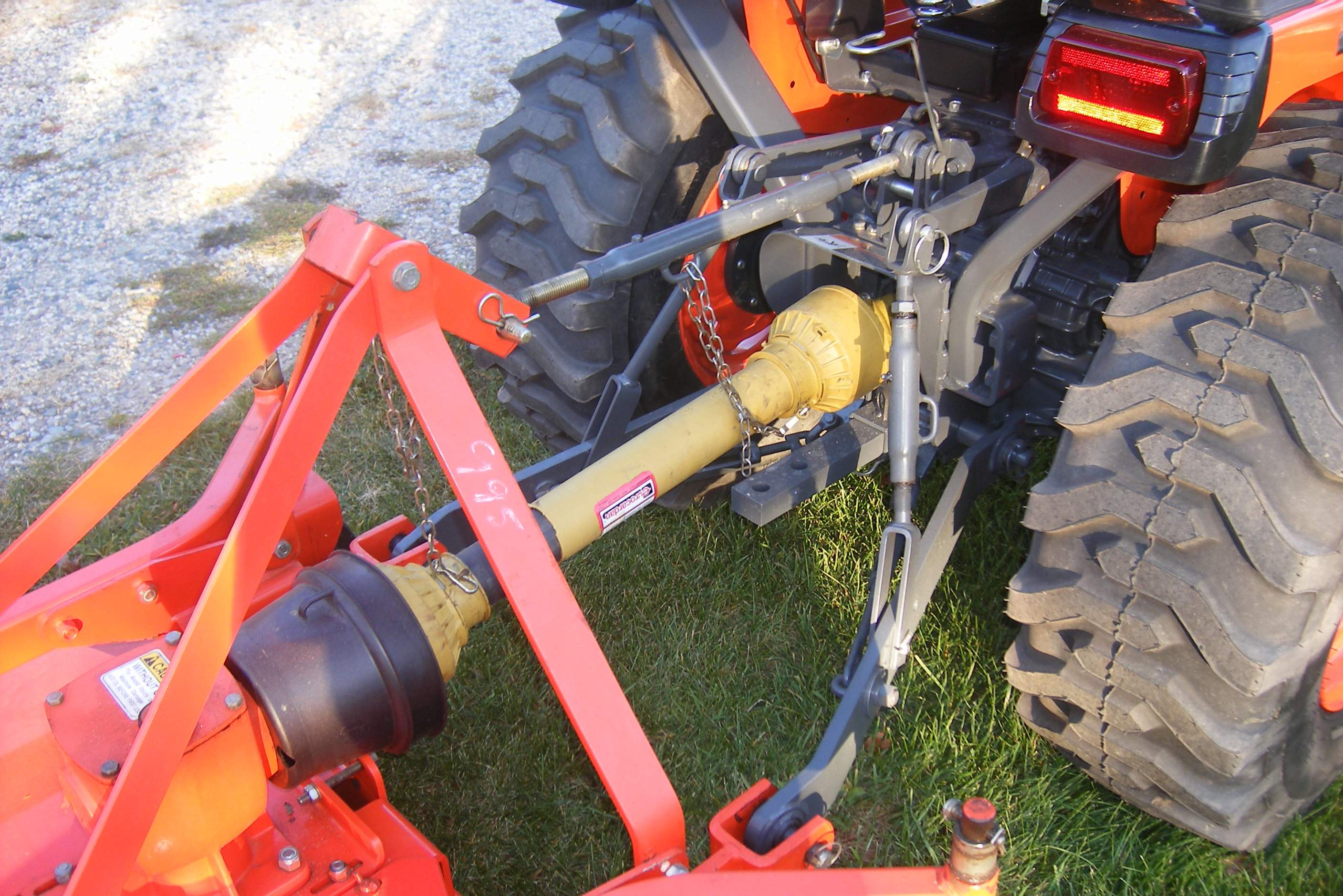

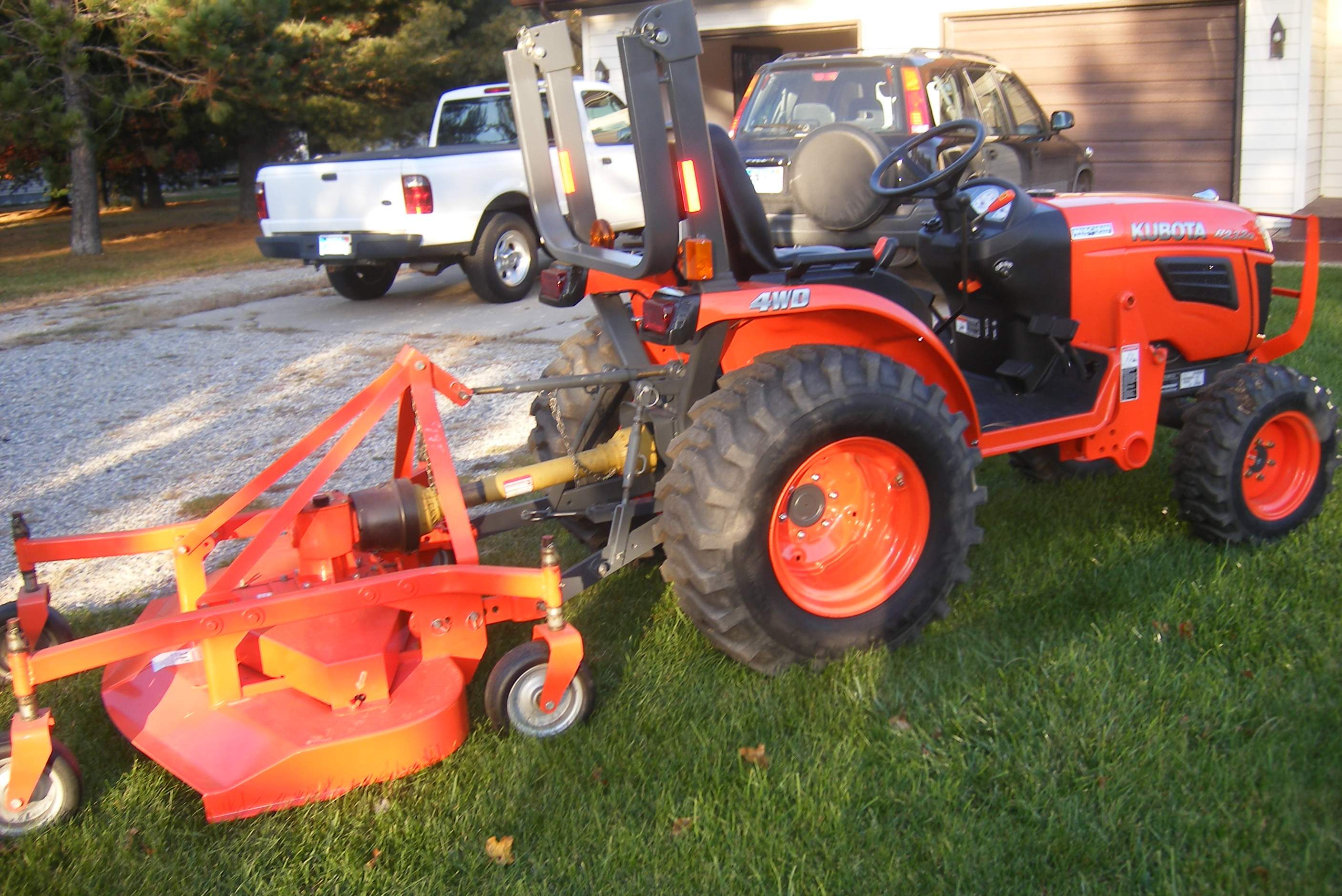

The RFM- My concern in using the mower was the drive shaft of the PTO. Obviously, I had cut it to fit the BX. Yesterday, I mounted it for the first time on the new tractor. Mounting was far easier as there is just more room to manipulate the lower arms and more room to slide the coupling on the PTO stub. The size and geometry of the 3 pt hitch is simply easier to operate than it was on the BX.
The drive shaft extended only an inch or two farther. This was a relief. Good drive shafts aren't cheap and I was delighted that it fit so well. As you can see in the photo, the shaft fits very well. The B2320 requires the shaft to be approximately 2" longer. Well within the extension the shaft had to give.
I could have easily extended another 2", if need be, but it was not required.

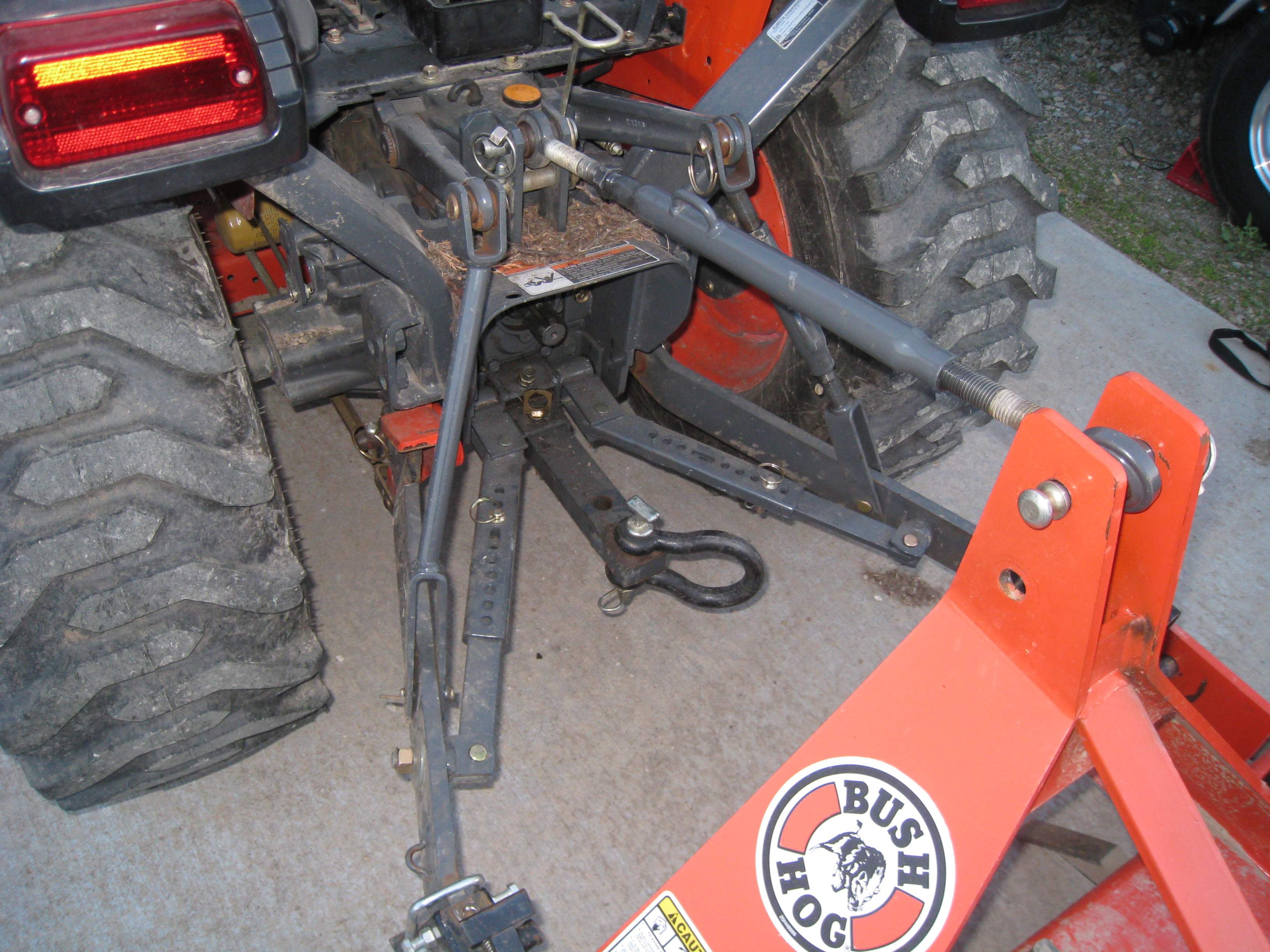

The telescopic stabilizers used on the Bxx30's help on the B2x20's quite a bit. I hated the way the stabilizers sagged in when there was not attachment on. I have the Pats quick system, but always had to have the spreader bar with me to keep them to the right distance for hooking up. But even without the quick system, the telescopic stabilizers make it easier to line up and back up to the implement, easier to hook it up with no adjusting of the turnbuckles and also better if you use the drawbar to pull a trailer as they won't hit the toung when turning. There is a slotted hole in them that allows for some movement of the implement if you want it which I do when using the rotary mower.

I really like those improved keeps. I have priced them and they're on the pricey side, but seem well worth the convenience.
As for the fenced gardens, it is mere netting. The posts lift out easily and when I am doing my pre-planting work, and post harvest ground work, the fence is not in the way, 'cause it isn't there.
Still, the FEL is so easy to take on/off, I never both with it, unless I am actually going to do FEL related work.
   / Bx1860 vx B2320 - Contrast/Compare #20
I agree with the ease of taking it off. I aways remove mine when mowing around the house with the MMM. But I keep it on when using the rotary mower on our other property or using the box blade as front balast.
For some reason when I attached the link to tractor smart, it attached the home page instead of the page that shows them. With shipping they were $200 which was less than the price I got from my dealer getting them a part at time. I agree that is more than I was anxious to spend, but I sure do like them. I had also bent a couple of the turnbuckle bolts and at $20+ each, decided to just suck it up and get the kit.
