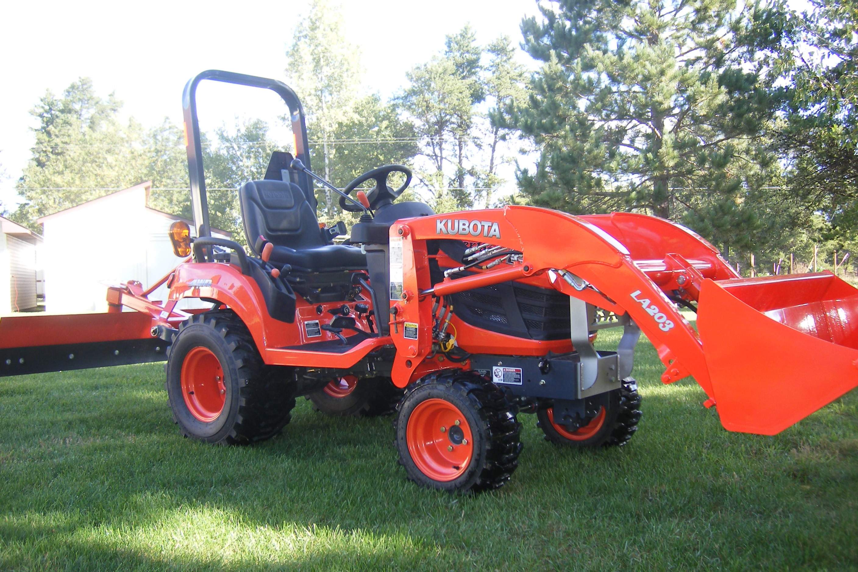

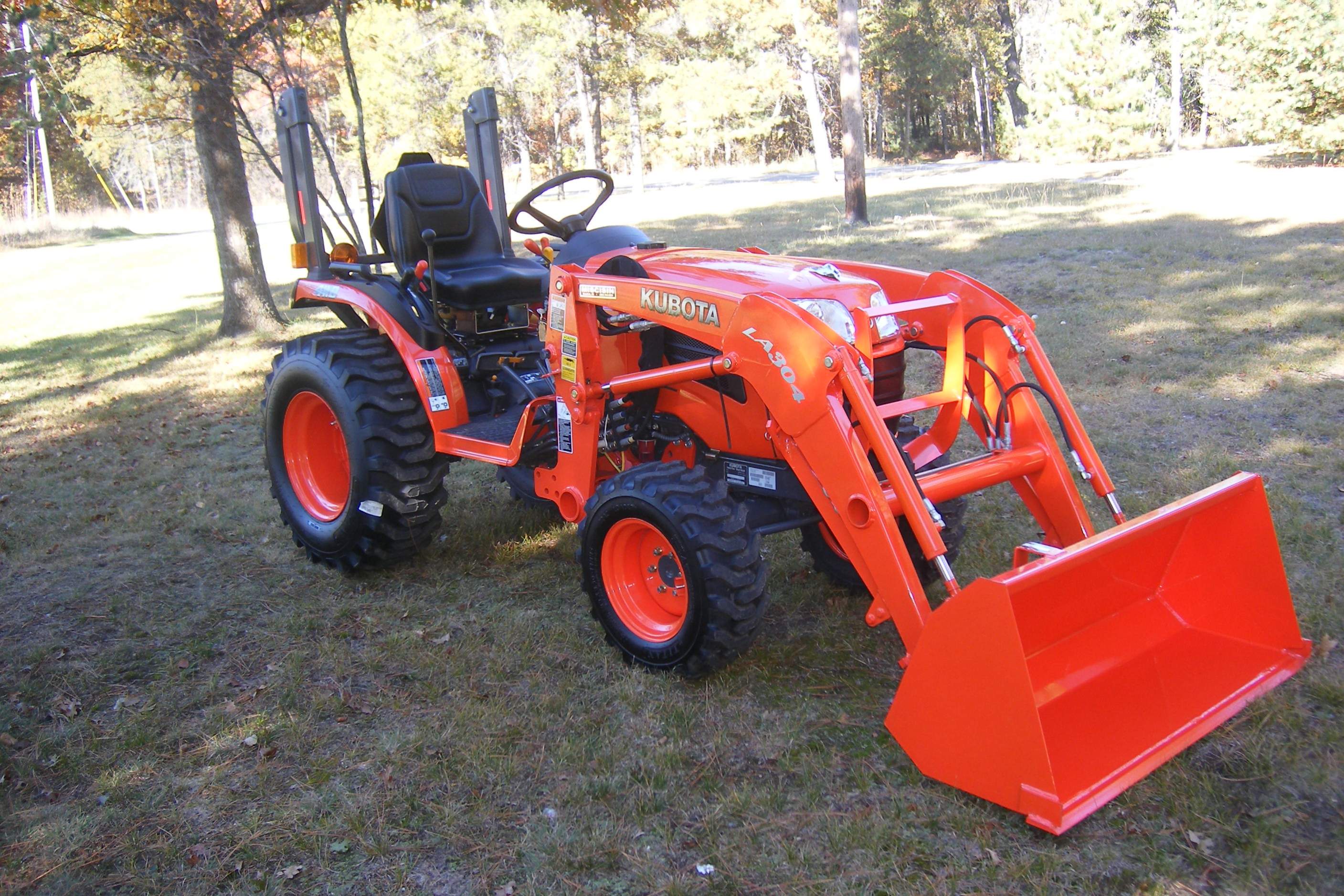

I recently sold my BX1860 and purchased a new B2320. Encouraged by some of the guys, I am going to "log", over some time, my sense of the differences, similarities and how these two machines compare and contrast, doing the chores, I do. This is important. The chores will be my chores, YMMV. But since I will use the same implements, 5' back blade, middle buster, 48" RFM, field cultivator, etc. all on the same property, the comparison will be honest as I can make it.
My hope is to make it interesting reading, if you like tractors and Kubotas in particular. It might be helpful information for those considering either a 20 series B or a BX, or someone considering moving from one to the other.

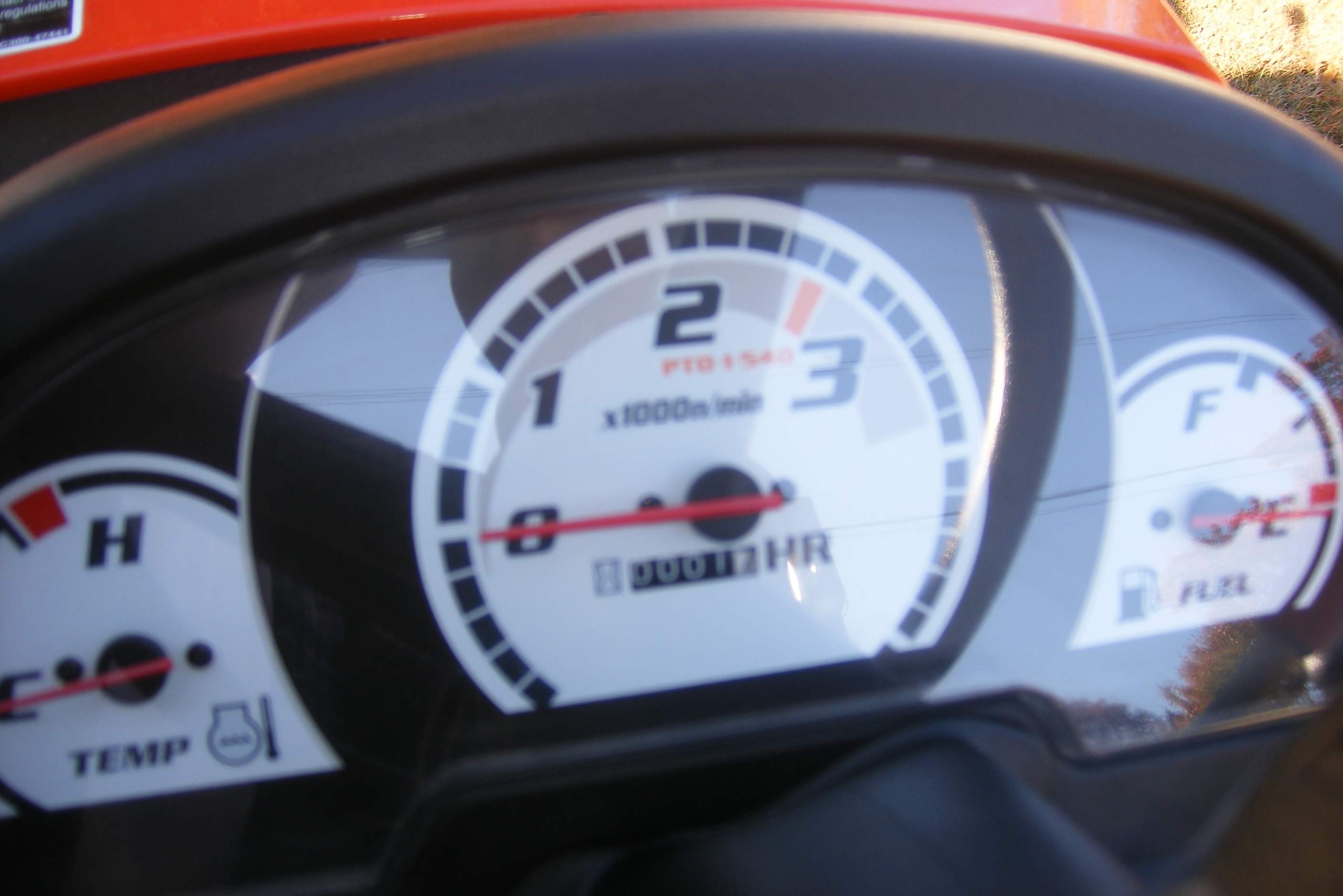

- The dash. There's no comparison. The big, beautiful, white faced analog dials are a joy to the eyes. Won't miss the dark, digital read-outs of the BX.

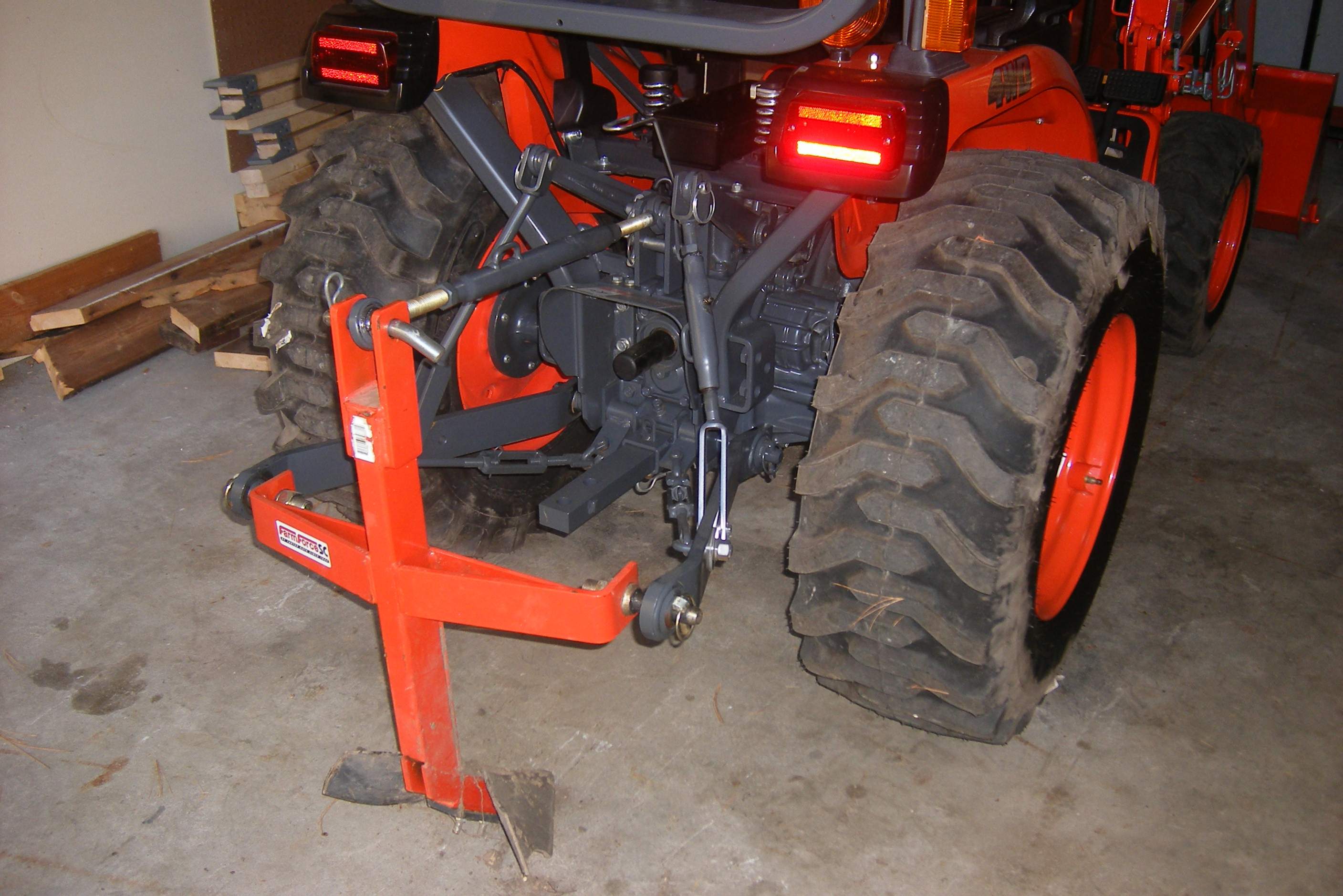

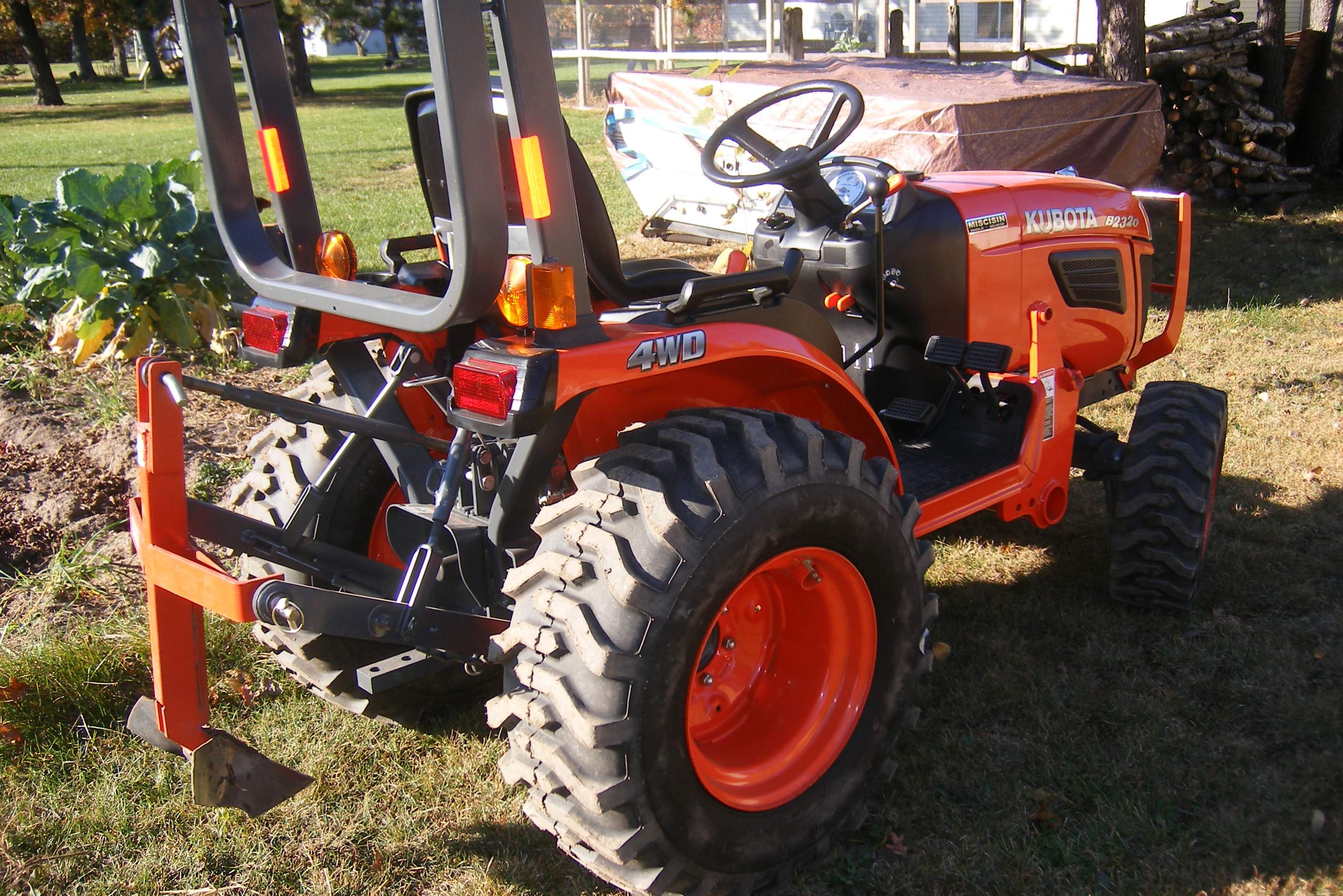

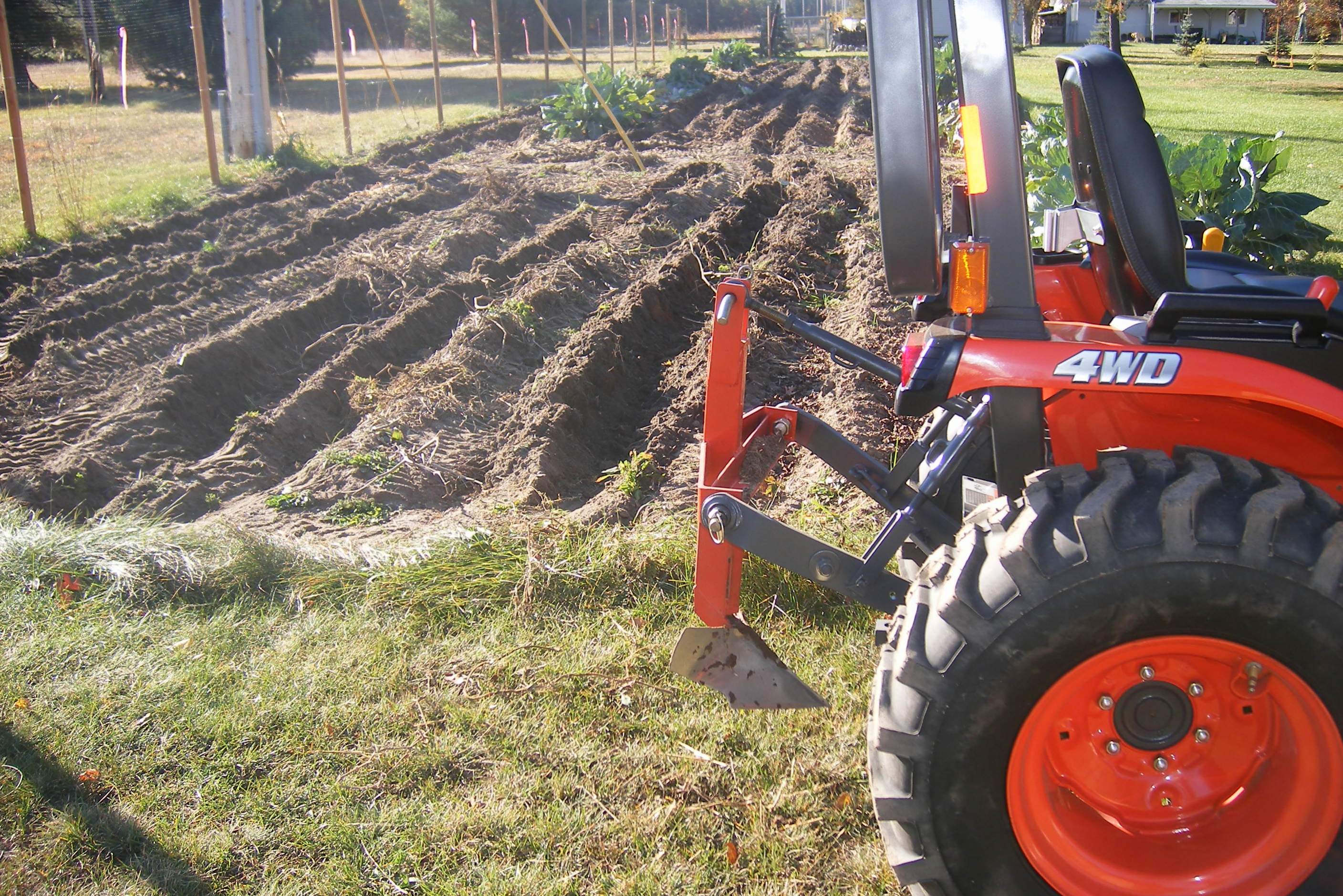

First Impressions In The Dirt
I don't go into my gardens, or mow my grass for that matter, with the FEL on. Taking the loader off the B2320 was uneventful, no different than the BX1860, although the Bxx20 series does use two legs for the FEL stand instead of the one piece unit on the BX. Frankly, the one piece BX unit is a better design.
Put on the middle buster plow. All the 3 pt hardware is familiar, if up-sized in scale considerably over the BX. I pondered using the second set of lower arm holes, allowing the plow to go deeper, but decided to leave it alone and as it turned out, going deep was not an issue. Yes, my plow is an XB size from the BX, but it worked well and after having used it, see no reason to change whatsoever.
I plowed as deep as I ever did before.
Now, things I learned. The 1/4 valving has been a source of much talk here on TBN lately and I can say is my B2320 came adjusted perfectly. Outstanding!!! Works within a whisker of being position control. Thrilled.
The B simply never broke a sweat. It has ridiculous amounts of torque that is delivered with a deep engine sound and, to ears grown accustomed to BX HST whine, it seemed virtually as pleasant as a gear tractor. Honestly. Spooky. More later on all that low RPM torque.
The turning radius was fine, but not the agility of the BX. That was to be expected. One sacrifices that for the larger, taller frame. Speaking of taller, the ground clearance is absurd. Even with the wheels deep in the previous furrow, it stands above it all. This was the primary reason for the change from BX to B and it was positively worthwhile. I pounded the bottom of my BX too many times to count.
Now, the torque. It is simply insane in proportion to the weight of the tractor. What it wants to do is far beyond its traction ability. This thing is likely to be fitted with some suitcase weights for the front end. The front "feels" so much lighter. In some ways, the entire tractor "feels" lighter. If this were a field work only tractor, it would benefit greatly from Ag tires as well, but it is not, so there won't be any forthcoming.
I'll need more time for thought about adding weight. Since I mow grass, I am concerned about filled rear tires, but this machine would absolutely benefit from having them done. I would have to use a certified, enviro-safe product, since our place is organic. More pondering.

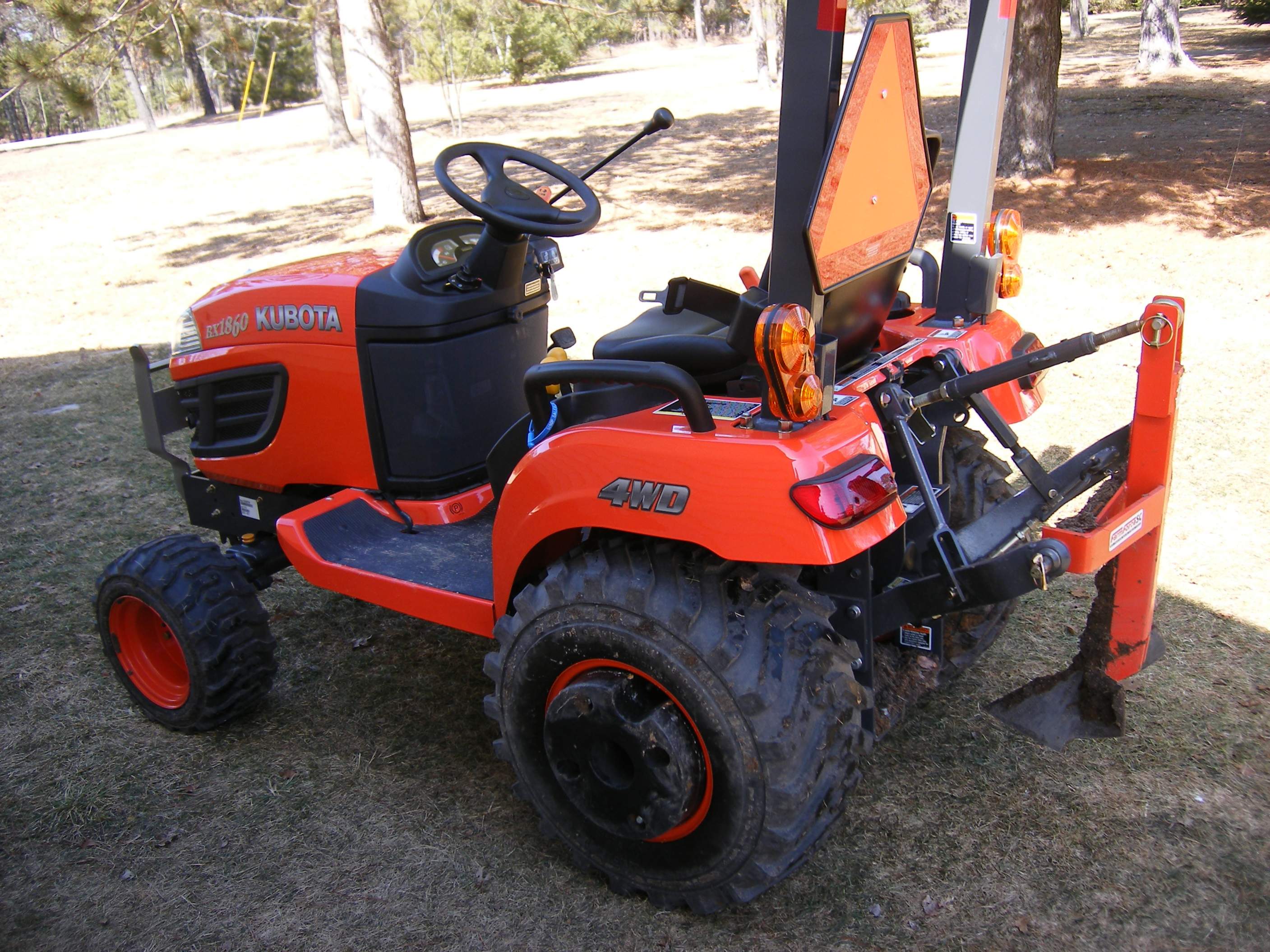

My BX1860 was fitted with wheel weights, when I plowed snow. I also used them when I plowed dirt. I didn't use them for digging the potatoes, but I struggled through without putting them on. It was early August, and too soon to mount them.
Without loaded rear tires or wheel weights, the B2320 does not have all the traction it needs. The basic "curb" weight of the B2320 is listed at 1477 lbs. That is only 200 lbs heavier than my little BX and only 100 lbs heavier than the largest BX, the 2660. For it's overall size, this B is light.
I'm about done plowing for the year, but snow is coming. With those wheel weights, the BX did fine in the snow. I have my doubts about this new B2320, as it sits right now. I have a month or two to sort this out.

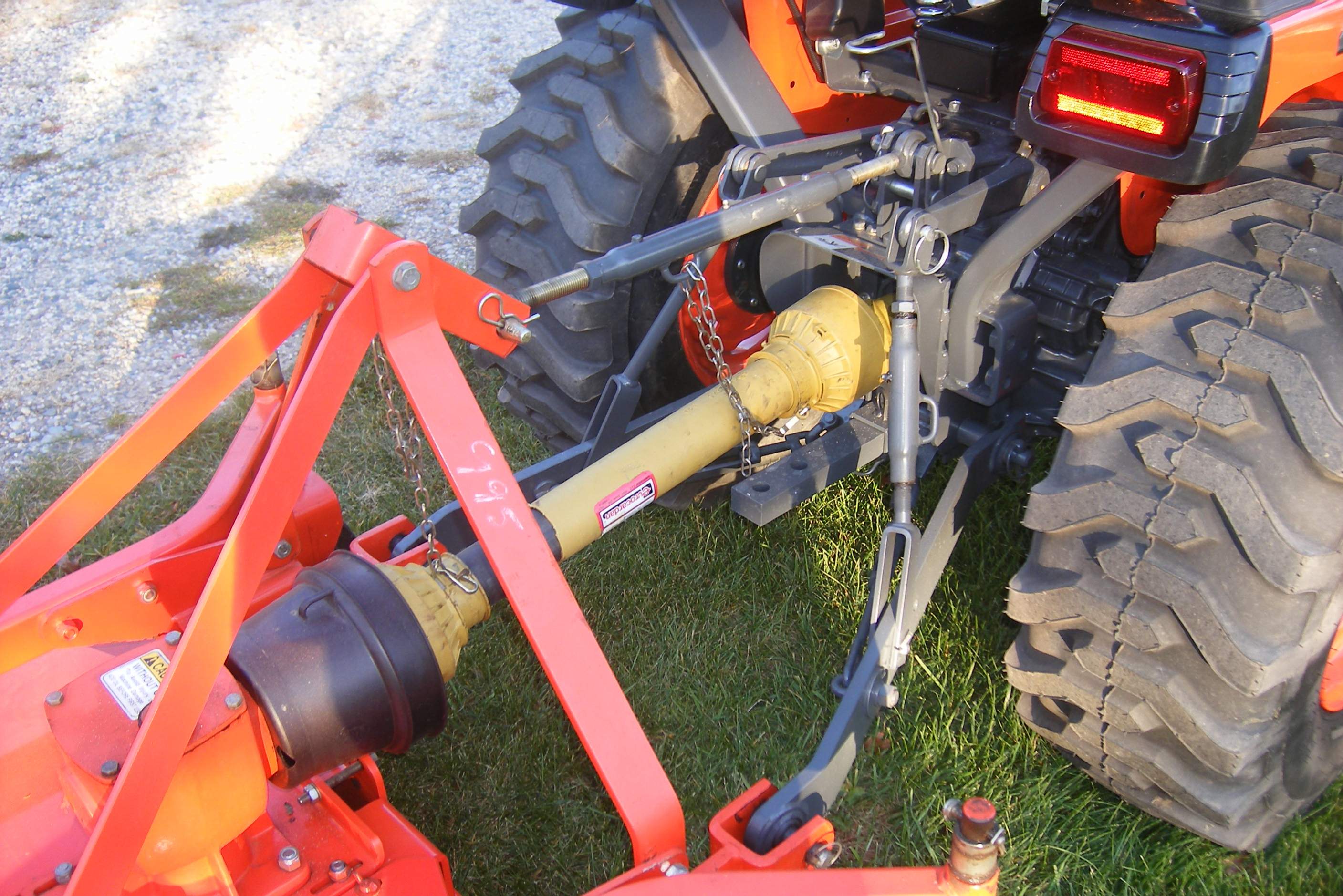

Implements Following A Tractor Change​
When migrating to the B2320 from the BX1860, I preferred not to sell everything off, as a bundle package. Everyone's needs are different and my basic implements are:
Front End Loader- Obviously, each tractor has its own.
Middle Buster/Potato Plow which not only plows my gardens, but digs potatoes and is useful for laying a ditch or trench.
Single Row-Field Cultivator- which I use not only to cultivate growing plants, but by moving the tines, it makes a dandy spring tooth drag.
5' Rear Blade- mostly for clearing snow, but occasionally used for leveling sand/dirt.

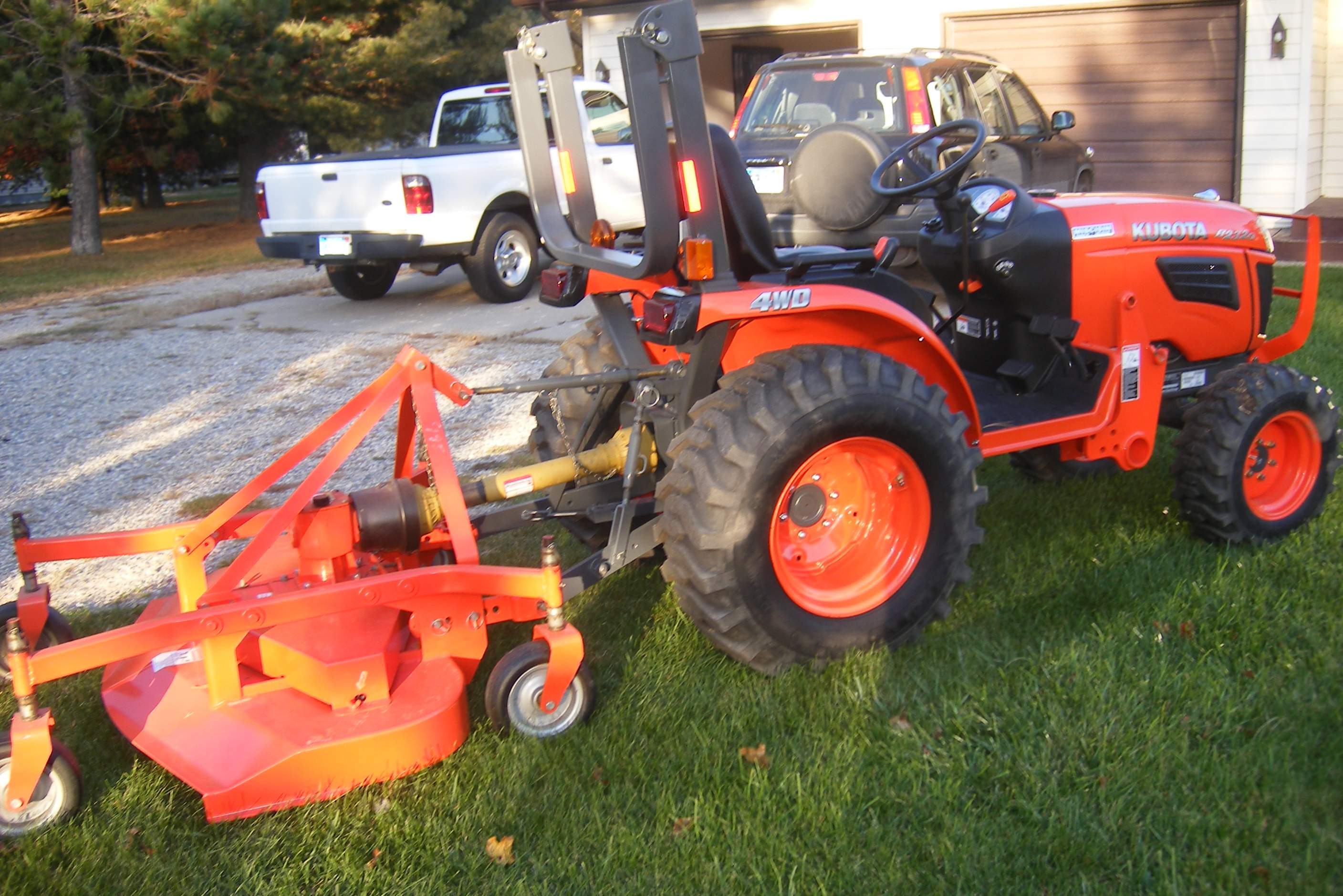

4' Rear Finish Mower- used weekly for mowing over an acre of grass.
I have about $1800 invested in these implements and my expectation was that, while they were purchased for and used on the BX, they would move forward to be used on the larger framed B as well.
The RFM- My concern in using the mower was the drive shaft of the PTO. Obviously, I had cut it to fit the BX. Yesterday, I mounted it for the first time on the new tractor. Mounting was far easier as there is just more room to manipulate the lower arms and more room to slide the coupling on the PTO stub. The size and geometry of the 3 pt hitch is simply easier to operate than it was on the BX.
The drive shaft extended only an inch or two farther. This was a relief. Good drive shafts aren't cheap and I was delighted that it fit so well. As you can see in the photo, the shaft fits very well. The B2320 requires the shaft to be approximately 2" longer. Well within the extension the shaft had to give.
I could have easily extended another 2", if need be, but it was not required.
